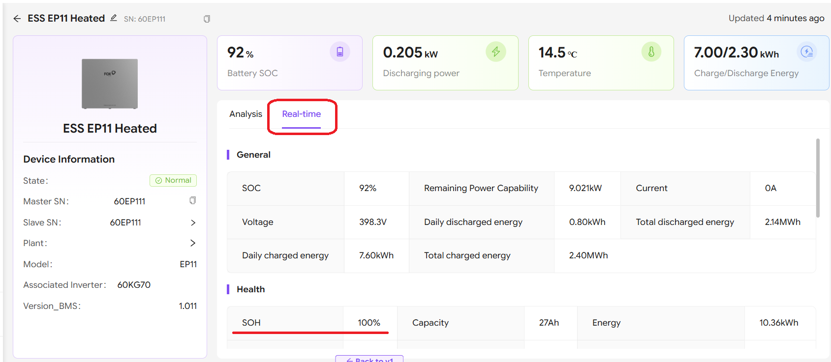

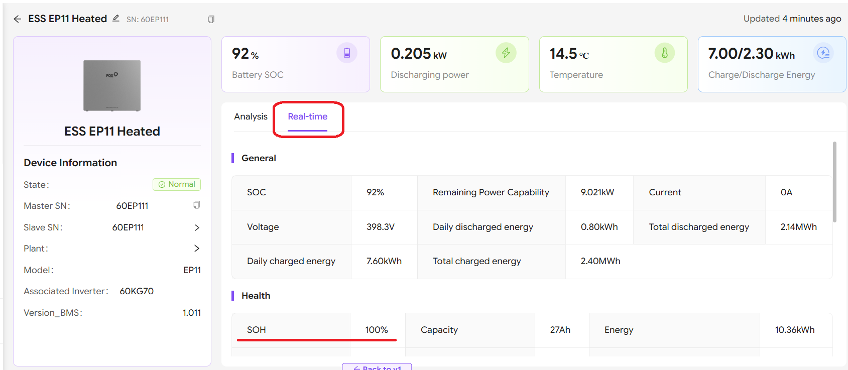

It does take time to connect the dots up with any new system, like a jigsaw, the pieces will all in time, fall into place.
As for SoH on the desktop (also known as Fox Cloud v2 website to me) it is tucked away.
v2 landing page https://www.foxesscloud.com/v2/login then click on Devices, and select your battery, and then select the "real-time" as shown here.

You are welcome, hopefully you have now found the SoH value in Fox Cloud website v2.
