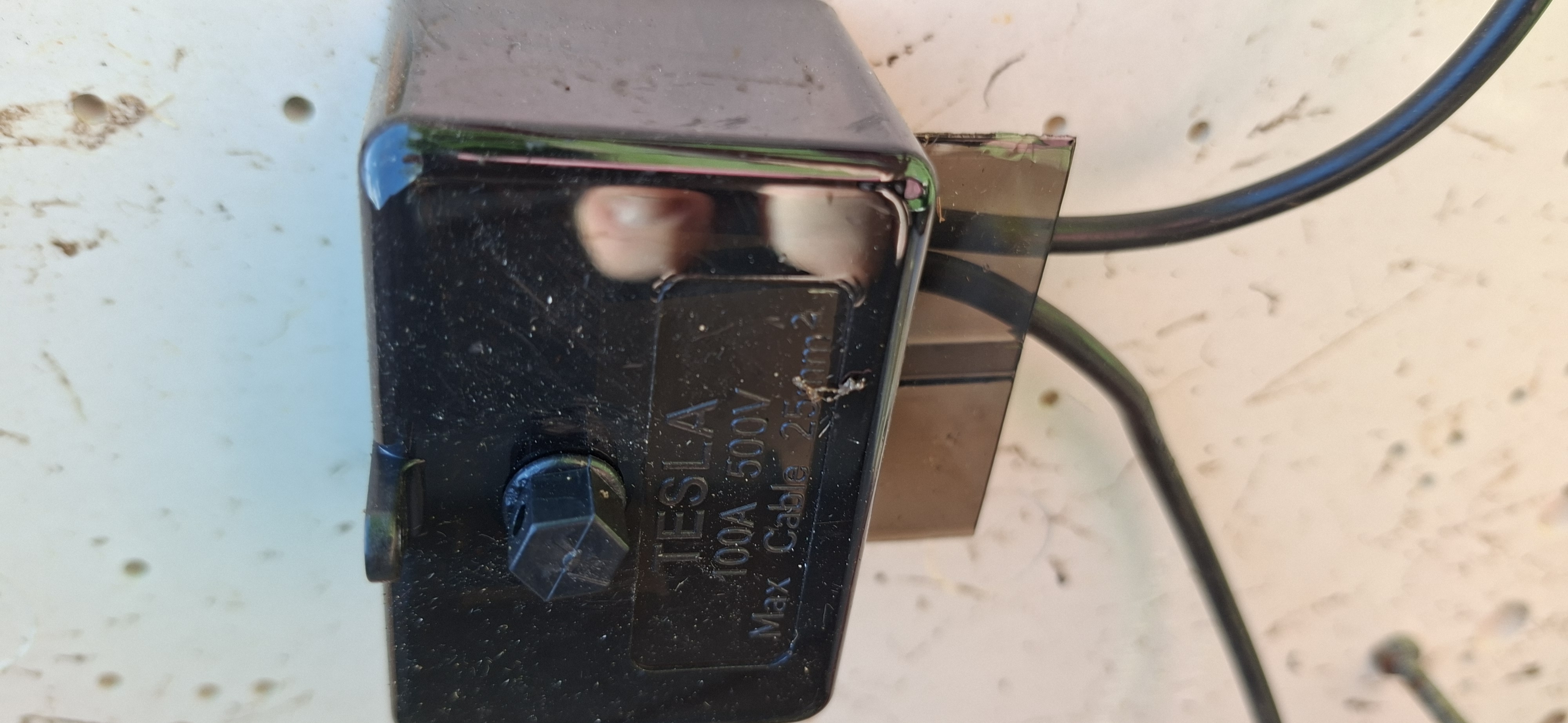

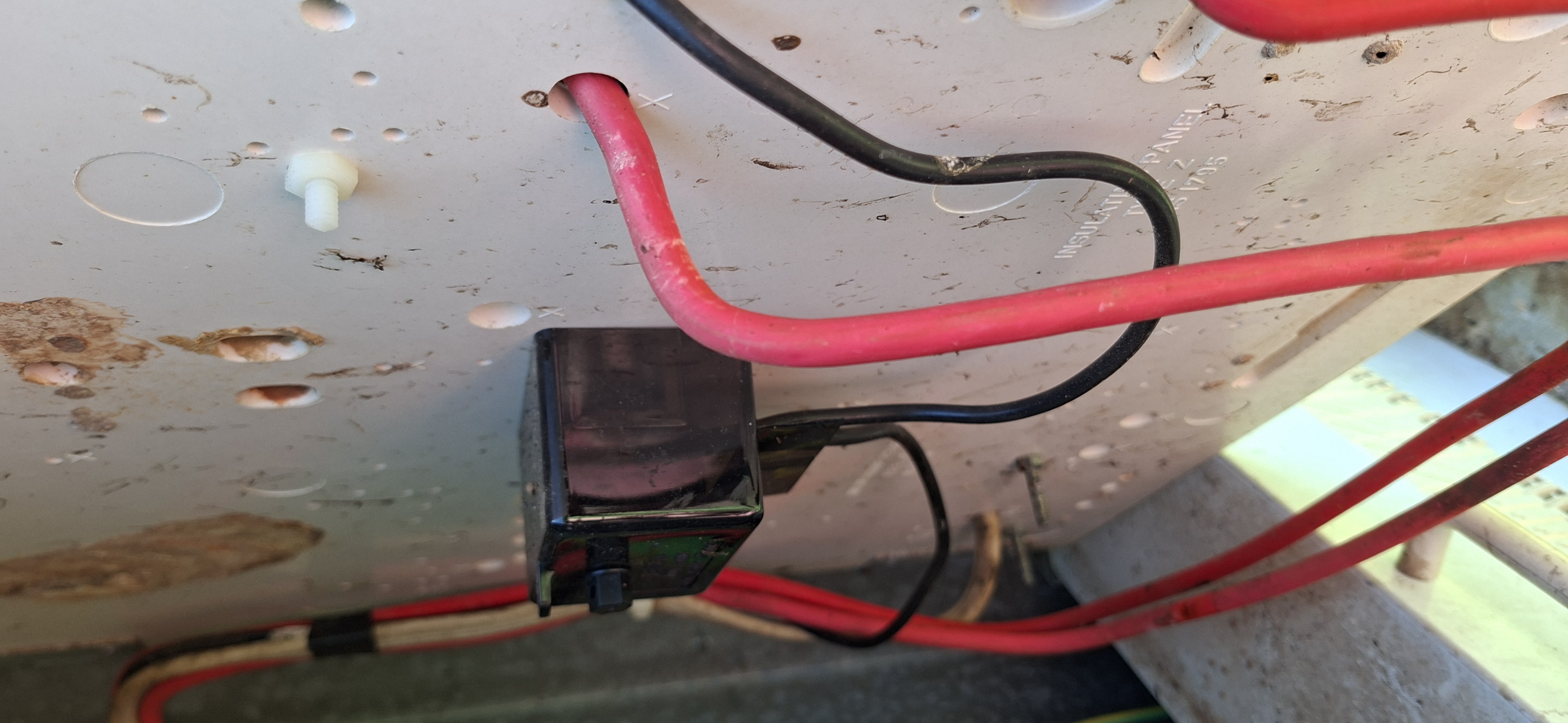

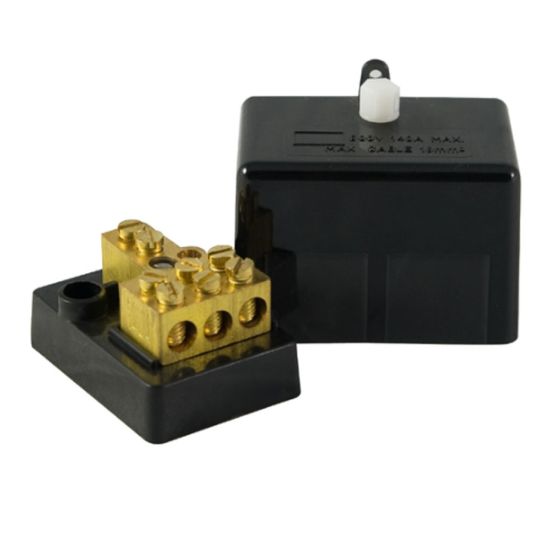

I did find a Tesla 500amp thing. Not sure if it is a CT Clamp though.
Installer of the batteries is returning soon, as he forgot to install the Blackout Protection. So will ask him about it. But PV installer would have done it i assume.

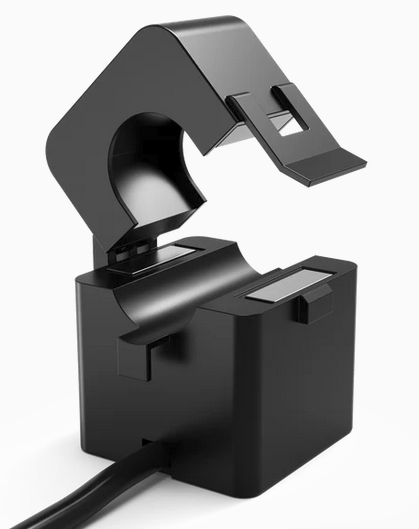

Here is a pic of a CT clamp, I don't know what that Tesla thing is.

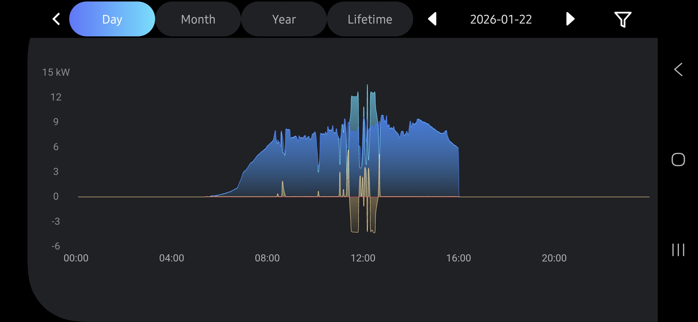

I was wondering the other day, if your EV is the mystery 6kW load you see the other that drained your battery. It could explain why you barely see any load, then your system finally sees a load.
If you have a few power graphs from your Fox Cloud 2.0 App that could show where the power goes. See if you can get the one from the day you was seeing the 6kW drain with no AC on/small house load.

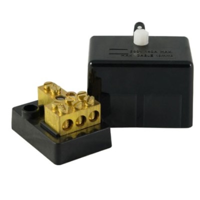

Ah that mystery black Tesla box is the same as a Henley block used in the UK
Re: Identifying factor for PV and Battery use
MaterialBarracuda48 wrote: ↑Thu Jan 29, 2026 10:14 am Ah that mystery black Tesla box is the same as a Henley block used in the UK
So it ISN'T a CT Clamp.
Looks like it is an electrical splitter.
CoreyTroy wrote: ↑Thu Jan 29, 2026 10:19 am So it ISN'T a CT Clamp?
Correct, it is a way of connecting power is all, no measurement capability.

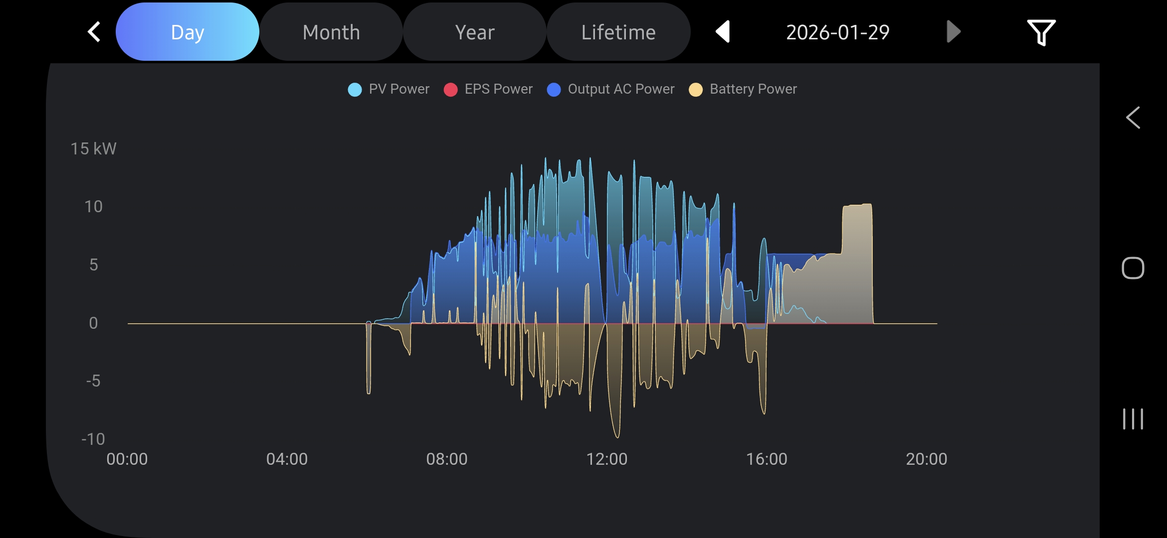

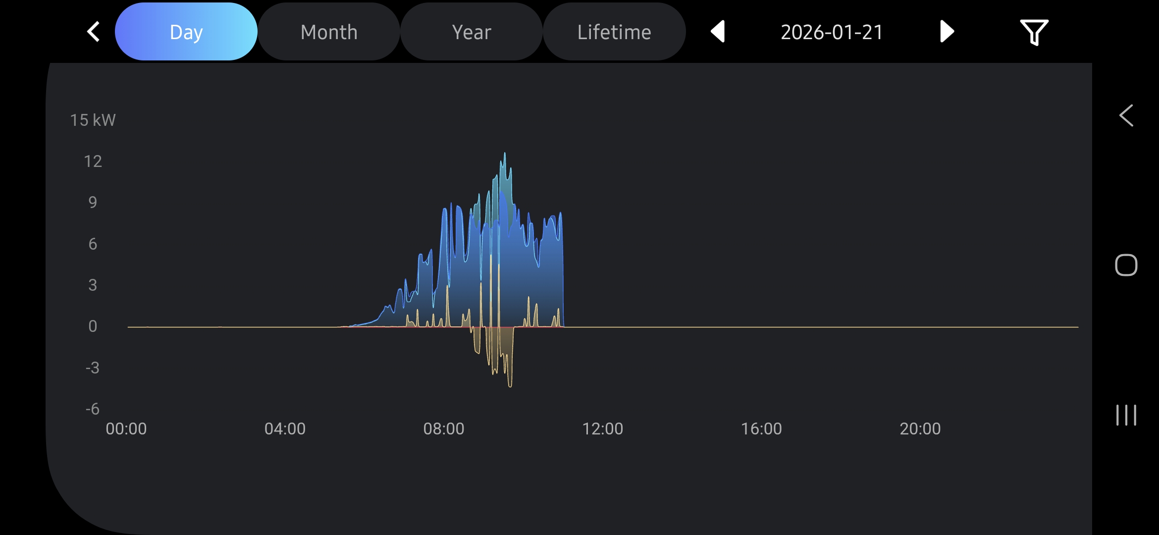

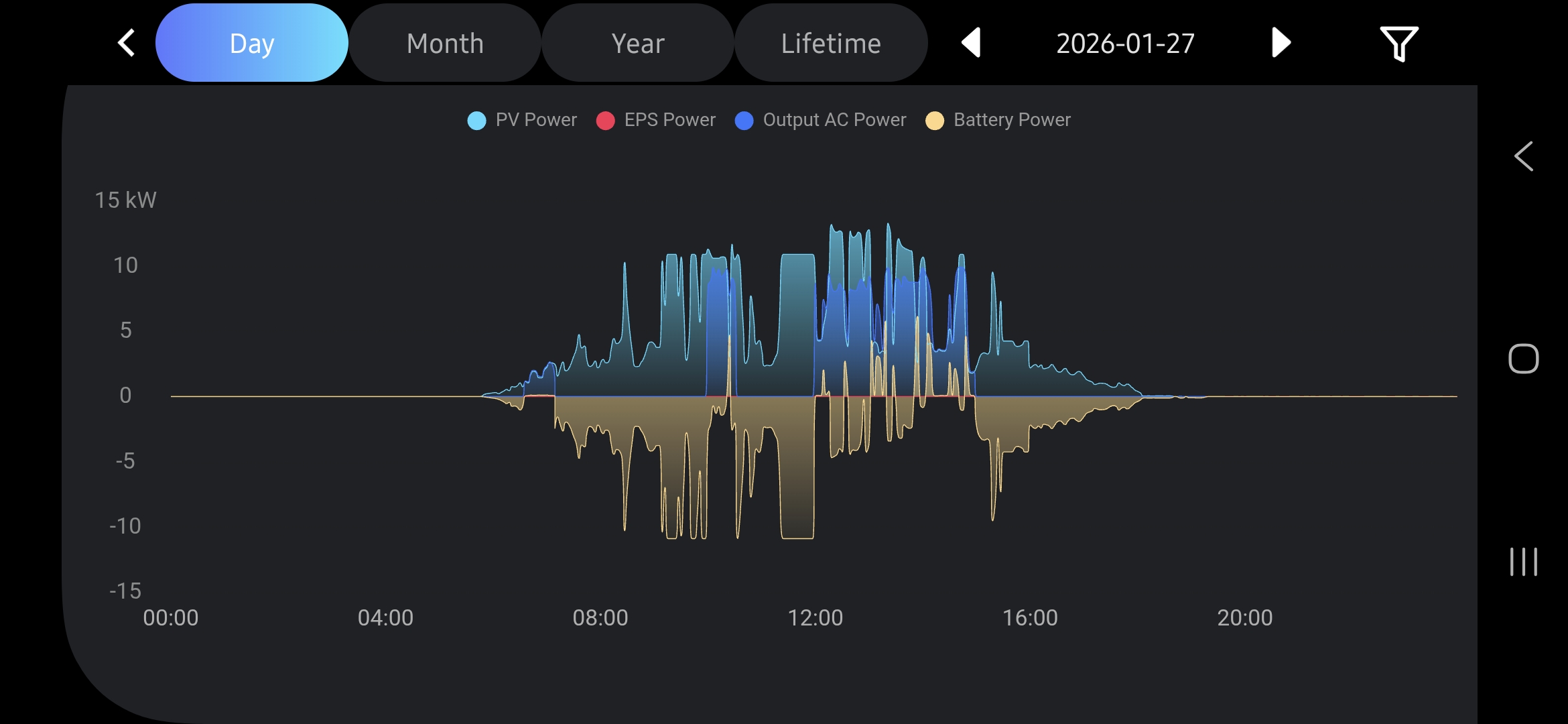

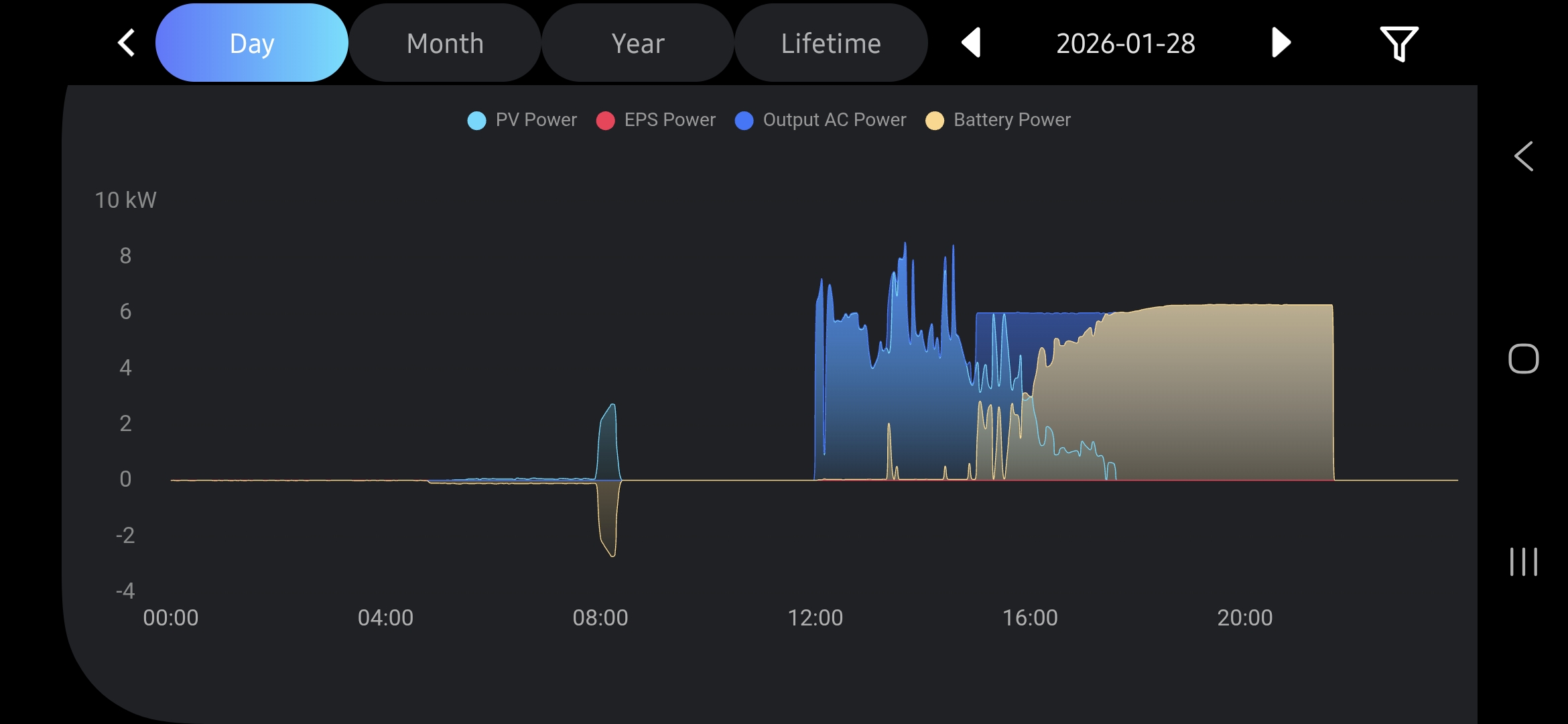

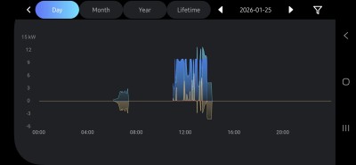

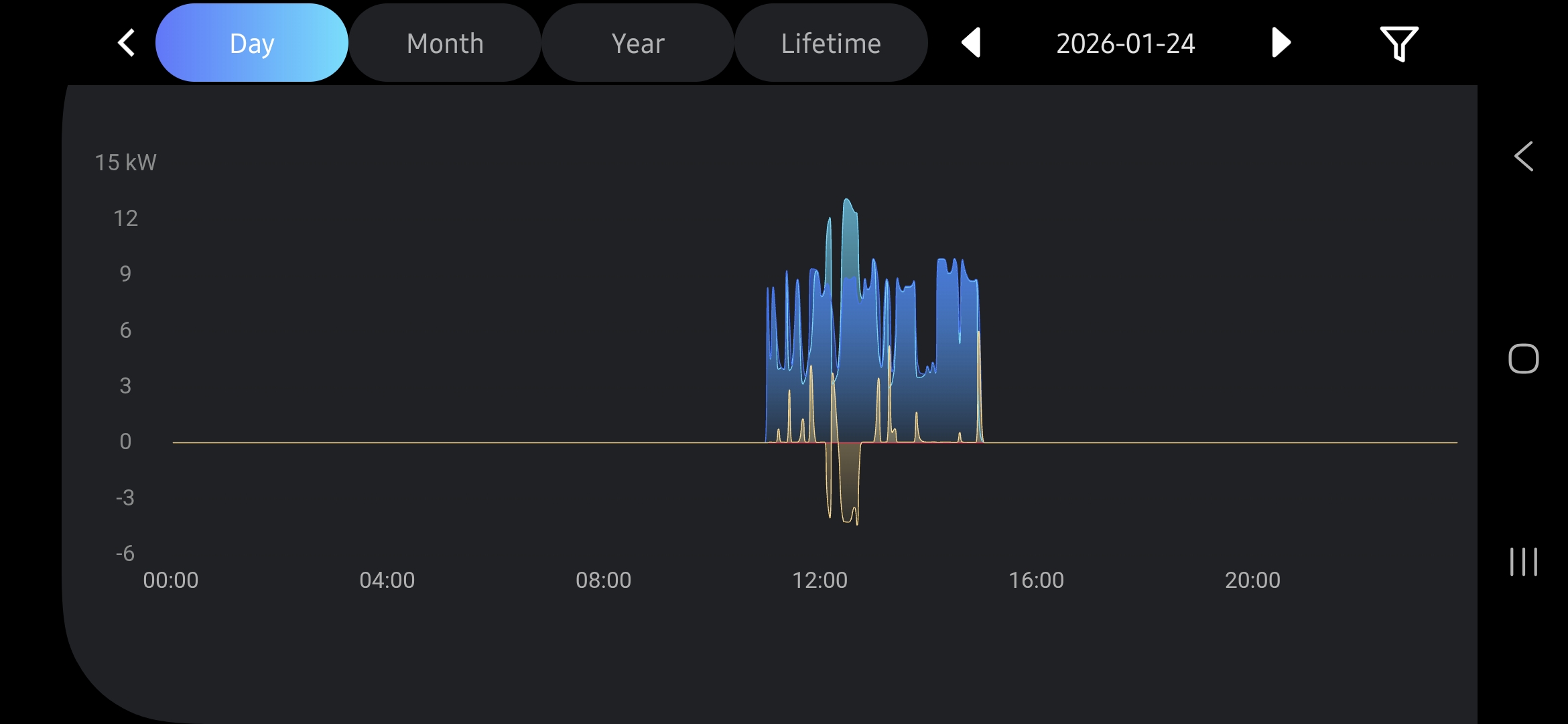

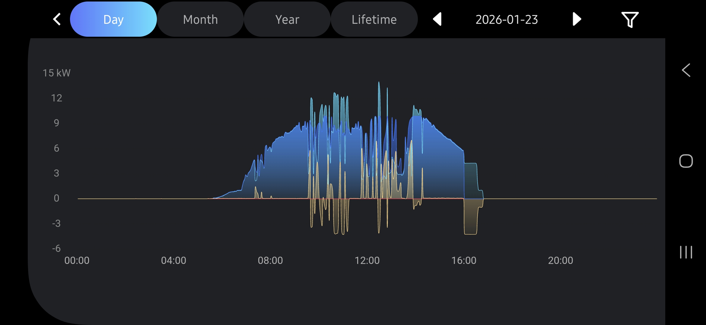

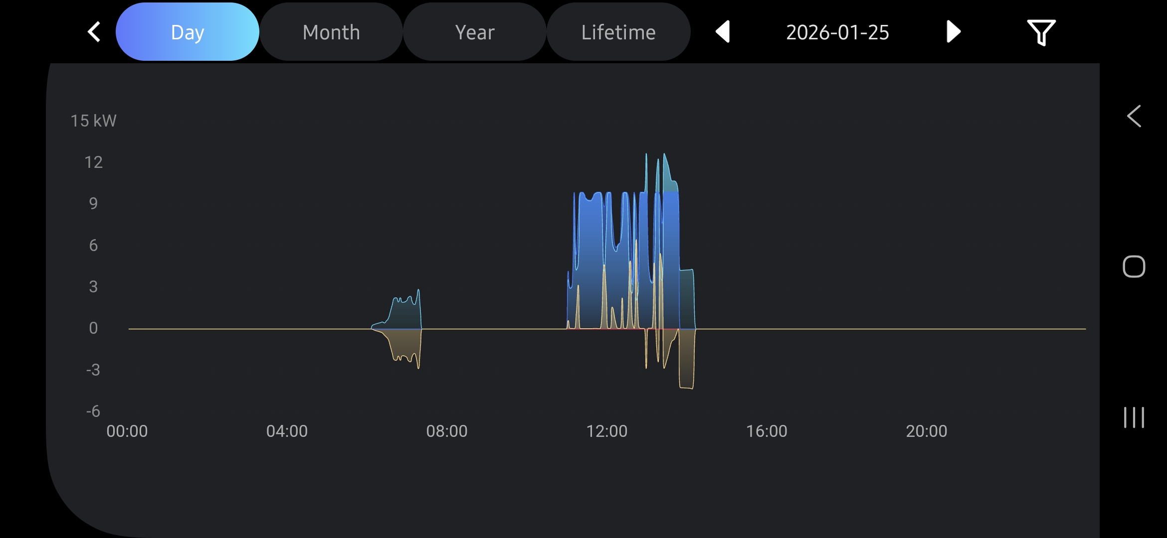

Hopefully the graphs divulge any issues.
Last few show the battery finally being used after I reboot the system.

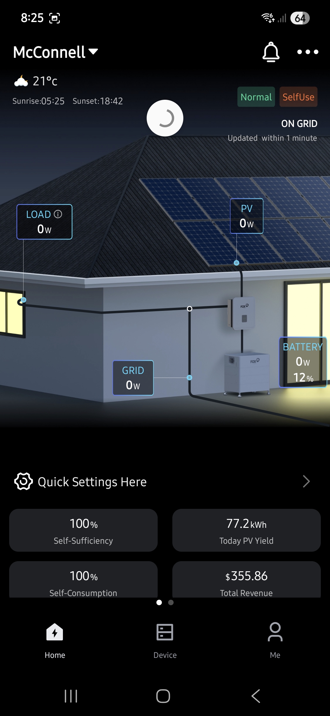

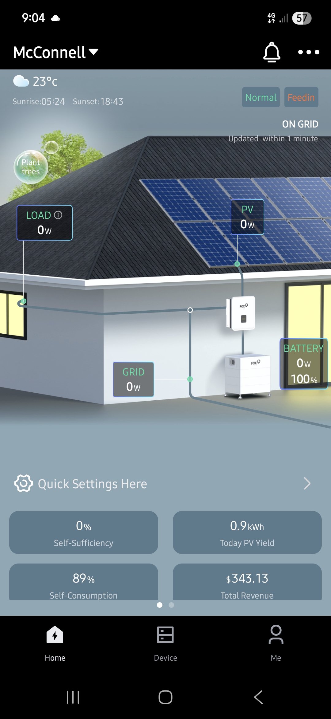

Sitting down with TV on, a couple of fans going.
3 x fridges running
Some PC.
Yet data displays zero now.
Current load screenshot
CoreyTroy wrote: ↑Thu Jan 29, 2026 10:26 am Sitting down with TV on, a couple of fans going.
3 x fridges running
Some PC.

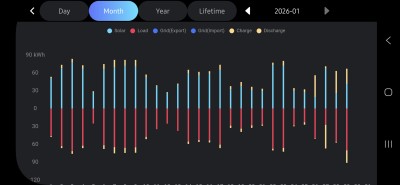

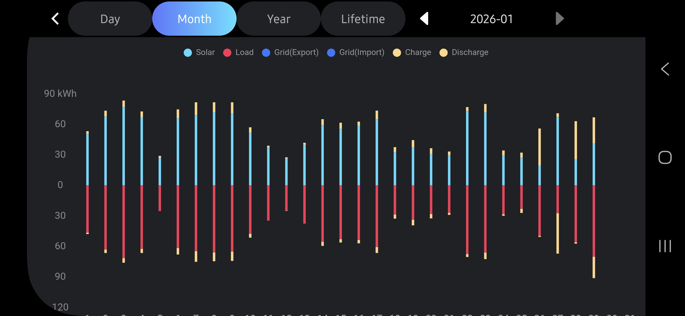

It does make you wonder if your CT clamp is working fine, as you do not have a warning bell icon in red. The above picture shows a meaty 77kWh of PV produced today, but all your values are zero. Your monthly graph does show PV/Load etc... or at least what it thinks it is measuring.
Maybe that CT clamp is placed around the wrong cable, maybe moved or too close to another CT clamp?

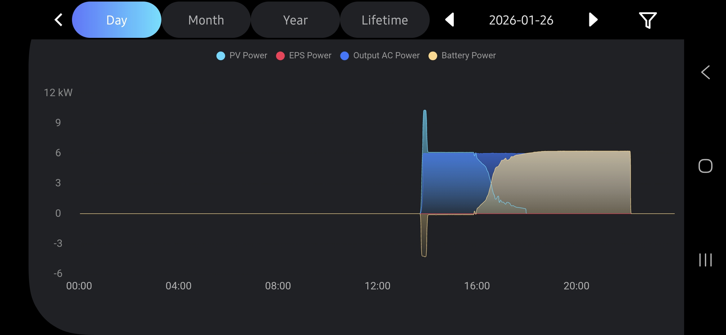

Rather than the graphs you’ve posted (which don’t show house load), can you post the graph you see when you swipe left off the home screen (scroll down), that one shows Load, Grid, Battery & Solar and it’s much easier to see how the load affects the inverter.
