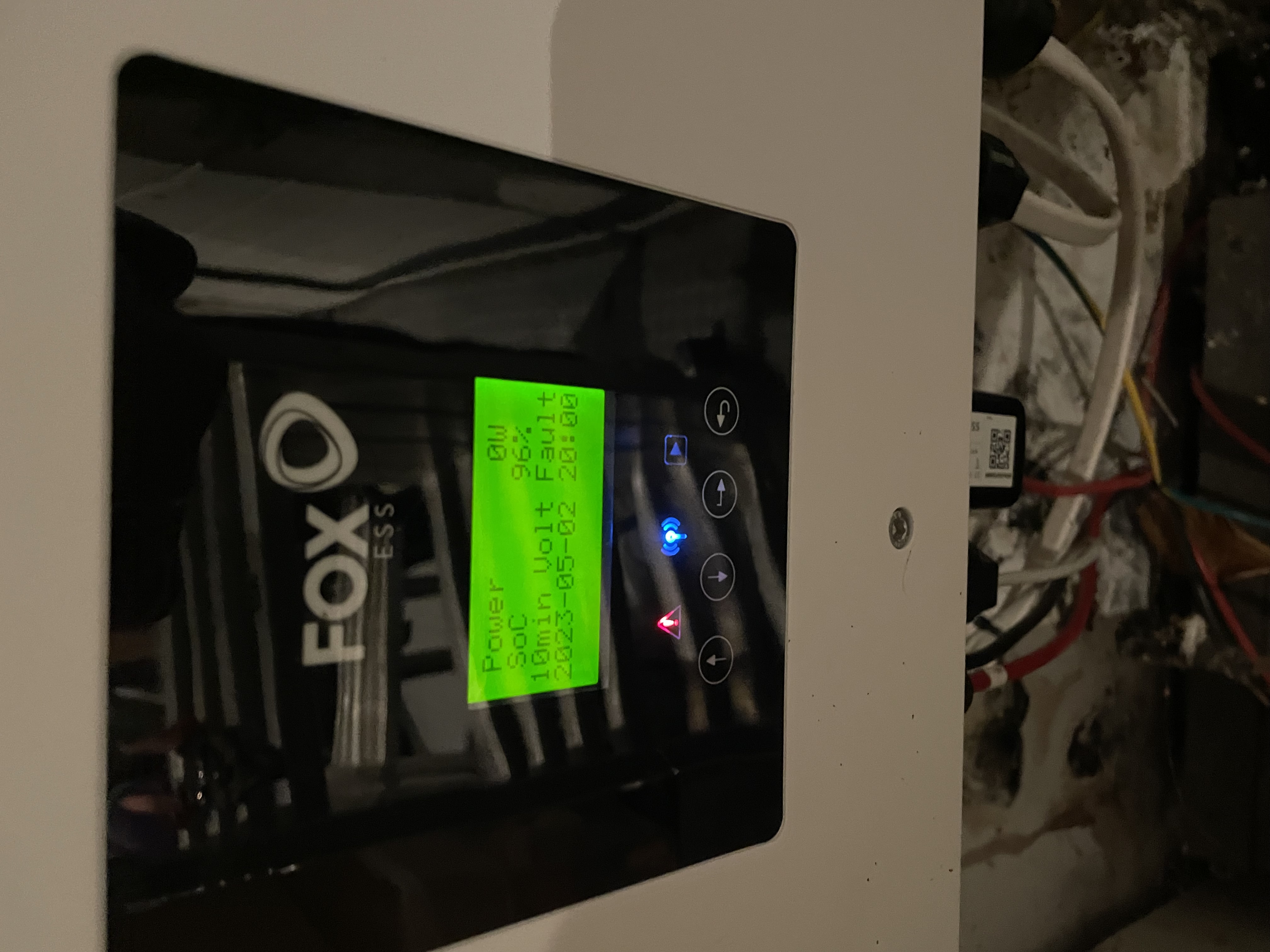

Hi folks.
I have a FoxEss ME 3000SP AC Coupled Inverter with 2 HV2600 batteries.
For a fortnight now, after a network (wifi) outage, I have started receiving the error message “10min volt fault”. The battery shows a decent charge but the house runs from the grid. Sometimes it resets itself after a while but sometimes it stays offline for a long time.
I have done a couple full shutdown and restarts and it starts working but only to stop after sometime again with the error message. Any ideas which tree I should go bark at?
Many thanks.

It seems it's the same fault as the average grid voltage. I got more details by logging on to the foxess cloud via desktop. The app and inverter display didn't divulge much information. I will now close this topic.
