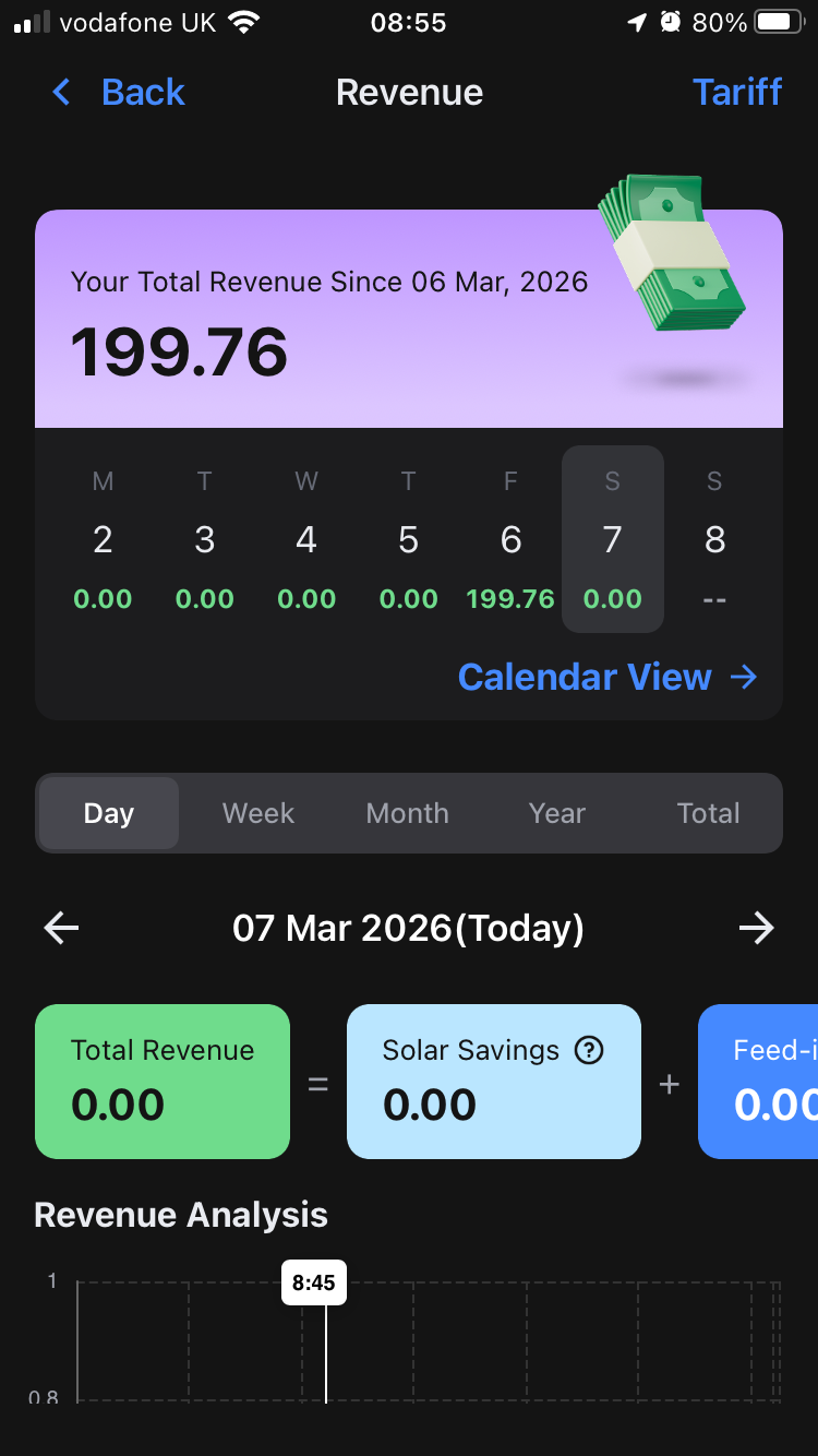

I followed iameccles instructions that he posted on youtube and thought, after many fumbles and re-attempts, to get it setup and given the <unmentionable> state of yesterdays weather was not surprised then to see no indication of any revenue.
And then today I go to the app and see that I have acquired the stupendous sum of €199.76. That's wrong, I thought and changed the currency to GBP (£), but now its £199.76 ! Now, I have no great faith in currency exchanges but for both the £ and the € to be exactly the same strikes me as very odd, regardless of where the 199.76 came from? And this is shown as appearing on the 6th with nothing on the 7th.
So my questions are: Is this a bug? or, more likely, what did I do wrong?

The symbol in this case has little meaning, or any bearing on conversion as there is none.
So could as easily be a radiation symbol etc.
What matters is the rates you input to the system, and it calculates from there.
I suspect you input say 25p for your tariff rate, when you needed say 0.25.

I had set 24.96 for buy and 0.12 for sell.
Arithmetic is one of my strong suits.
Exciting times ahead.

I put the decimal in the wrong place and it now seems I have to live with that mistake because, so far, there does not seem to be any means available to correct the error.
I take that as a word to the wiser than I. Be very careful in how you set it up.

Hello Derrick, what you can do is drop the Import value down to 0.01 for a while until it catches up to reality, at least that should work after a few days/weeks/months!Sysiphus wrote: ↑Sat Mar 07, 2026 2:13 pm I put the decimal in the wrong place and it now seems I have to live with that mistake because, so far, there does not seem to be any means available to correct the error.
Best regards,
Derrick.
Once it matches what you have made, then you can set it back to correct normal value.

I have tried removing and deleting the old tariff and setting a new one but the value recorded by the old one is persistent and I haven't found a way to amend or delete it.
Perhaps I'll take up the sedentary sport known as watching paint dry (while I wait for reality to match with what the cloud app thinks it is) - it may soon be in the Olympics, you never know with these things.
