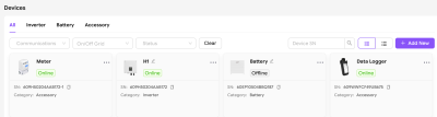

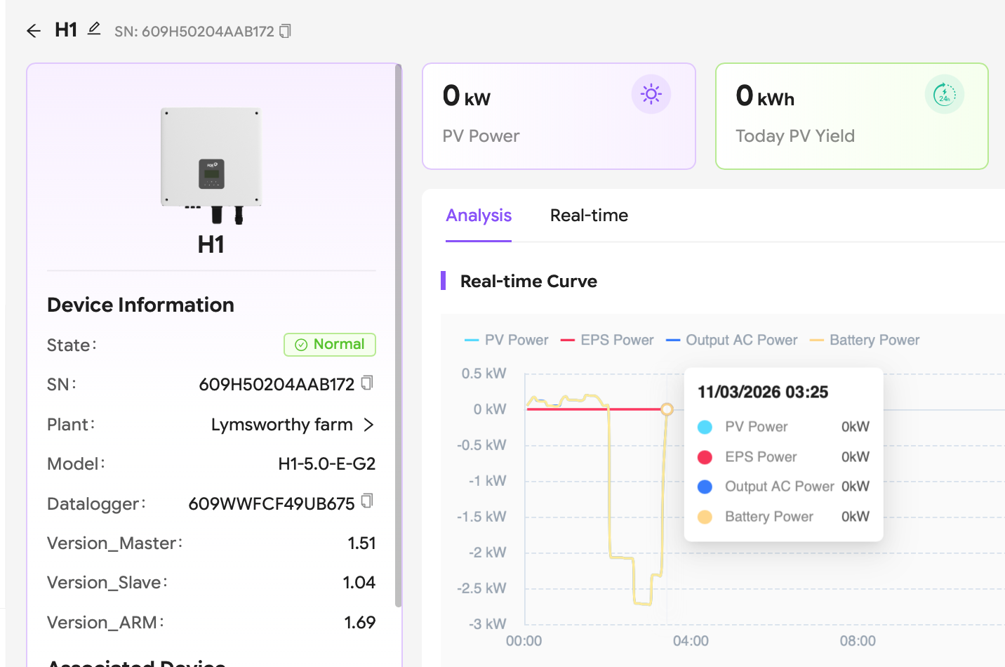

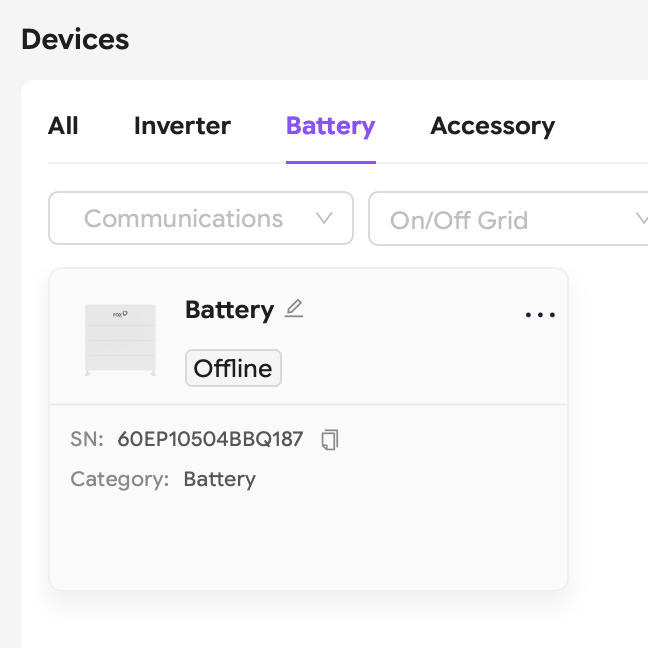

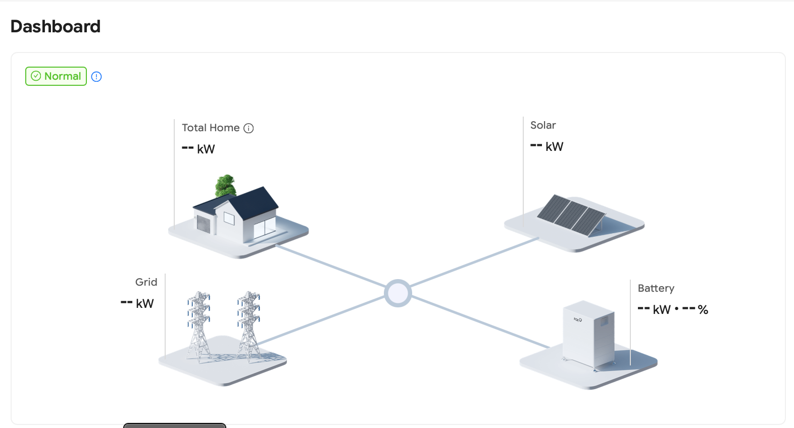

Hi, my battery is offline and the dashboard is showing no data.
I have tried reconnecting the wifi in the app which says successful but then still shows the device and not connected?
How do I fix this and will by battery still charge from my panels whilst it is offline?
Please advise

Mine also shows this. Could there be an outage? I'm not sure what parts of the system an outage would affect, as it's only my battery that's offline and I have the word 'Fault' in my battery device information.

not since 3:25am UK time

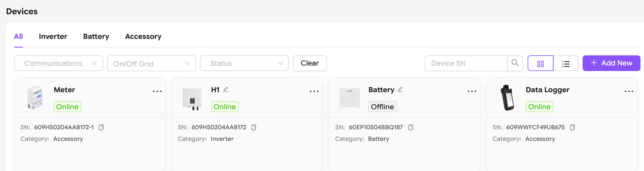

Re: Battery offline with no data
Well it was charging, until it went poof one way or another.
@GrahamE, do you have better access to your system, have you reset it?

Me too - Crowthorne, Berks. Battery allegedly offline, but Foxcloud says no PV either! i did notice a firmware upgrade for the data logger (2.00 -> 2.03) which appears to have failed (according to the app). Maybe thats related? Botched upgrade?
