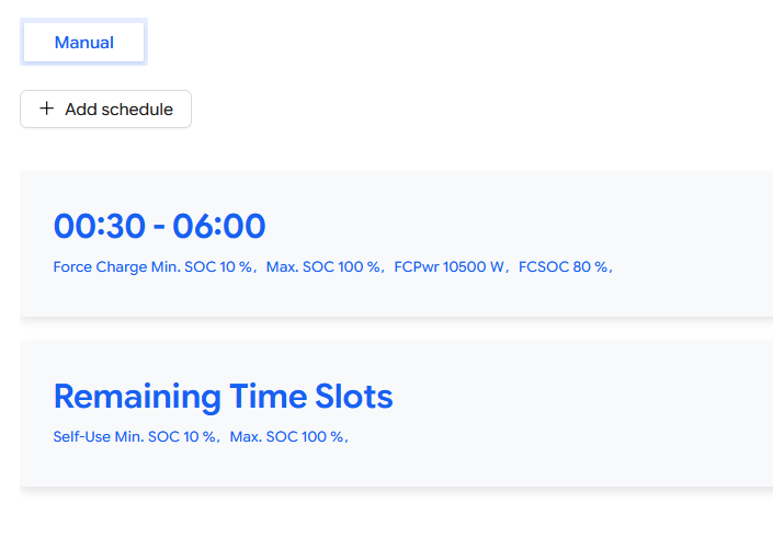

Last night I charged my battery up for the first time.
I use Mode scheduler and set:
00:30-07:30
Forced Charge
Charging cut-off SOC: 80%
Charging Power from Grid 10500.W (default)
Charging from Grid: enabled
(It is on self-use the rest of the time)
I can see that System MaxSOC is 100%
When I woke up, it had charged to 100% and not 80%.
I wanted to do this as I won't be able to sell to the grid for a month or so, so I wanted to allow for solar generation to go to the battery.
What am I doing wrong?

The 80% SoC value being ignored is nothing new, some firmware bugs exist, with regards to that behavior.

That setting only effects grid charging, but overnight the inverter should have been limited by that unless it mis-guessed the SoC from battery voltage or Fox made another change that broke things.
I just checked and there is 2 SoC settings when force charging, maxSoC and force charge cut off SoC.
We don't have enough panels for self sufficiency in winter either.
I managed to set a Force charge cut off using the web interface rather than the app. It allowed me to limit both Max SOC and FCSOC to 80% and this worked for me...until I used the app to make other changes and then it reverted to 100% Too many bugs in the mobile app at present.

So do you think that changing Max SOC. to 80% just in the 00:30 - 06:00 slot here will work as I intended (in photo below).
Trying to get avoid any exporting to the grid while only paying for night rate until I can get paid for export. i.e charge just enough overnight so that the battery only just gets to 100% in the middle of the day from solar, to give as much as possible in the evening.

If that doesn't work, try changing Max SOC to 80% as well. I think I had to change both in the Force Charge schedule, but I can't remember nowjbeearr wrote: ↑Fri Mar 13, 2026 9:34 am This is all really helpful. Thank you.

Update - this worked!EcoByte wrote: ↑Fri Mar 13, 2026 9:13 am I managed to set a Force charge cut off using the web interface rather than the app. It allowed me to limit both Max SOC and FCSOC to 80% and this worked for me...until I used the app to make other changes and then it reverted to 100% Too many bugs in the mobile app at present.
In mode scheduler on the web interface I changed, just in the night time schedule , both cut off and max SOC to a lower percentage and it only charged to that overnight.
App doesn't even say anything about the maxSOC just for that part of the schedule and the System maxSOac is still 100%
