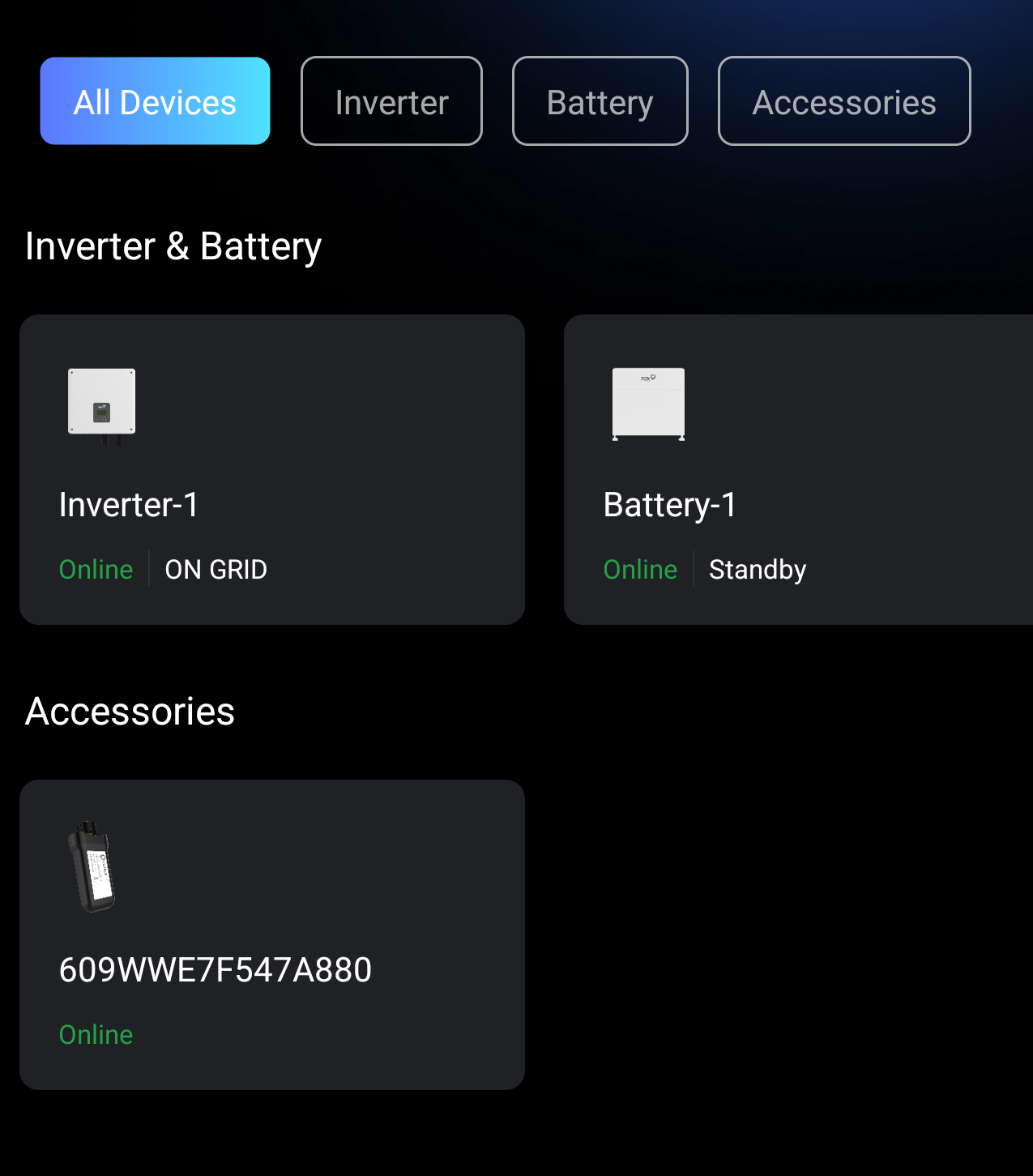

Two days ago I switched from Self Use to Feed-In Priority, as I normally do at this time of year, after which my battery went into Online Standby Mode.
While it still discharges normally and charges from the grid overnight, it won't charge from solar. As soon as the sun goes down it continues to discharge until it charges from the grid between 2.00 and 5.00am.

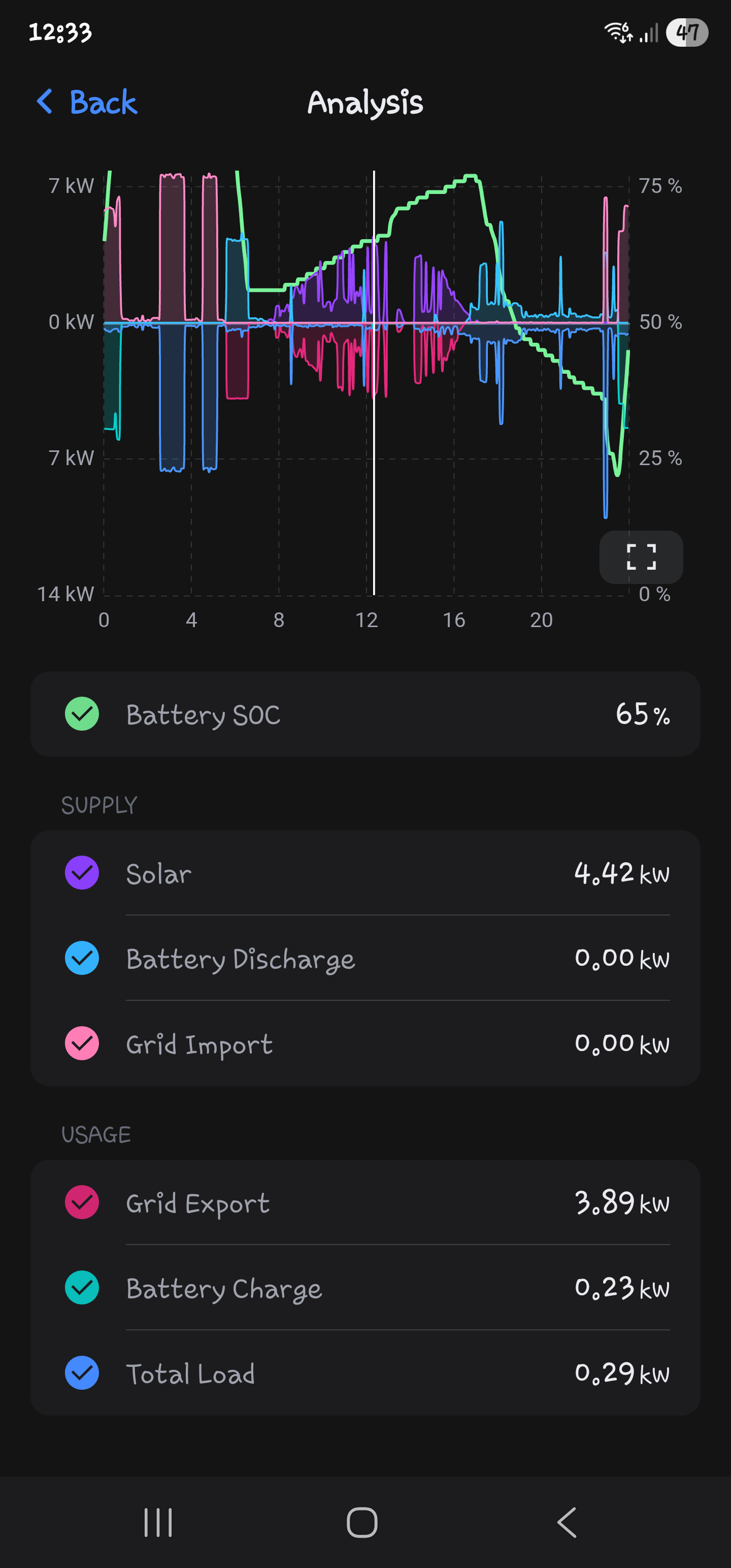

Feed-in mode in action,
Export limit is 3.9kW
PV is 4.42kW
Load is 0.29kW
The spare goes to the battery as 0.23kW of charging
Later in the year, you are going to see more battery charging once you breach your export limit, as will I also.
PV is 4.42kW
Load is 0.29kW

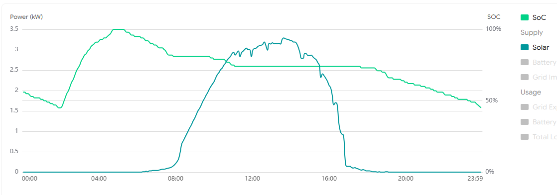

Thank you so much for the detailed (and easy to understand) reply. I feel a bit of a twit now, but I've honestly never noticed this behaviour when I've been using Feed-In, and when my battery suddenly 'flatlined' at peak solar production and would not charge, I thought something was amiss. (See screenshot below]
Thanks for explaining what's going on. I've learnt something new today!
