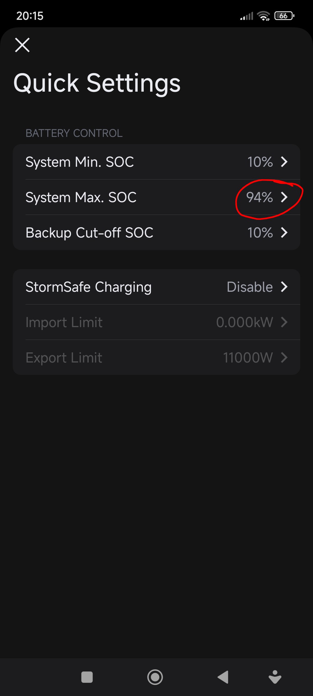

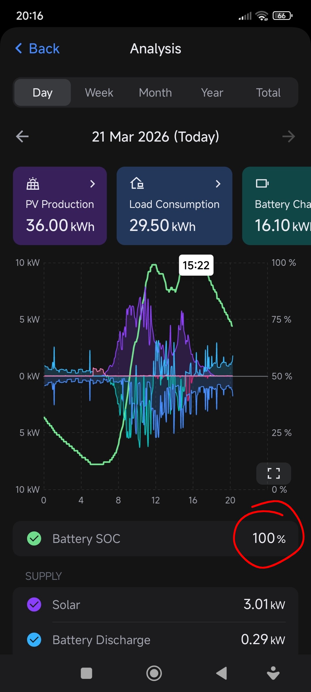

I see that the new udate has arrived on V. 2.2.4. Incredible result max SOC is set to 94%. But the battery charges to 100%. What is happening with the update. My setting before the update was set to 100%. Thanks and all the best

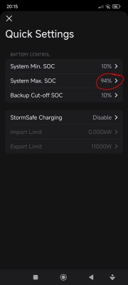

I did not set the mode scheduler. I am attaching a picture. Now I have changed the max SOC to 100%. It is still a mystery how it is that despite it being set to 94% and it is charging at 100%. Thanks and all the best

In the settings there is only max SOC and no maxSOC on grid is visible

Can you pick a SoC figure between 95% and 99% and look for battery charge on your graph.
This is so we can check to see if the battery took a charge, that was measured.

Foxess is updated to V.2.2.5. Max SOC is set to 95% and it charged the battery to 100%. I am attaching the pictures.

I did an additional test, namely I discharged the battery to 85% and the max SOC setting was set to 90% and it charged the battery to 100% again.

Your PV keeps charging the battery to 100% SoC.
It is ignoring the max SoC, so a FW bug or intentional settings by Fox.
