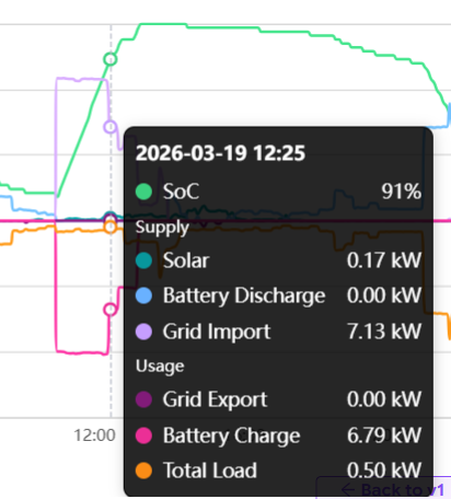

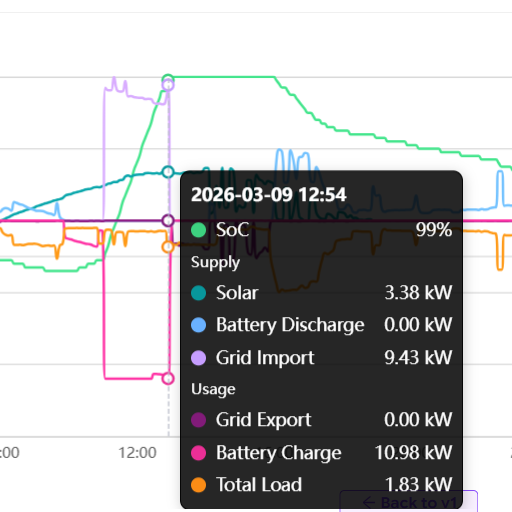

Prior to 10th March, the charging rate was generally close to 11kW (10kW from grid + 1kW from solar) all the way to around 98%.
Since then there seems to be a big charging rate drop from 90% and then again at 95%.
This means it will be harder to get to 100% during the 3 hours of free import.

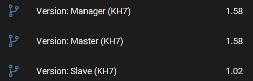

Pictures 1 & 2 are the same, not sure if you was trying to show something different?

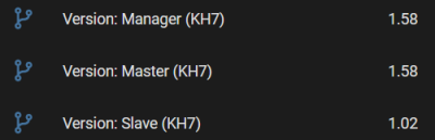

My battery FW was applied a while back, but the behavior seems to have changed, so I am thinking maybe Fox have changed some back-end value perhaps?
Inverter FW was updated 8th January. It was changed since this date to the latest, but I do not have date.

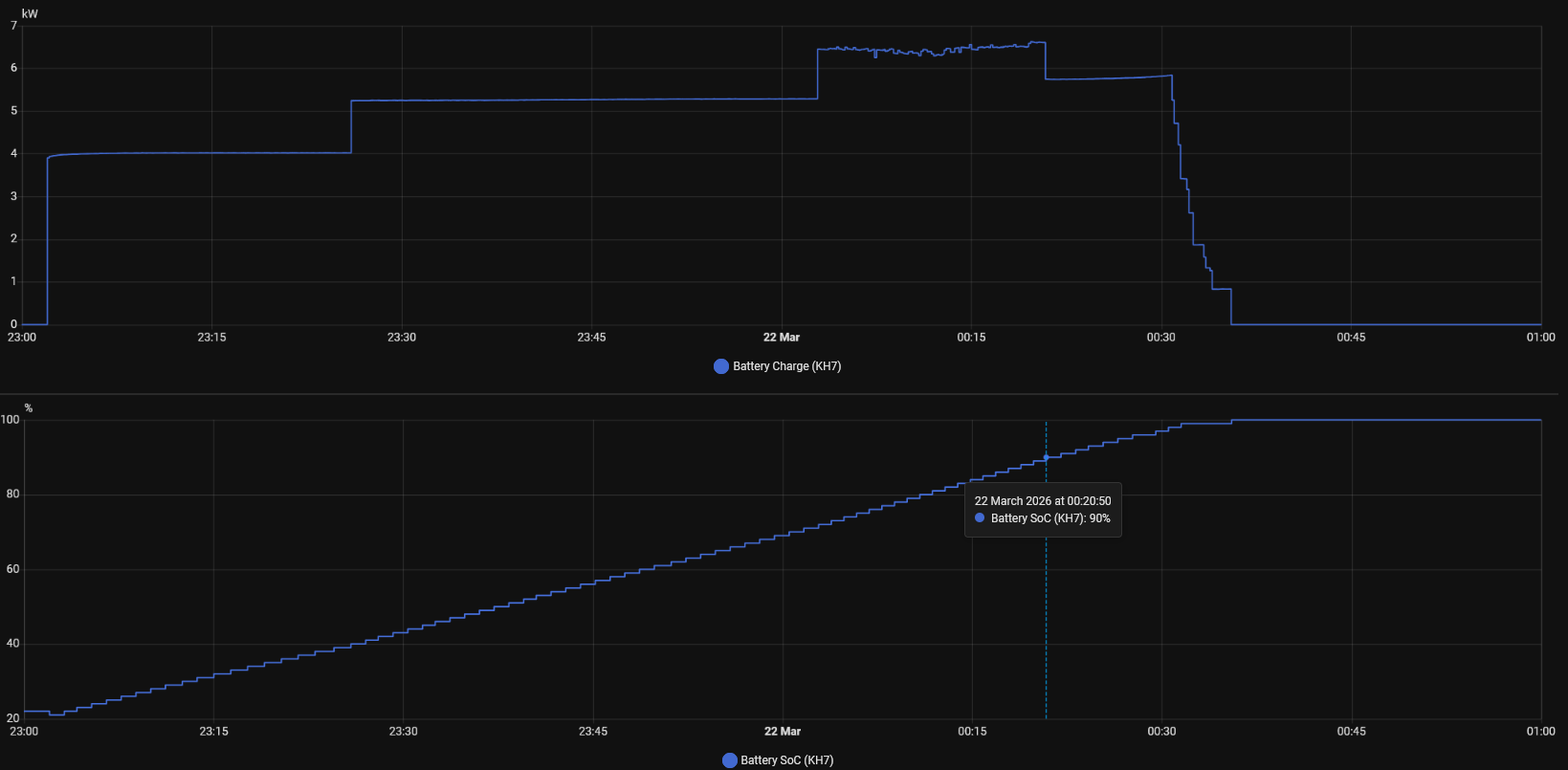

Here is a picture of my system from 11th January, it is charge rate vs. SoC.
Key points are that it was running at full charge speed until 95% SoC, and then you see the charge rate drops off in stages. So it did not throttle back at 90%

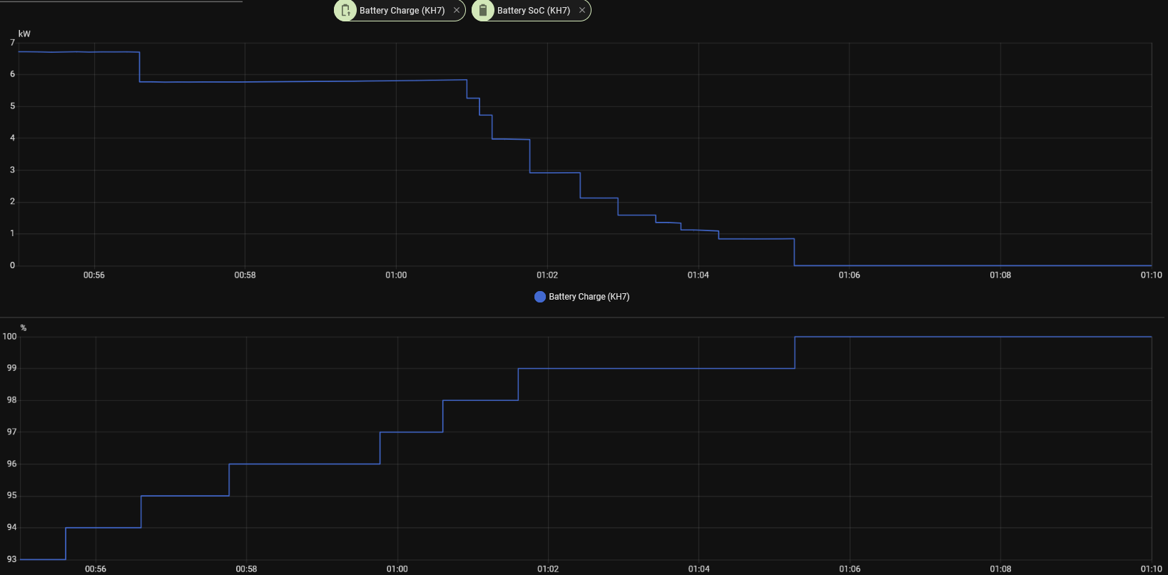

Here is the system behavior from last night, the charge rate begins to drop off at 90% now.
You can see the charge rate before this stepping up as the battery temperature increases (still got cold UK nights)
