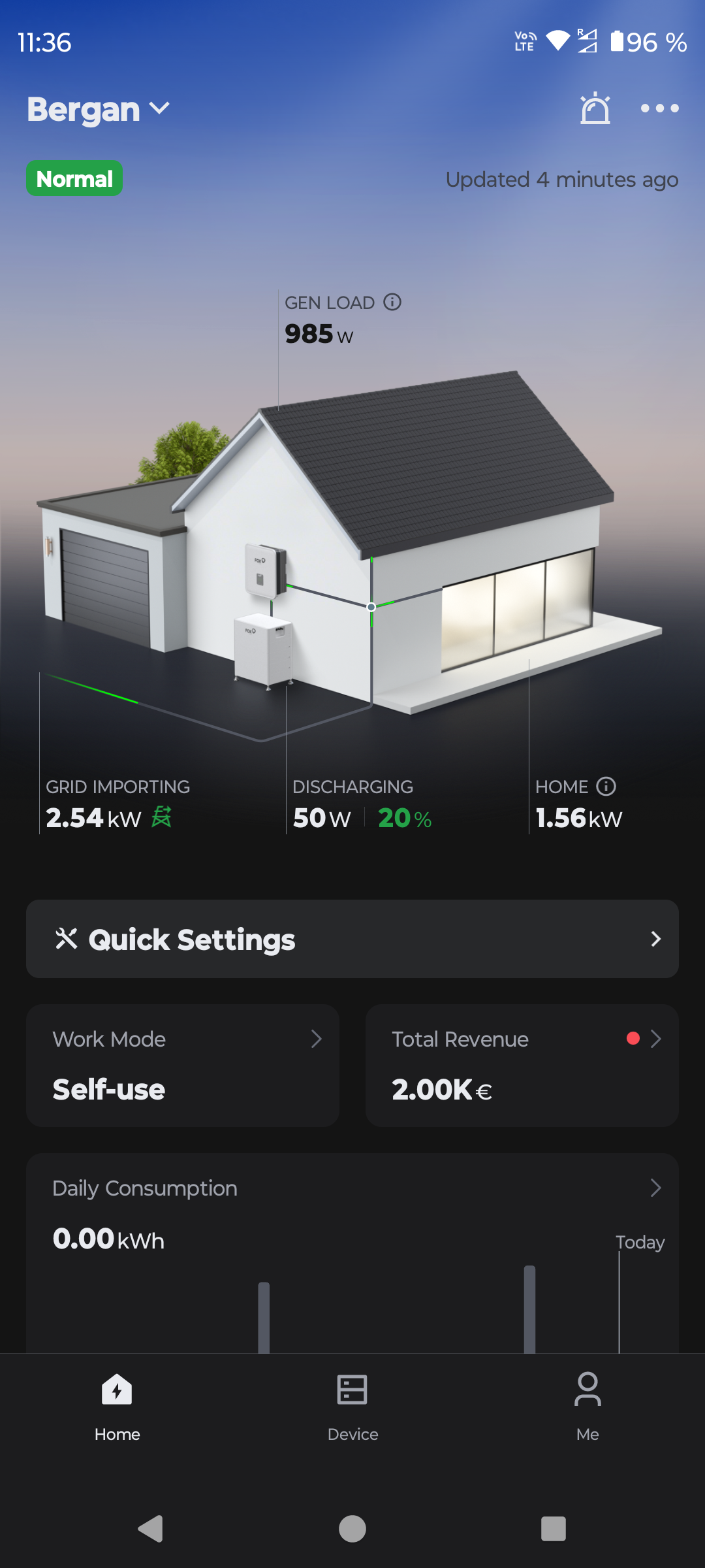

I have a combination of FoxEss battery w/inverter + Huawei panels and inverter. Therefore I guess it is not possible to access the PV from the FoxCloud app, I guess. Otherwise it seems to work ok, and the app reports that "the system contains the power of third-party generation device". My problem is how to interprete the values, see example screenshot. It seems that "Grid importing" is the sum of "Gen Load" and "Home", but that doesn't make sense to me.
Anyone can explain, maybe having similar mix hardware setup?

Given genload seems to be added to house load but not showing as negative it might something like a wrong CT clamp setting.
It might think it's a car charger that uses power instead of panels that produce power.
