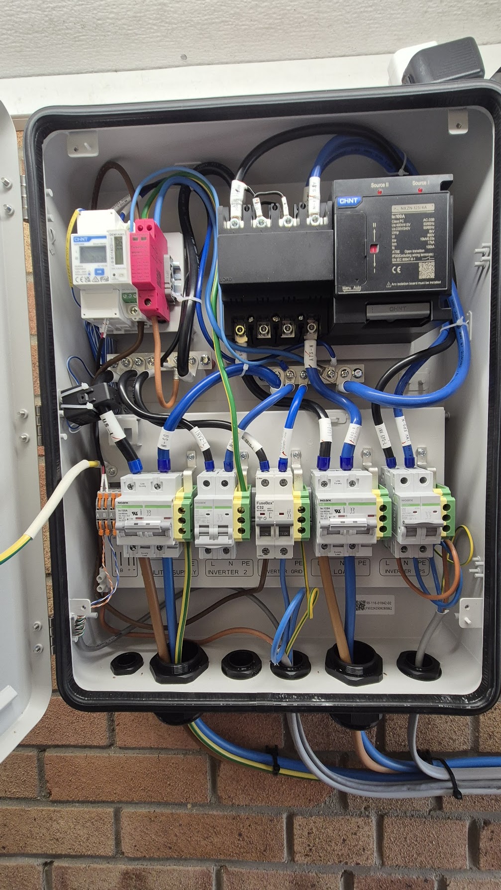

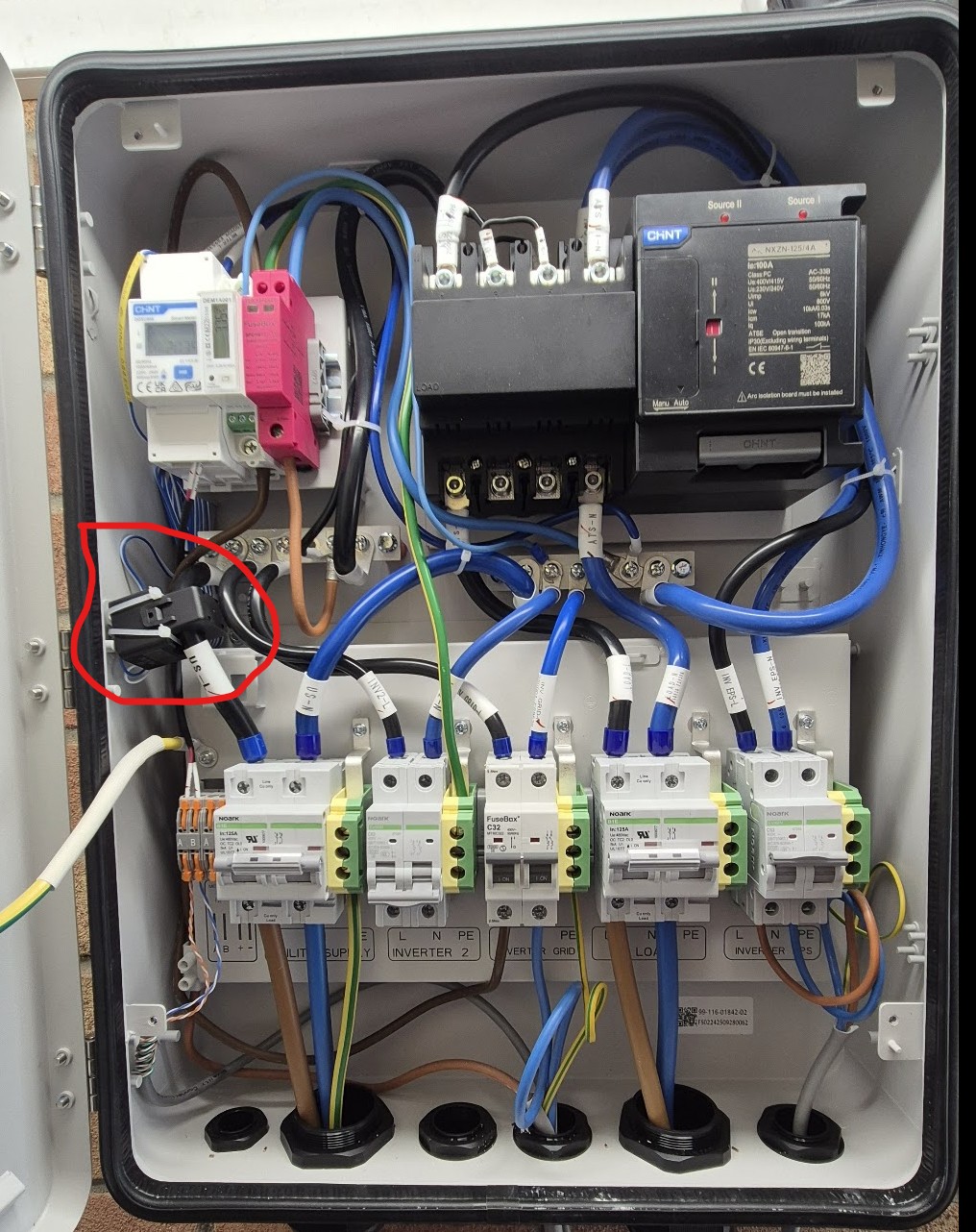

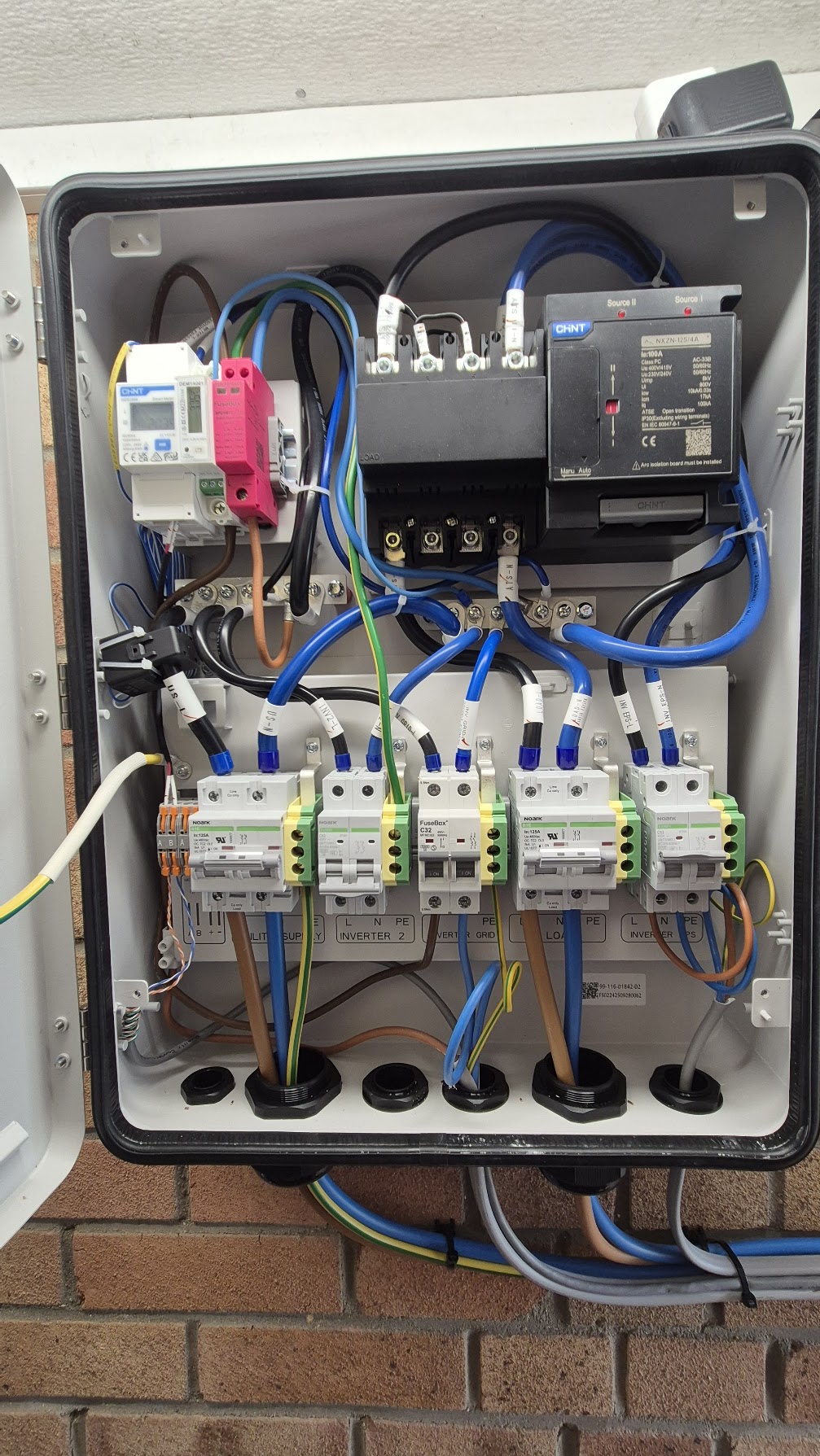

The CT for the inverter is on the utility supply L (1st breaker in gateway)
we shall see....and I shall report back

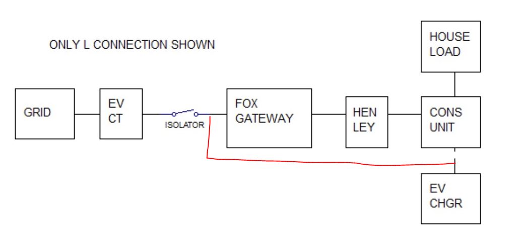

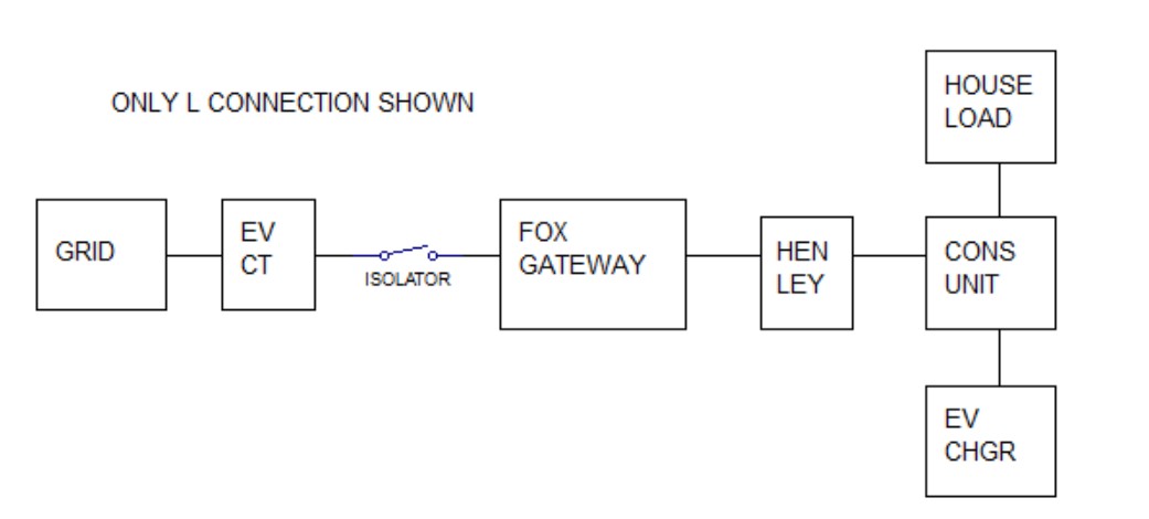

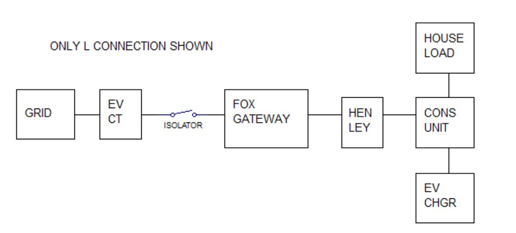

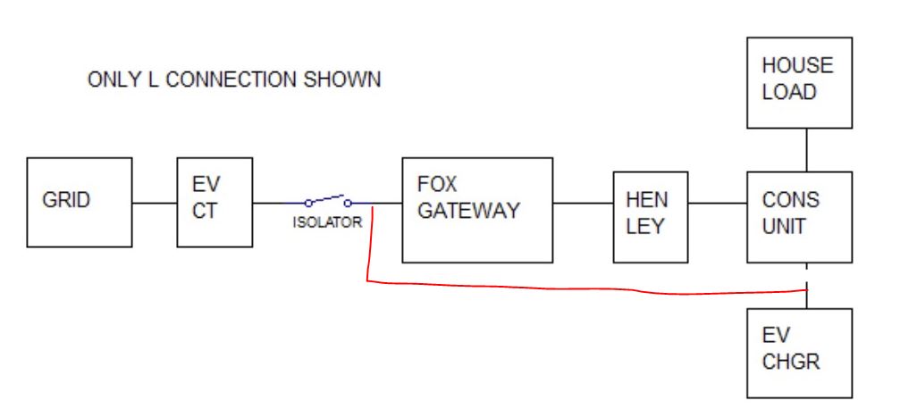

For you situation the EV charger needs to be on its own consumer unit with the feed taken via a Henley block between the supply isolator and Fox EPS box, this way the EV charger is completely independent from and unseen by the inverter/EPS system

Thanks, I believe that is the plan.........and these are the professionals.....hmmmm.......annoyingly I could do all this myself but thanks to the namby pamby country we live in I'm not allowed to....I seem to have more idea than the professionals !

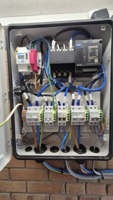

all done.......and co-incidentally during the testing / sign-off we had a power cut which initially threw the engineer as he was suddenly faced with no voltage from the grid and the battery was literally AT 10% so the inverter tried to power the house via the battery but couldnt because it was too low!
The PV however managed to co-erce just enough power to let it kick in so, for the first time ever we had power during the power cut

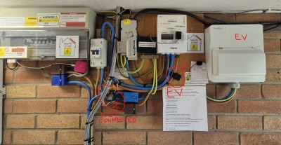

Now sorted properly with the EV supply in it's own metal C.U. on the grid side rather than the house side of the inverter

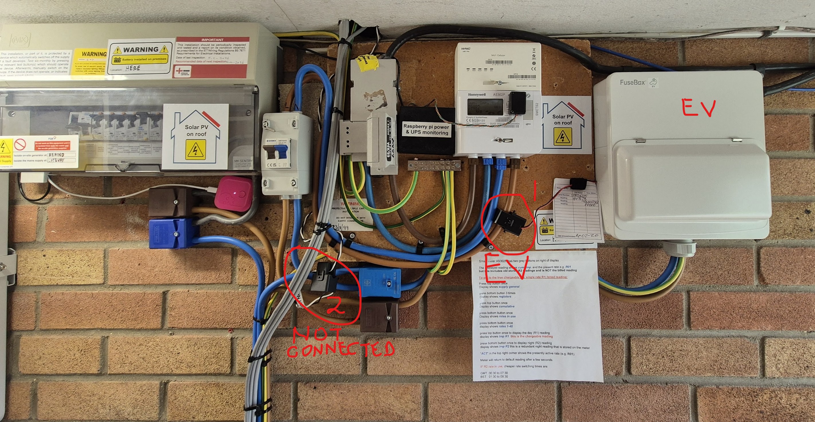

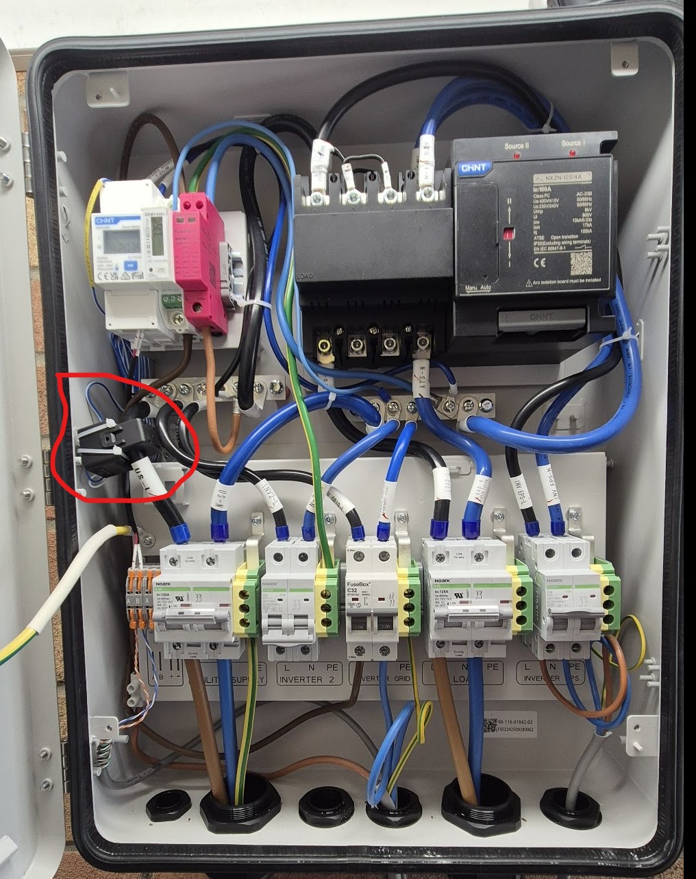

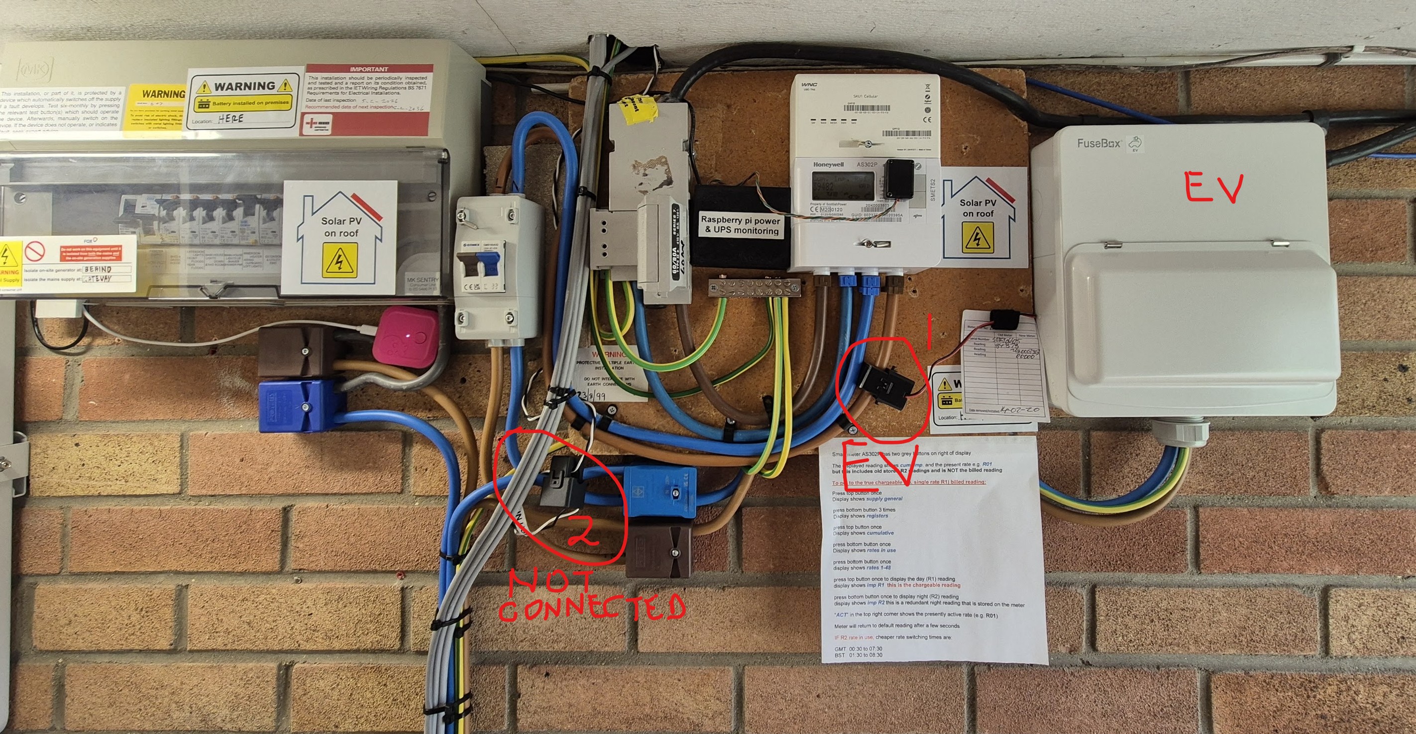

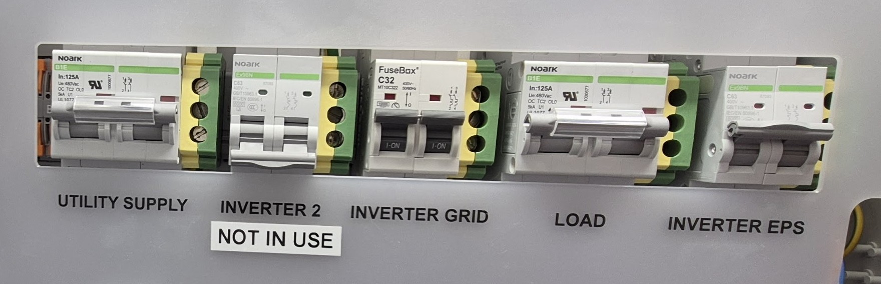

the EV CT is on the main incoming feed from the DNO fuse immediately after the meter
The CT marked 2 is not in use and not connected (was run in as a spare now not needed)

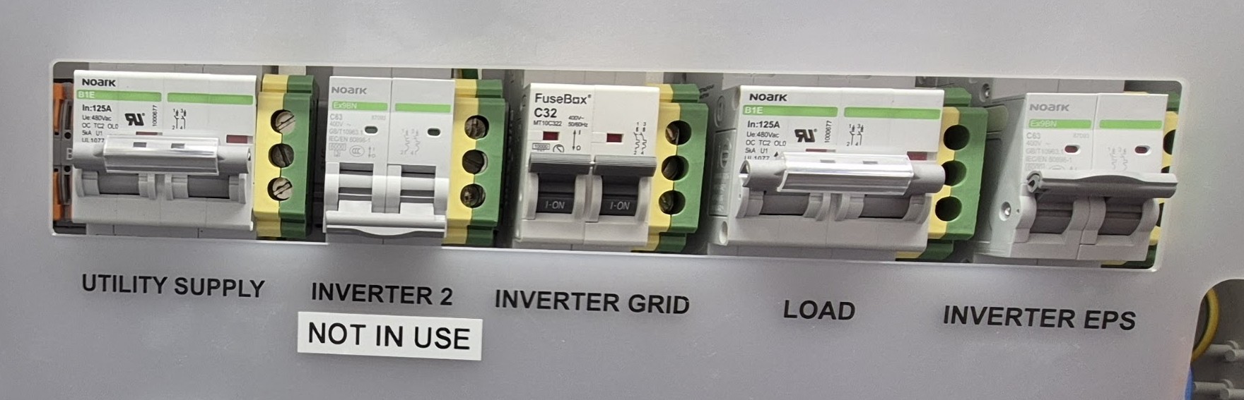

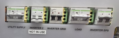

The inverter CT is on the incoming supply to the Fox switchbox
presumably that is correct

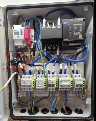

That looks correct now.

edit...correct picture now attached!
