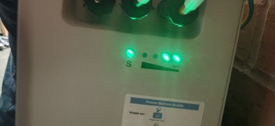

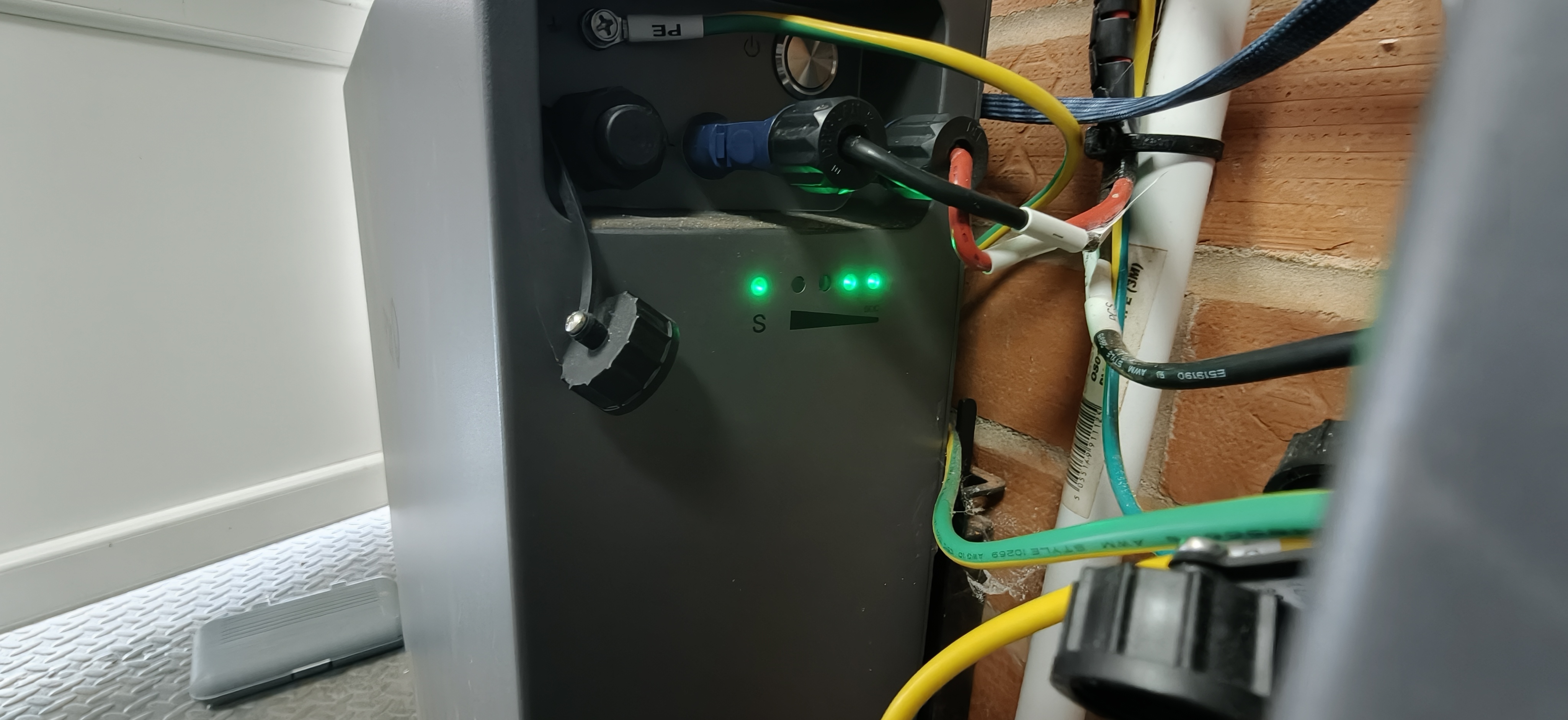

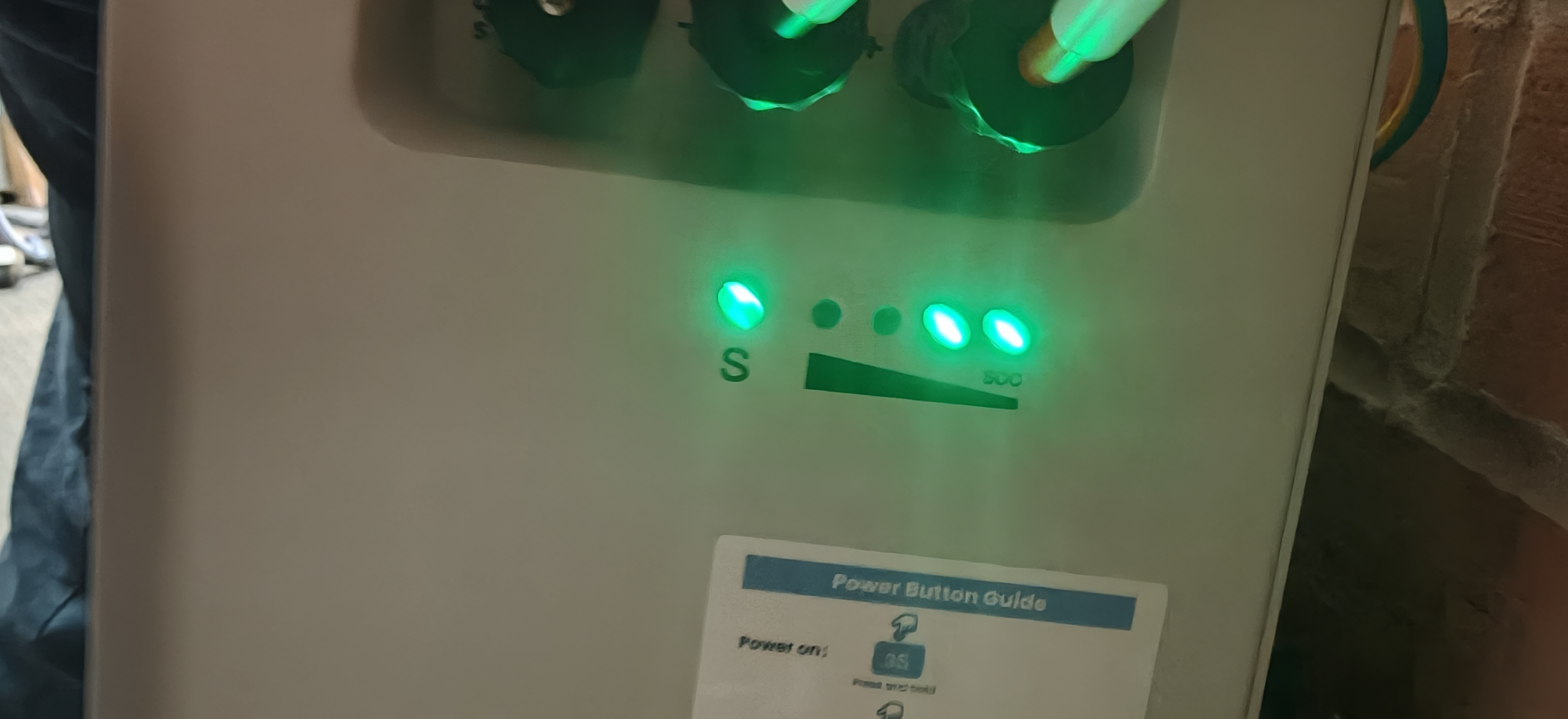

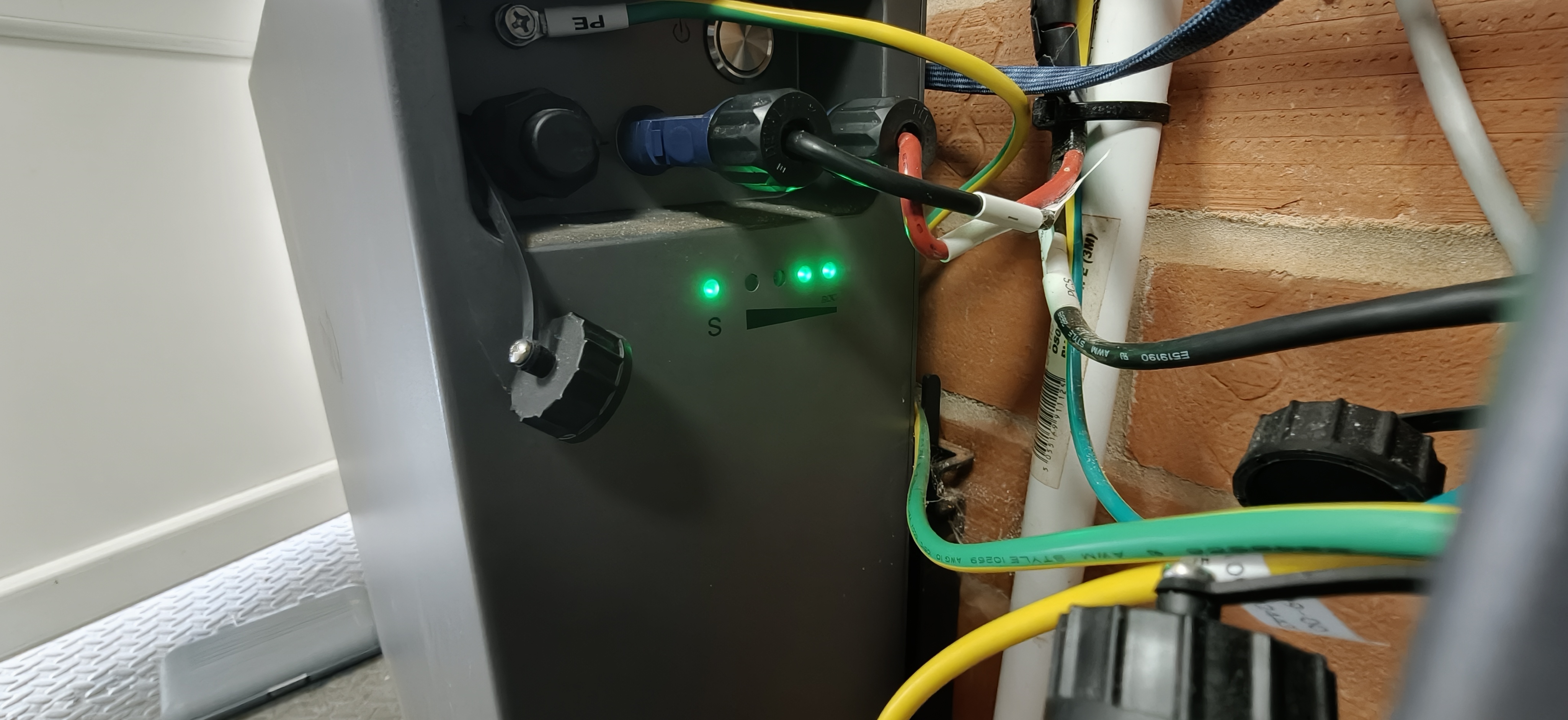

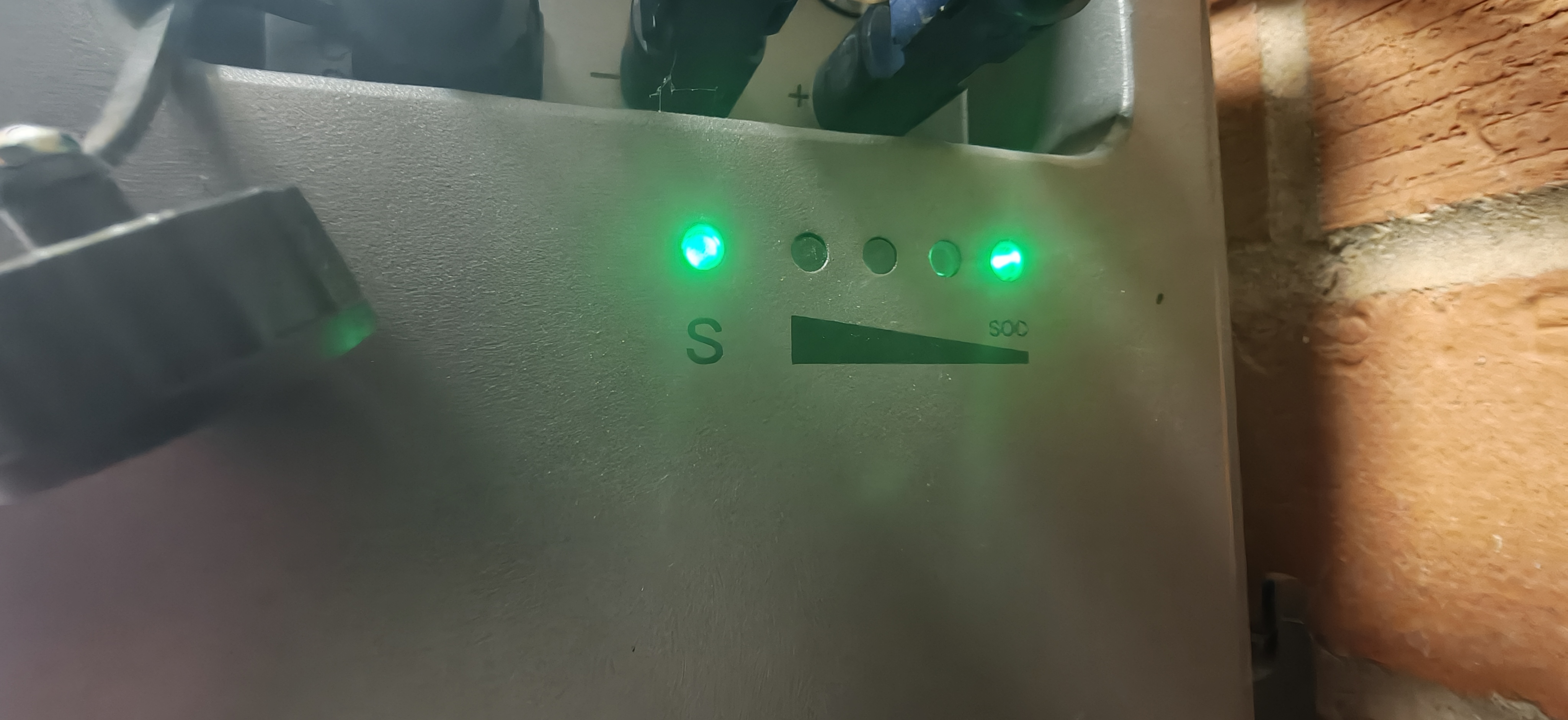

I have added a Ep12 to my pair of EP11
but my invertor will not see the EP12 in the online add.
am I missing a step to pair this new battery?
BMS version on the EP11's is 1.012
Version_Master:1.64
Version_Slave:1.02
Version_ARM:1.60
Ep12's firmware is unknown as even disconnecting the EP11's and connecting only the EP12 I don't see it.

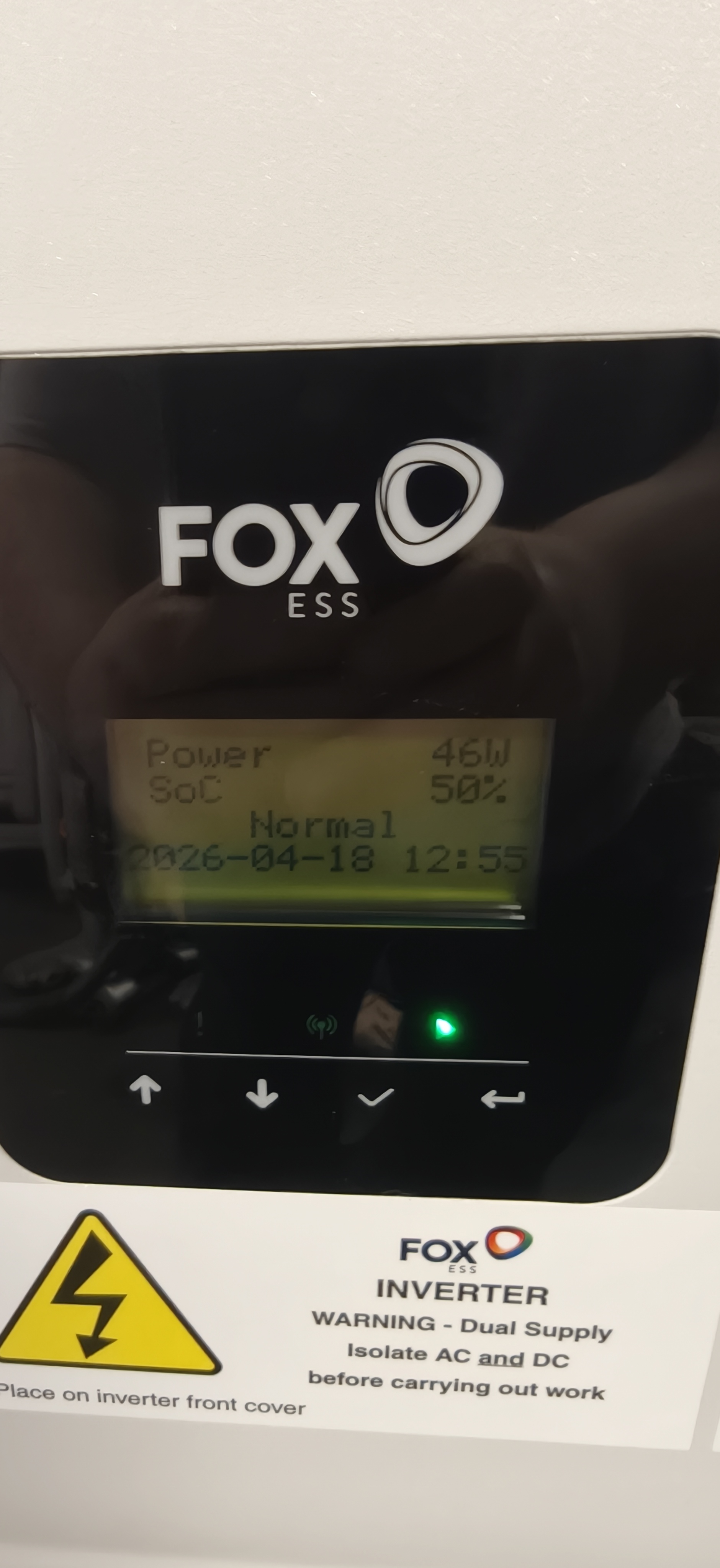

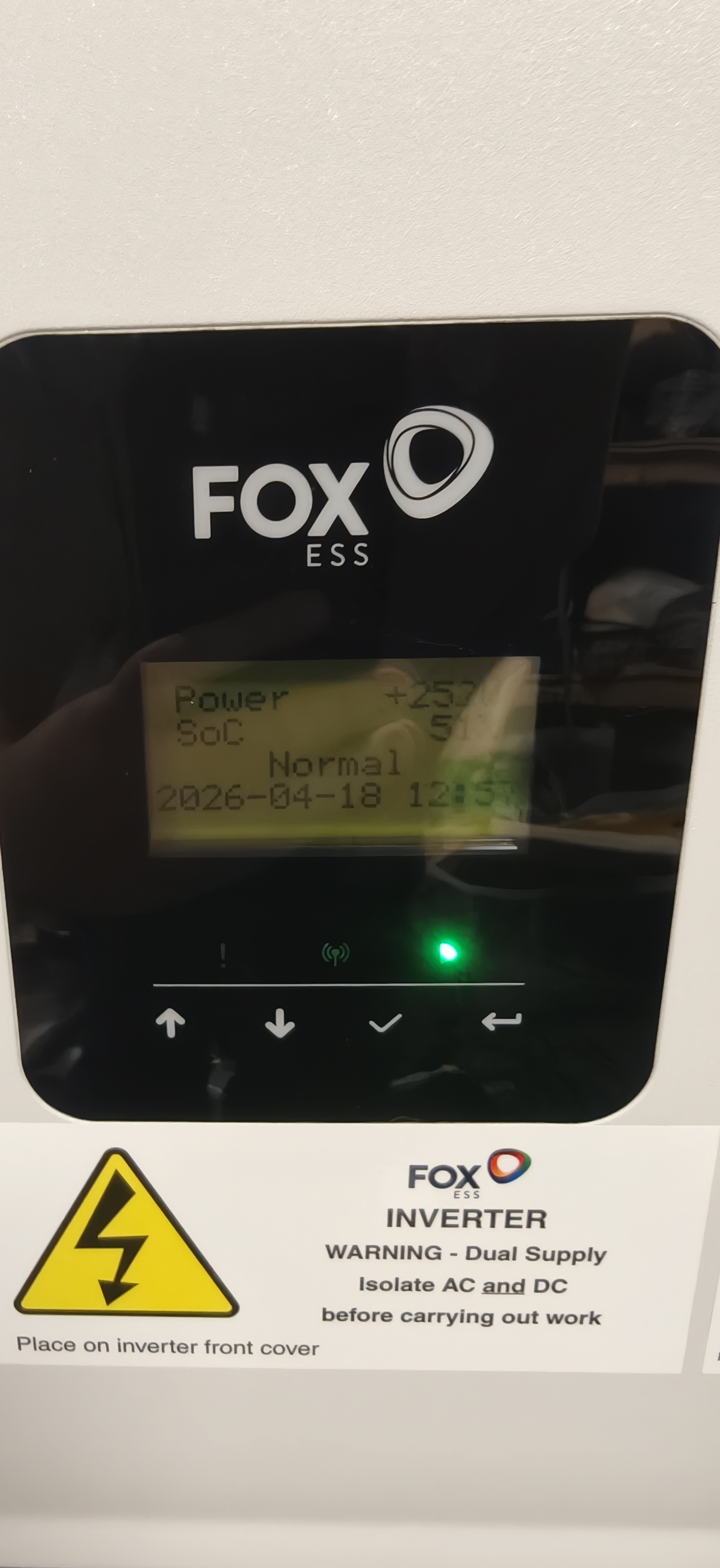

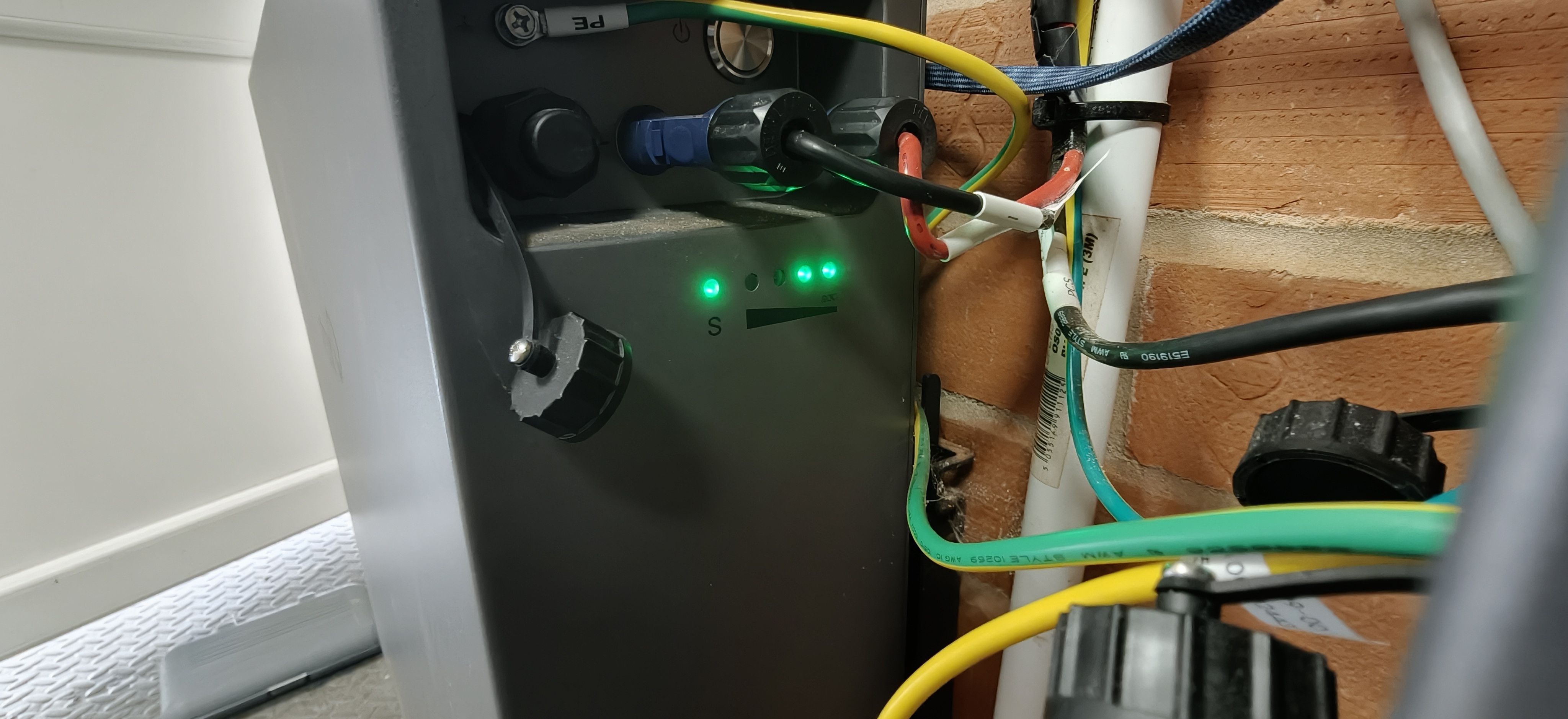

the inverter screen reports normal and the batteries look like they are charging.
how can I debug this?

ok this was me being impacient as the system seams to have sorted it self out. so must have just been offline for firmware cross loading.
a though i have noticed that the invertor has no data in the cloud system a lot and only seams to update once every 30 minutes
but hay the core issue is resolved.
