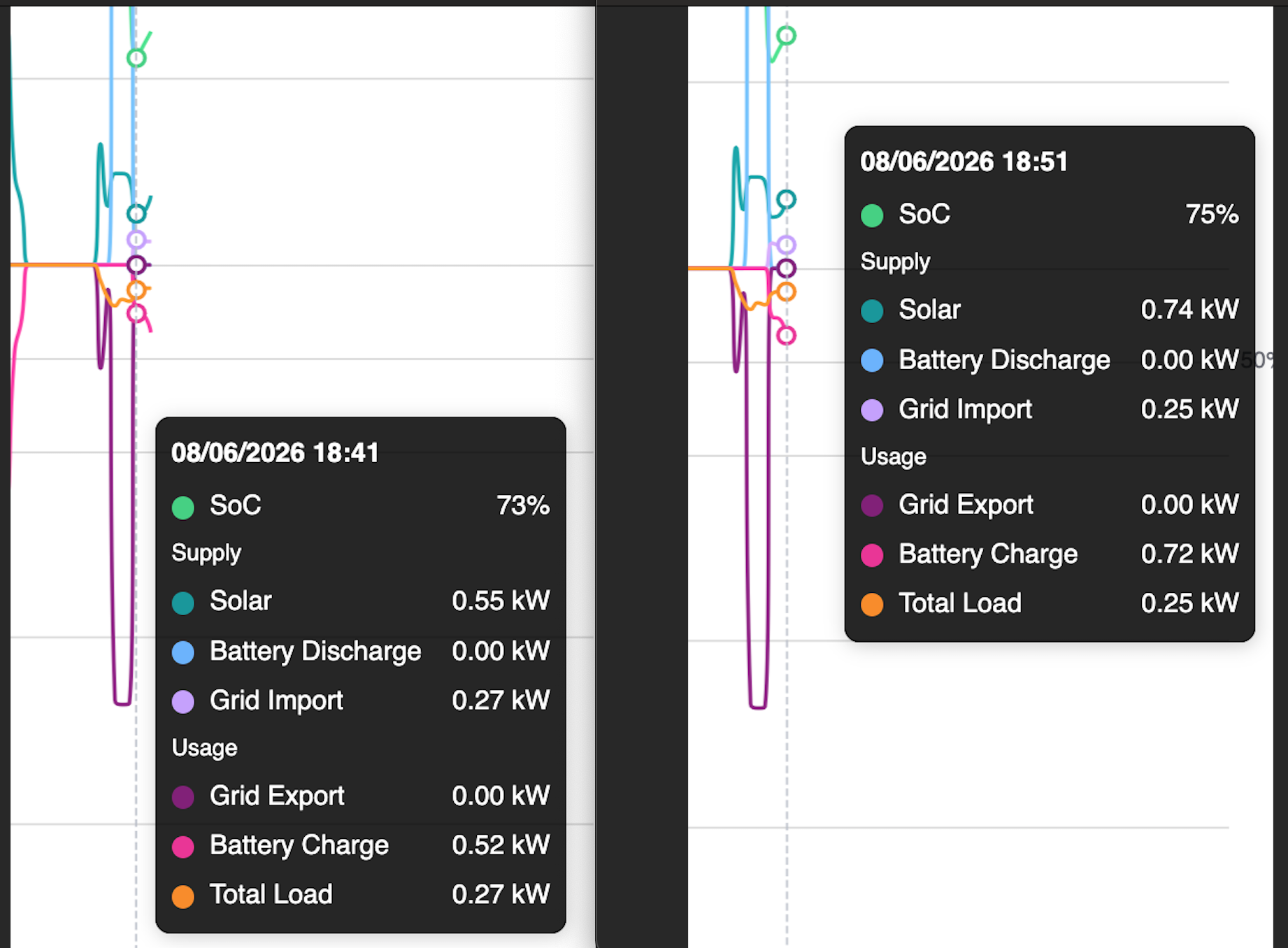

I know that if the battery is at the minimum SoC (73%) that I have set in the mode schedule then the house will import from the grid any power required if the battery is still scheduled to export.
So my problem is that I have just stopped a forced download as it had already reached the level of SoC (73%) that I had set and did not want to carry on exporting because I wanted to start using my electric cooker.
BUT
Even though I had stopped the export to the grid and even though the battery was charging and up to 75% the house was still importing from the grid??
I eventually changed the work mode to self use and this stopped the house from importing. I then changed the work mode back to Mode Scheduler and this did not trigger an import.
What the heck is going on?
I know the numbers are small but if I had put my cooker on those numbers would have shot up!

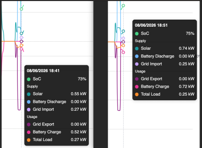

The picture shows that I stopped exporting at 18:41 and the importing started
Help and explanations needed please
