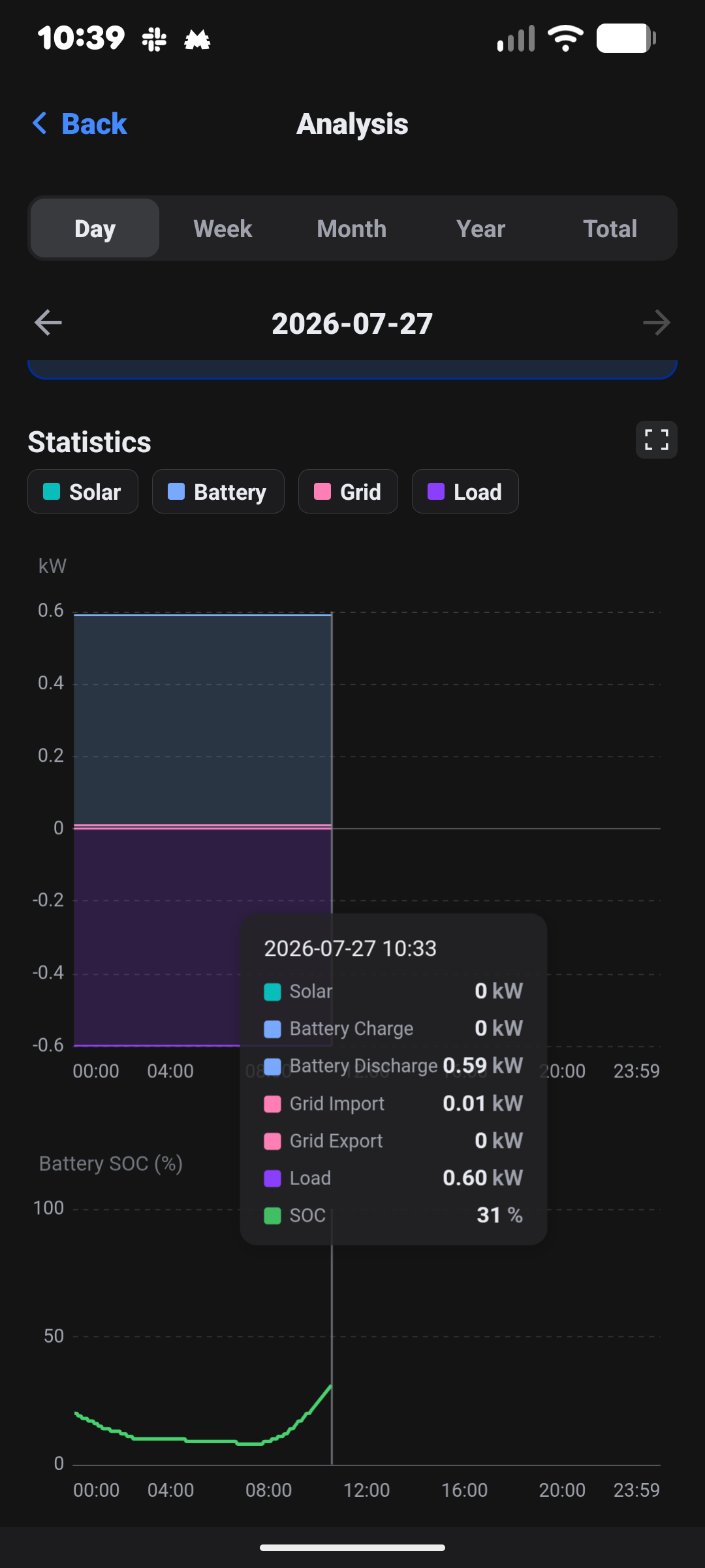

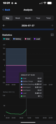

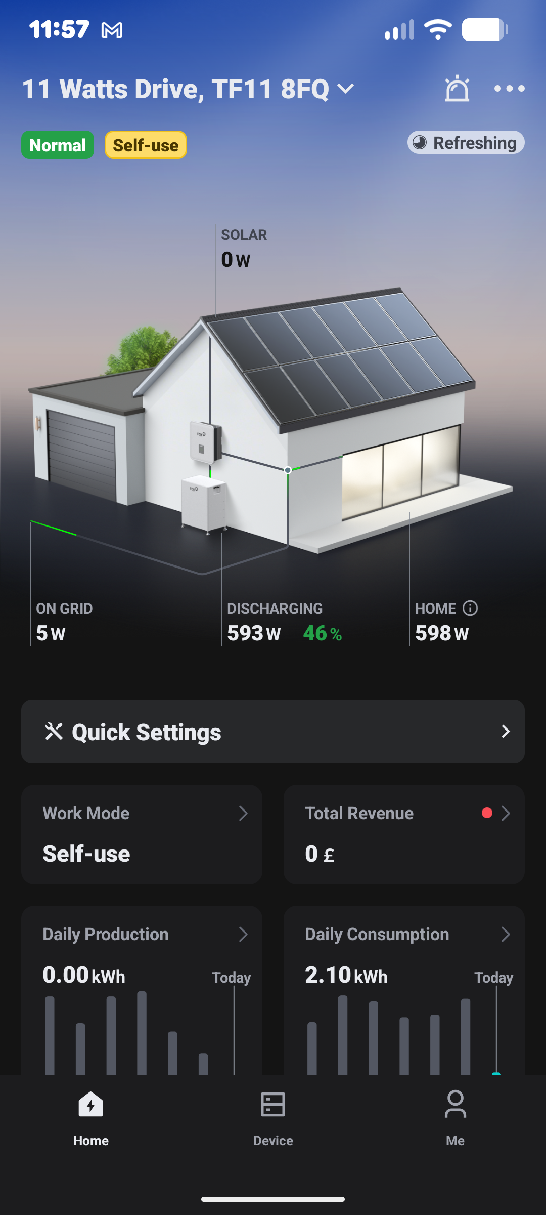

My system has been in for about a month and been operating fine.
From 8pm last night the Solar Power generation has been showing as 0 Watts, Even though today, the battery levels have been steadily increasing (as if Charging).
Any advice is very welcome :)

What system do you have, is it a hybrid inverter with panels / battery, or just a battery system with a separate inverter ?
Re: Mobile App and Equipment reporting 0Watts generation
Throught some investigation.
Fixed it by a full powerdown / powerup. (Video linked from this forum :) )
I would normally say that is a first port of call (sounds like your inverters manager had crashed), but it's always best for me to check what kind of system you have as it could have been the other inverters CT clamp that had detached - but glad you have it working again :)
