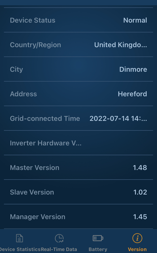

Many thanks, I am running home assistant, but where do I get the latest firmware?
I think I'm on 1.48
Posts: 1850
Kris wrote: Mon Mar 13, 2023 8:53 pm Many thanks, I am running home assistant, but where do I get the latest firmware?
Firmware can only be loaded if you have an agent account, but normally you would speak to your installer and ask them to update you to the latest versions. I believe Fox support will update if asked but it won't be a priority unless you are reporting an error.
