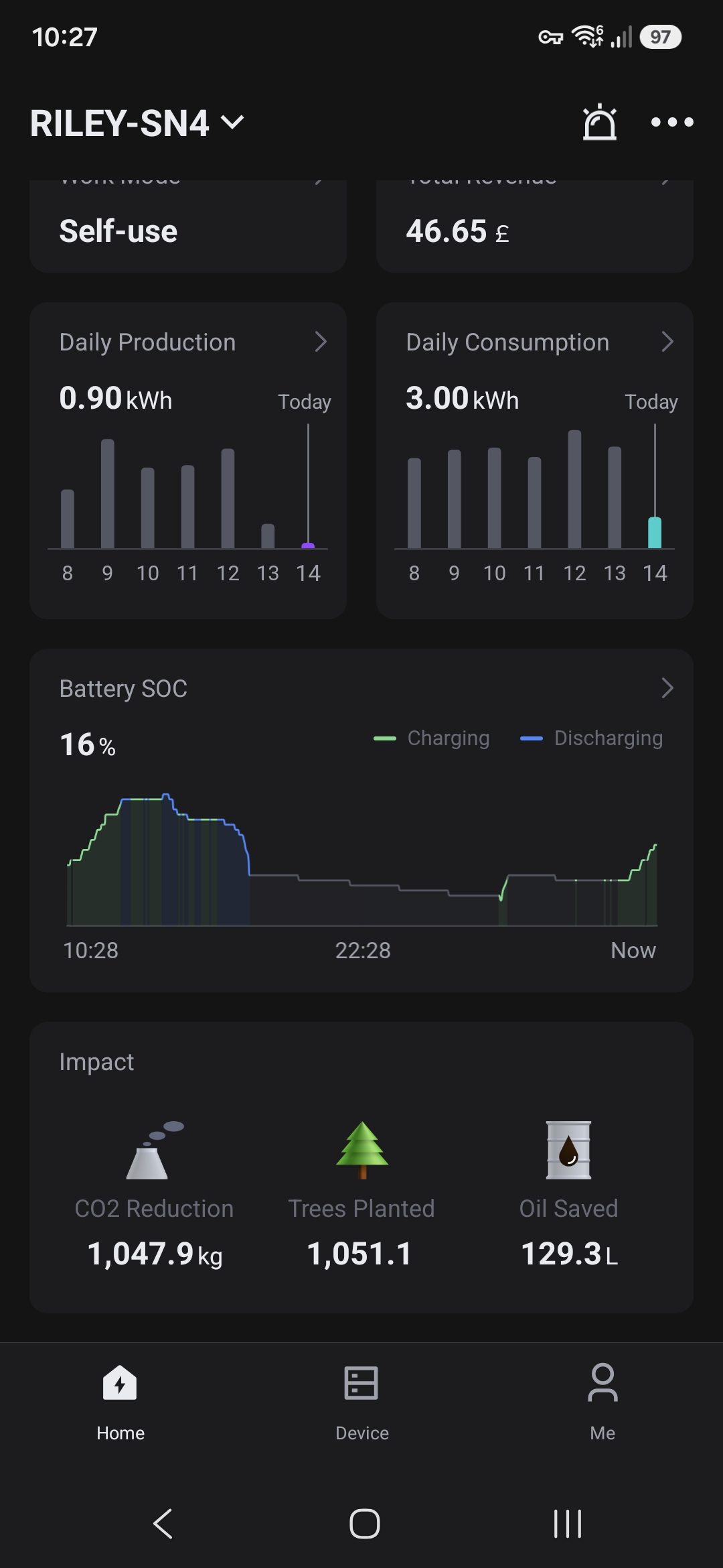

My system is set for a minimum SOC of 10%. Yesterday, due to heavy cloud the battery never charged, not unexpected at all..... so it ran down early ( evening meal prep time) and we were on the grid, again not unexpected.... however, overnight the SOC continued to drop steadily but slowly, eventually reaching 6% when it suddenly charged back to 10% from the grid before dropping slowly again, until solar started again. Attached a screen shot of the app to show,hopefully what I mean.
Questions are 1) is this normal behaviour...dropping below set SOC and recharging when no charge period is selected? and 2) is dropping to 6% going to harm the battery, installers said not to go below 10%?

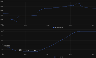

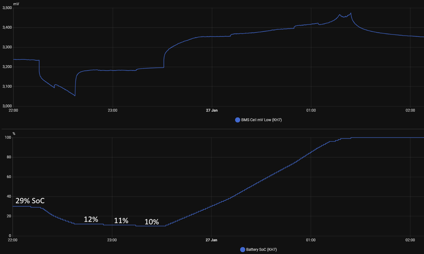

Well the SoC is just a 'construct' of the Cell Voltages, there is only a small mV difference between 'flat' 10% and 'full' 100% SoC. You will also see that the cell Voltage can drop below, then recover back what you would expect the min cell Voltage to be. Once your battery has been low for a few hours, the reported SoC can drop below the 10% minimum as the BMS recalculates.
