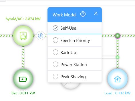

It is the switch offered to allow the work mode to be changed remotely from "Self Use" to "Feed-in". It used to be at about 4 o'clock by the invertor icon but is now at 3 o'clock and displays differently, so:

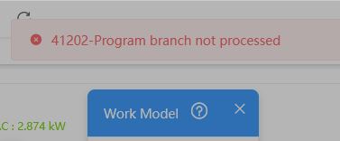

The problem is that when you try to switch mode, a password request pops up, but even with the correct password, it gives an error of:
Fox webapp 2.JPG (14.39 KiB) Viewed 8740 times
and the mode stays unchanged.
I have checked with the android based version and see there has also been a change but it still enables mode changes. On the other hand, the web based version accessible in a browser (I am using Firefox) definitely does not lett you change mode.

I'm not aware of any information on new workmodes, but the HA integration linked in my signature lets you change workmodes via modbus, if you have an RS485 connection to your inverter.
FoxESS Modbus HA Integration

Thank you for the confirmation, Calum. I do now have a working RS485 connection and aim to take the plunge into the intricacies of HA soon.
I guess I was hoping for the odd simple command on the RS 485 port to save myself dealing with the rest.

I suspect it's quite possible to use one of the various modbus command line utilities to create a batch file that would set the workmode remotely. But if you have an RS485 connection to your inverter I presume you're planning on setting up Home Assistant or NodeRed or something?
