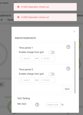

Server has been only partially working all day. I can't set the force charge or min SOC just get "timeout" or similar. Any idea when it will be working?

Hi I am having the same issue on the app and foxesscloud.com.
Luckily I have quite easy access to the inverter and can set my charge from grid times and SOC on there.

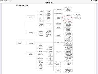

Page 32 in the user guide contains the menu tree how to get to charge times and SOC settings.
I have the H1/AC1
Menu > settings > work mode > Charge time.
Menu > Settings > Battery > min SOC, Max SOC, ongrid Soc.

All working now
Posts: 1855
I'll leave this here just in case anyone needs it again - into Settings, Work Mode, Charge Times to change times manually.
