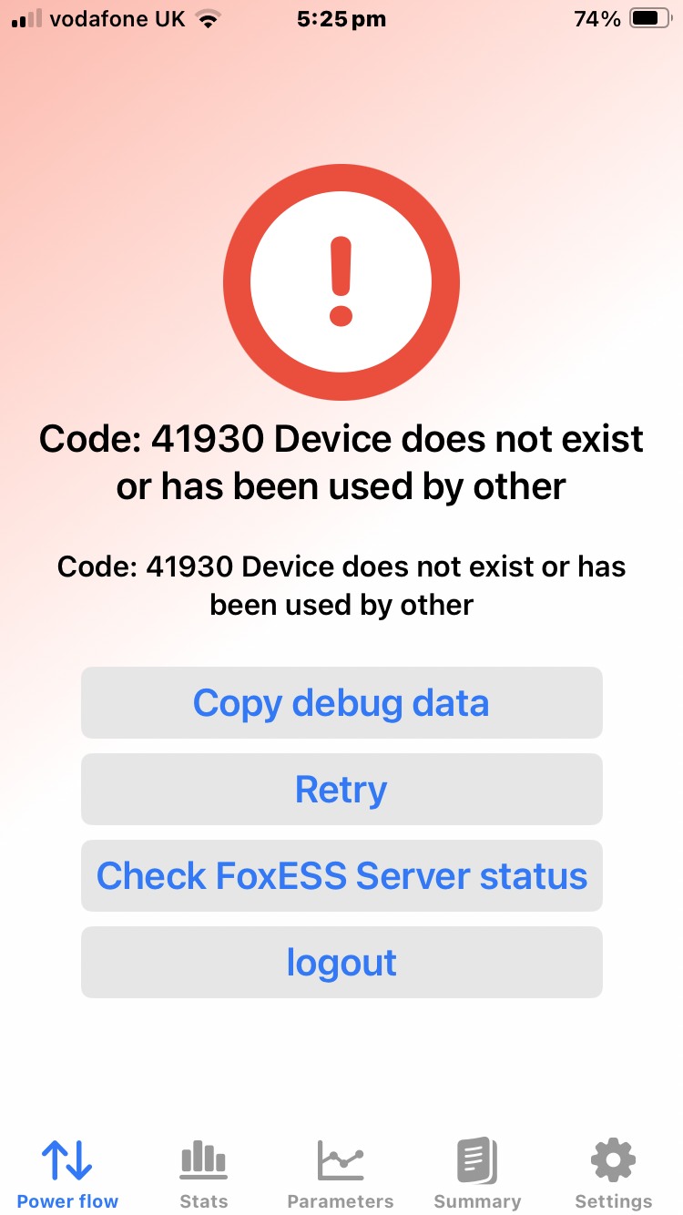

okey dokey !
managed to copy the number , paste it to an email , take a photo of it with the phone , then highlighted the number and copy and pasted it to the app , and got this
i searched for code 41930 on the net, and it came up as "odd coloured socks on " so i checked but no they are both black .
regards
robert.
regards
robert.
- Posts: 1850
Hmmm it sounds as if all that transferring of data may have induced a typo, or missed a character - the error 41930 occurs if the key is invalid, or re-used.ivanhoew wrote: Sat Feb 24, 2024 5:30 pm okey dokey !
regards
robert.
Some users have found they only way they could get this to work was by manually typing the long key by hand from the website straight into the app.
Can you re-generate the key on the webpage - and then type exactly what it gives you, including all of the '-' characters into the apps api_key, there should be 36 characters in total.
Dave Foster wrote: Sat Feb 24, 2024 5:44 pm

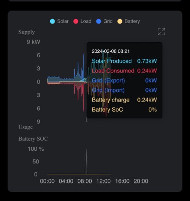

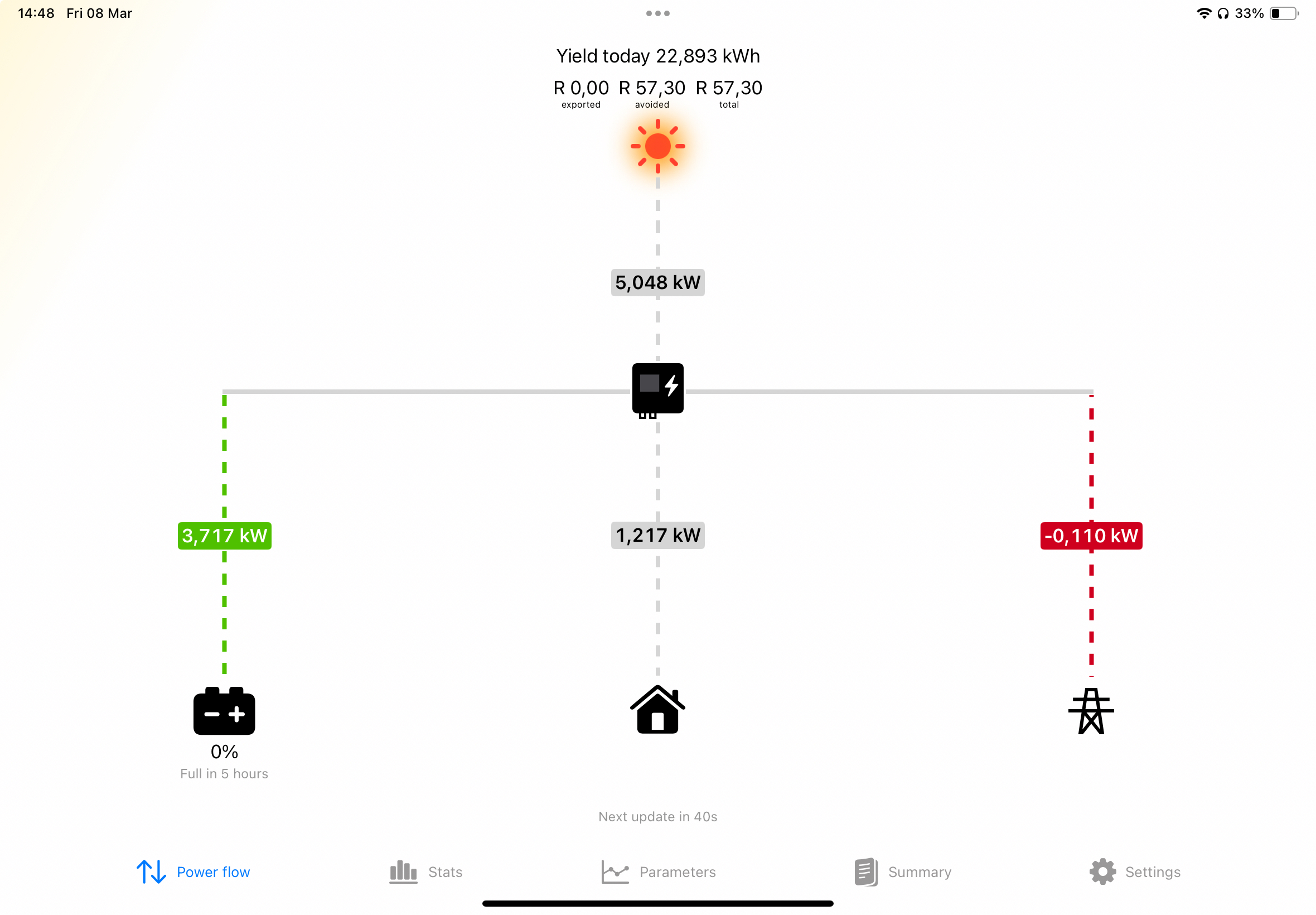

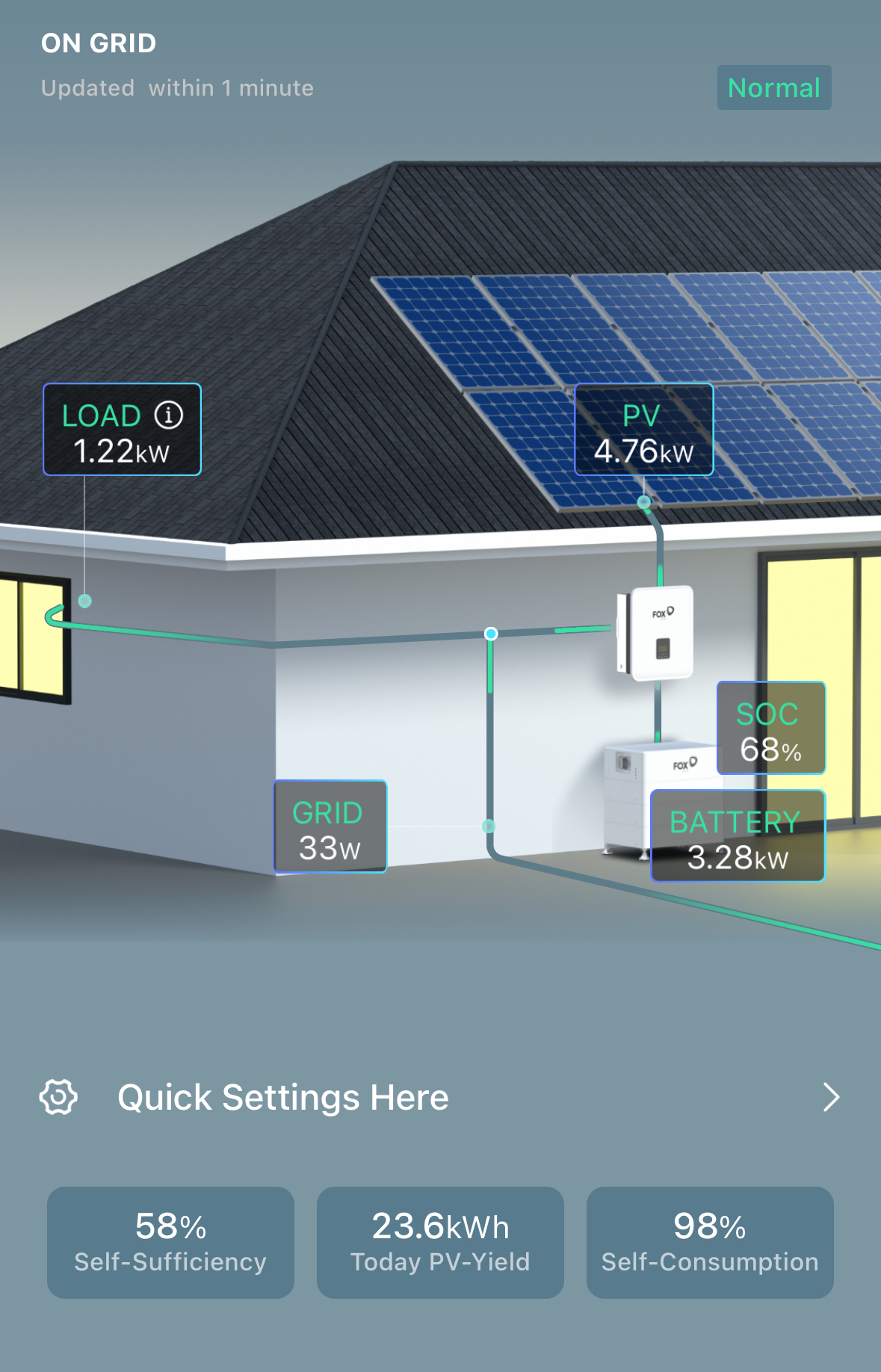

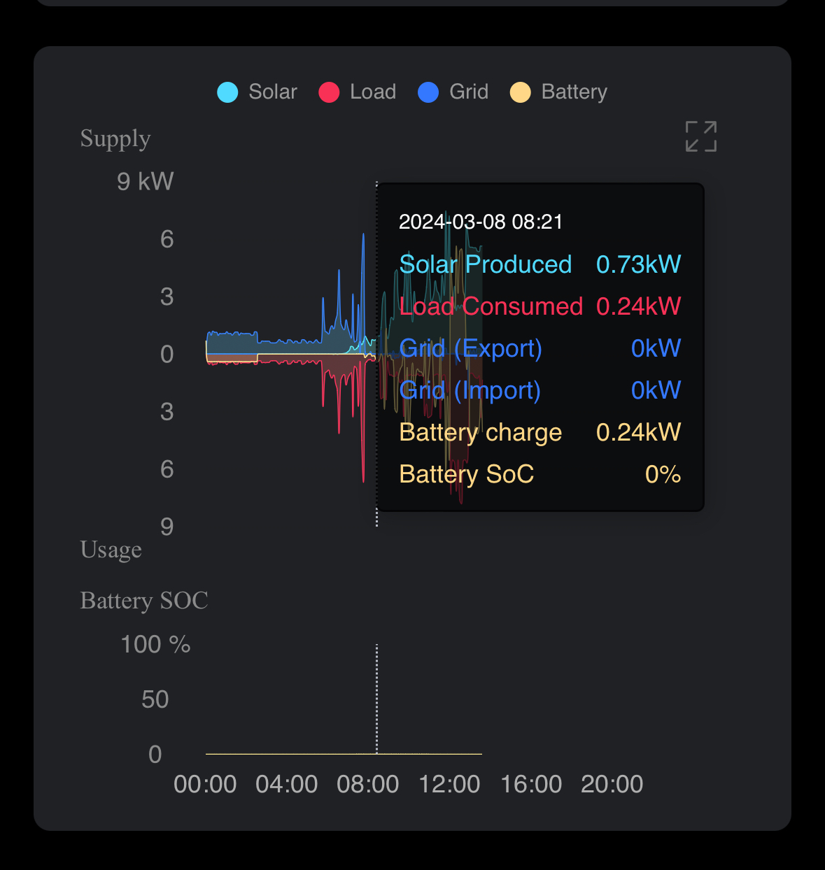

I've just had an H3 system installed. I've setup an integration into Home Assistant using the cloud integration and noticed that Battery SOC% is not pulling through.
The official 2.0 app shows the battery % on the home page but nothing when looking at the daily graph. Also tried the "Energy Stats" app and SOC% also 0 there, so clearly an issue with the API.
I have contacted foxess support but yet to hear back. Is this something effecting just me?

Mine is working, but I have heard a few people saying there were issues earlier and that again some maintenance was being done - interestingly the battery stats are stored separately from the main database and so i'd wait 24 hours and see if the problem persists.timsdrew wrote: Fri Mar 08, 2024 12:57 pm I've just had an H3 system installed. I've setup an integration into Home Assistant using the cloud integration and noticed that Battery SOC% is not pulling through.
