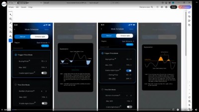

Update from Fox ESS support is that new firmware for H1 Gen 2 inverters should be ready by the end of this week (1st March 2024) and to request an update next week
Hopefully in time to support the new Octopus Agile functionality coming in Fox ESS app ver 2.0
https://fb.watch/quPACBookH/
