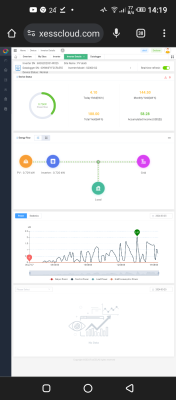

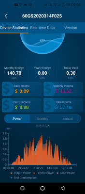

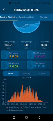

Why does electricity production in my foxess s2000 g2 inverter return to zero successively even in sunny days??
Can you post a graph of the inverter output when it happens, and are there any errors reported ?

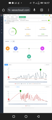

Can you log into the Foxesscloud website, on there on the device page, in the graph at the bottom you can select variables to look at - can please select pv1current and pv2current and post the screenshot.
It may be the string is going over current - which you will see from those traces, the maximum current per string is 12.5A after which it will cut the power on the string, recovering shortly afterwards - which is what you are seeing but I am surprised there are no errors.

That looks very strange, the current was looking as you would expect up to 8.9A then it started the up and down - is there any kind of shading, a tree, a post, chimney stack etc.. in the way - or are the panels in direct sunlight ?.
