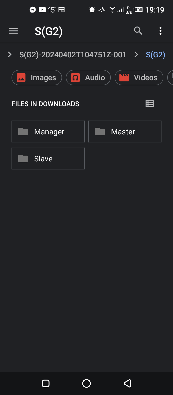

I exracted the zip file then i got this files in the picture

I'll be honest i've never used this method but I have seen the inverter go into update mode when you plug in a USB.
I would recommend you update in the order Master, Manager, Slave.
It is critical that the USB stick is formatted using fat16 or fat32 (nothing else will work)
Then on the usb stick you would create a folder called 'UPDATE'
And I imagine you then copy the entire 'Master' folder to the 'UPDATE' directory so you should now have '\UPDATE\MASTER\{firmware file]'
Double check the the firmware file in the MASTER directory has also been unzipped it should have a .HEX extension.
Plug the USB stick into the inverter and it should start the update - when complete remove the stick.
On your computer remove the 'MASTER' folder from '/UPDATE' and replace with the 'MANAGER' folder - repeat the process.
