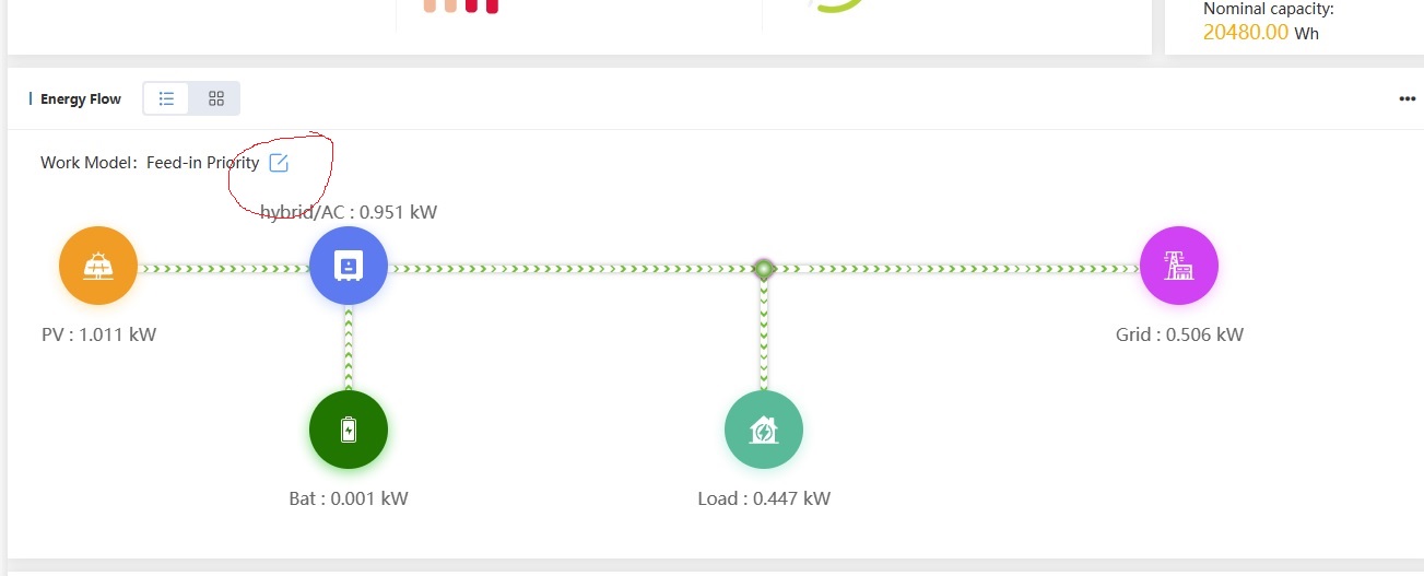

For what you are doing I would stick with the old charge periods, but if you want to find the schedules, on the foxesscloud web go to this screen and click the icon circled red.
If it comes up with this page you are fully up to date and can set schedules
If it doesn't it means that your firmware is slightly out of date (it's quite a new feature), and you can get that updated by a request to your installer or Fox service.
