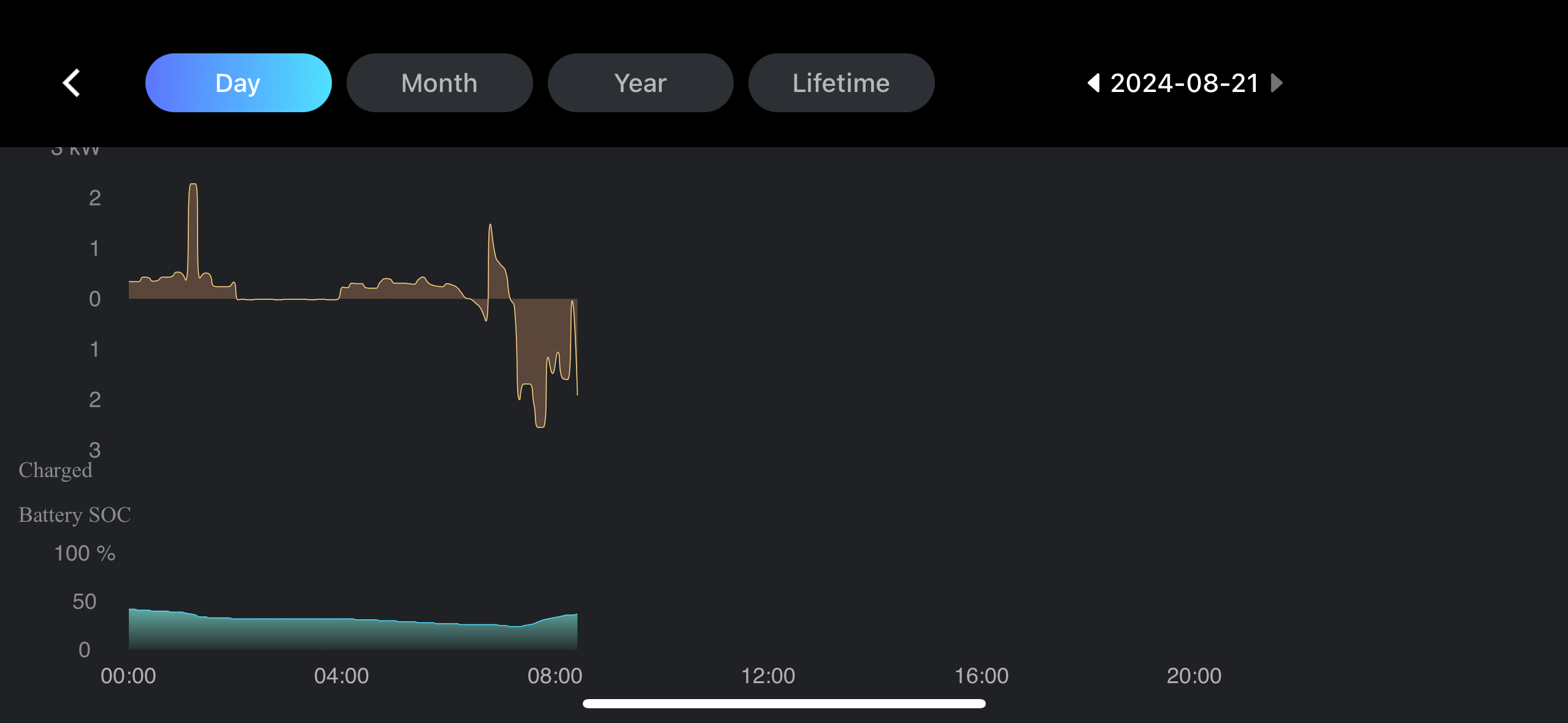

I tried to charge my batteries overnight for the first time last night, but it didn’t seem to work.
I set it to charge from 2-4 am. I can see from
the graph that the battery did stop discharging during that period (it just flatlines, and I appear to have switched to the grid) but the battery itself didn’t charge.
Any advice welcome! No doubt it’s user error on my part. Many thanks.

If it stopped discharging, it looks like you set a charge period but didn't toggle the charge from grid switch on.
I'm assuming you are using the older (simpler) charge periods - I would leave scheduler for another day, there are so many things that can go wrong with that.
So basically set a charge period from 02:00-04:00 but make sure you have 'Enable Charge from Grid' turned on.
You would normally have your minsoc's set at 10%
You can set it for just a few minutes to give it a quick test charge and prove it's working ok.
