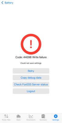

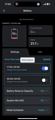

Batteries won’t charge
My setup is:
Fox ESS KH 9kW 1ph Hybrid Inverter inverter
3x Fox ESS EQ4800-M 4.66kWh Li-ion battery
Any help greatly appreciated!
- Posts: 1850
You have mode scheduler enabled, you can’t run the older charge periods at the same time as scheduler - if you disable the scheduler, charge periods will work again.
Alternatively if you are using scheduler, set a force charge schedule instead of using charge periods.
