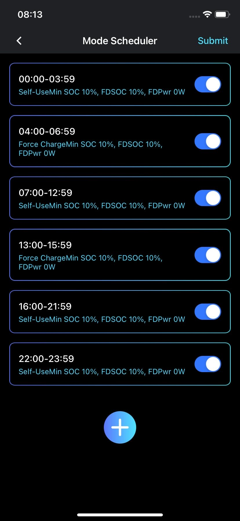

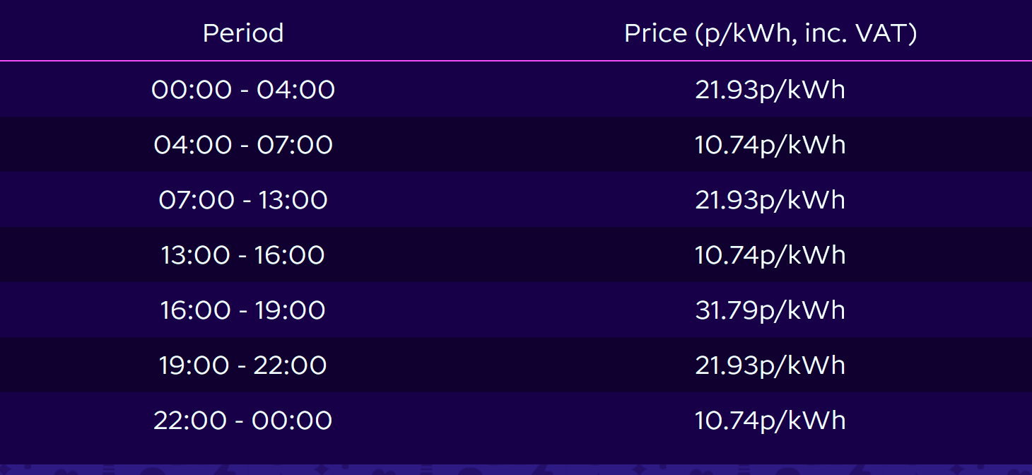

I am trying to match a mode scheduler to my energy tarif.
I want to force charge during the 10p times. Then proritse self use in the more expensive windows.

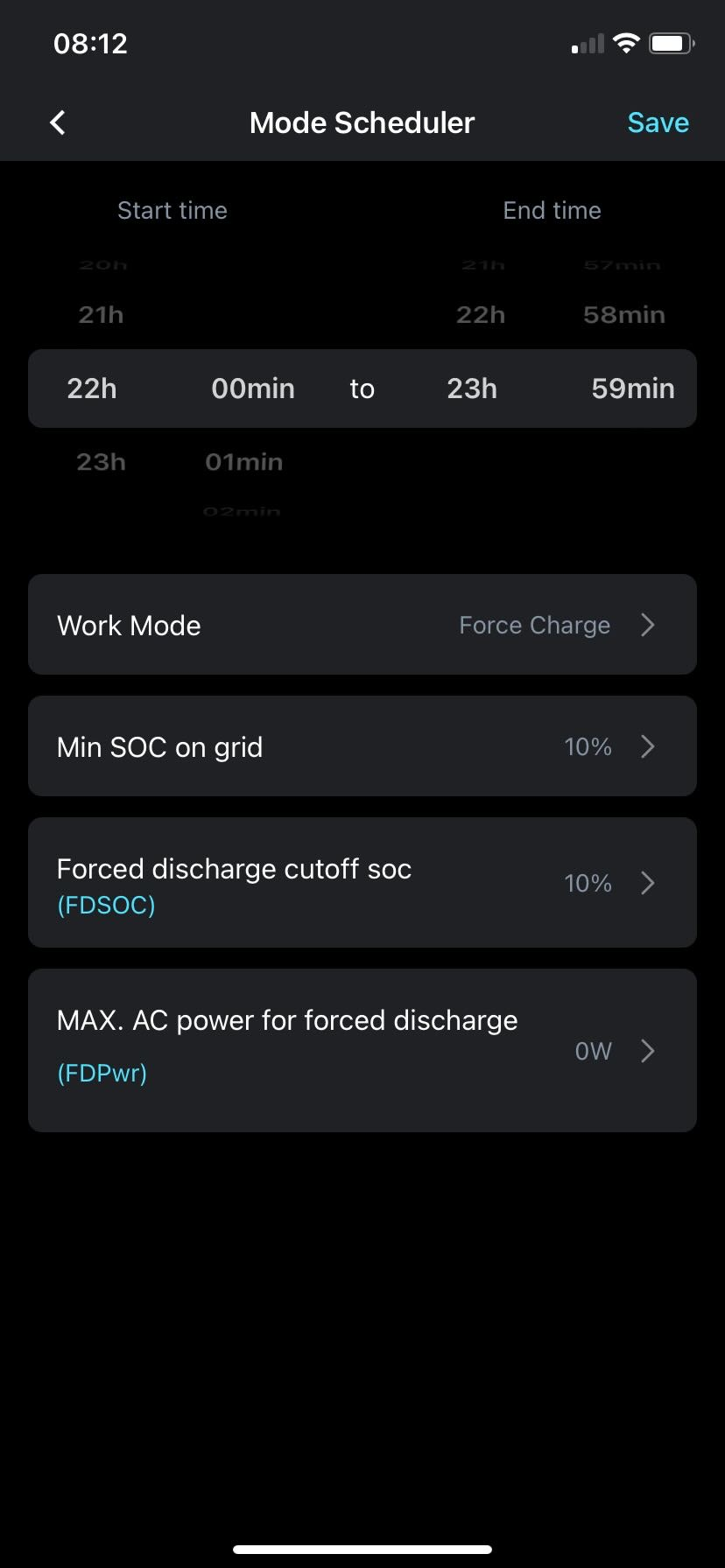

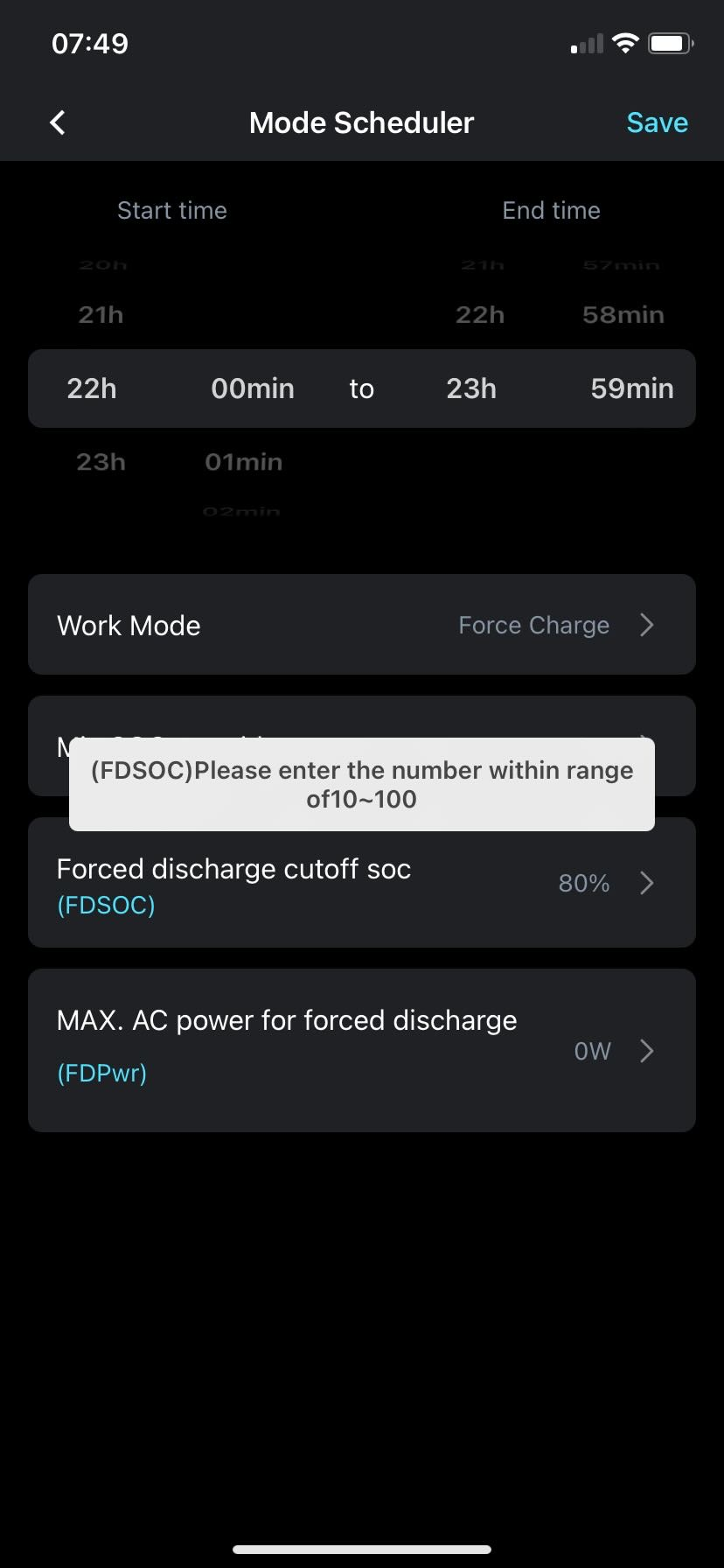

But I am getting an Error of (FDSOC) please enter the number within range of10-100 when i try and sort the last time period.
Posts: 1872
There have been a few problems with the scheduler as of late - it has to be set equal to or greater than your current minSoC but that looks ok - can I suggest you go to the Fox cloud website, edit and save the template there - hopefully that will work.
