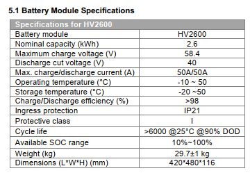

Thanks for replying - I would not mind so much it reducing the charge rate but stopping altogether and also letting the battery run down to 1% with no errors seems quite unreasonable. Given there is nothing in the manual to say the units stop working when freezing or advising mounting them in a warmer space, it is a serious failure for any UK install, in my view.

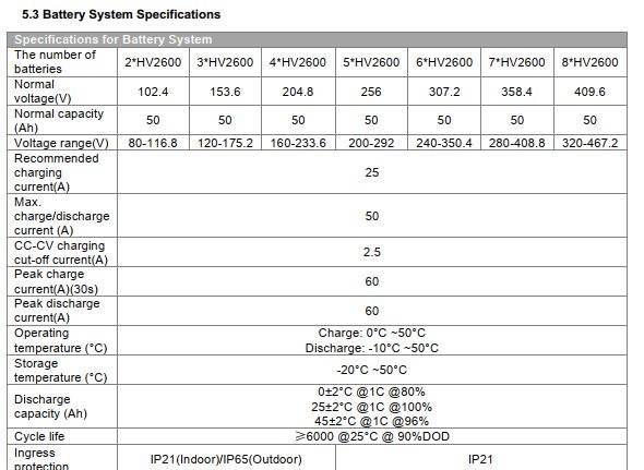

The manual makes no mention in the main text of these issues. It does state the Battery operating range is -10°C to +50°C although ominously in the System Spec that the operating range for charging is 0°C to +50°C, whilst discharging is -10°C to +50°C - what use might there be in the ability to draw energy at low temperatures but not be able to replace it without warming the battery ???

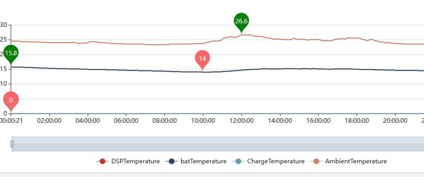

I've checked the database log of temperatures but they are all above 0°C unless they are clarly empty datapoints stuck at 0. Anyone by chance know what is operative in this respect ?
