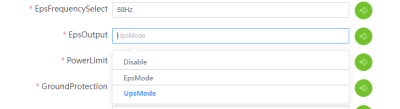

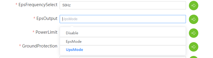

It isn’t normally live when grid is present - check a setting called UPS, this effectively enables the EPS output so it stays on regardless.

Correct, you need to make sure the eps port is set to EPS mode not UPS mode for it to only be powered during an outage.
