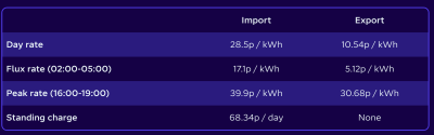

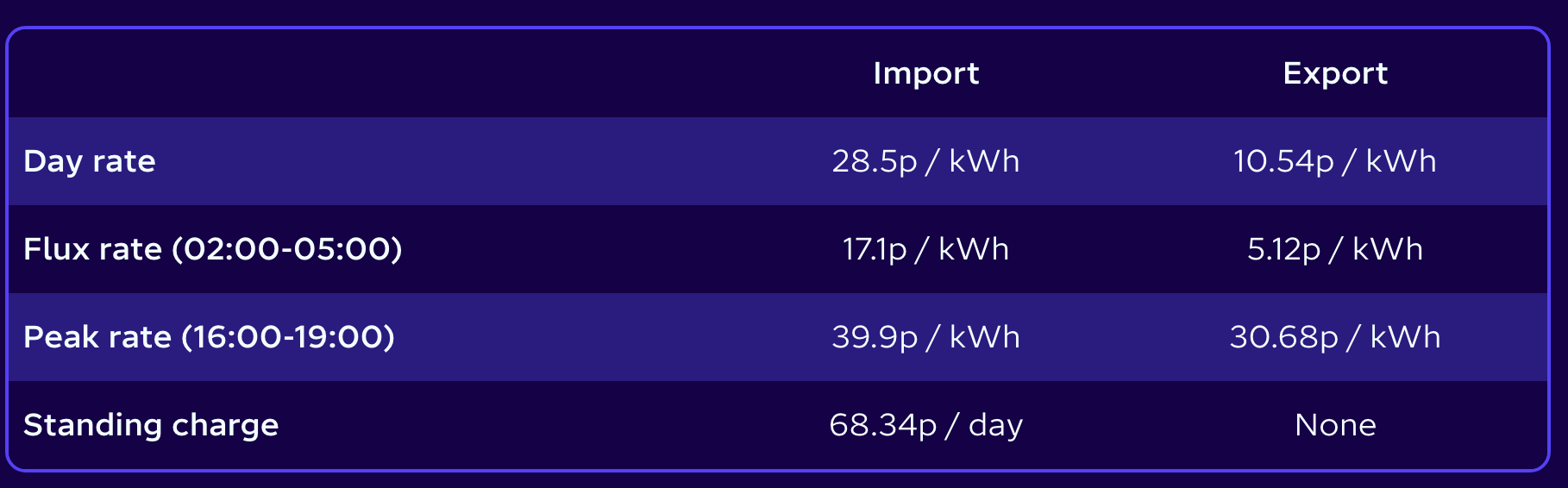

I am new to FoxCloud2. I would like some help with setting the work mode and mode schedules to optimise the benefits of the octopus flux tariff. This tariff has these rates:
Can someone explain how the work mode and schedules should be setup?
