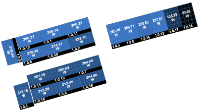

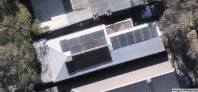

I have an existing SolarEdge system with SE6000H inverter and 20 panels with S440 optimisers. I am in NSW, Australia.

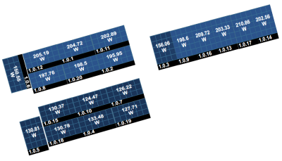

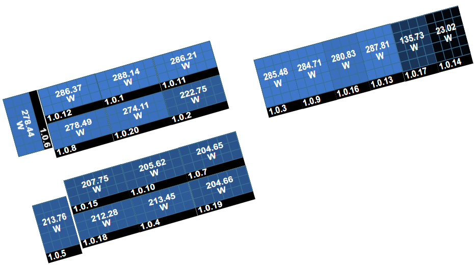

The optimisers are important as some panels are partly shaded at different times of the day. Example shown in the attached images where at 10am panel 14 is mostly shaded:
But at 2pm, panel 3 is shaded and panel 14 back to full sun.
It's a small roof almost entirely covered, so better placement was not an option.
