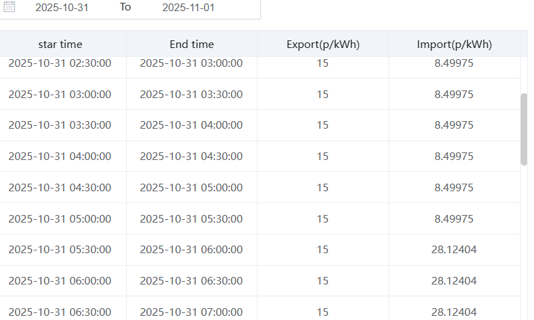

On an interesting note, the wording of the mode "Octopus Agile" is now not accurate, as it pulls down the pricing for your account.
I am with Octopus Go, and you can see the pricing for your region.
