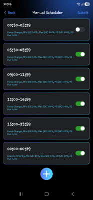

I am using Octopus Go tariff, so it's usually a very simple program to schedule. Set a charge at 00:30 until 05:30, and I had it hold SoC at 100% during this time, after this it would be in Feedin mode until 23:59. It was working fine until the 22nd October (no changes made by me) I then noticed that around 17:00 it decided to charge the battery to 100%
The last few days it has been doing the same each day, it would randomly begin charging battery or otherwise getting screwed up scheduling. Yesterday I powered the system down fully, and restarted it.
As Octopus gave us a nice bonus 3hrs of free electric today (25th Oct) I set a new schedule up to take advantage of this session.

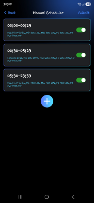

This is how I had set it the previous night (I had to recreate for screenshot)
I then checked this in the morning, to see that it had set every entry to force charge
After I had programmed it back to correct settings, upon checking it just over an hour later, it had charged battery back to 100% and modified values again

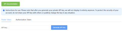

Just to confirm you're not using the FOX API key with other automation platform like Energy stats or home assistant?
Hi Will,
Thank you for replying.
The only API key I have used it the Octopus one, where I input this into Fox when I was on Agile tariff.
I don't recall ever making or seeing my Fox API key.
ETA: I have just logged into Fox to view my API key, it is blank... so I guess I never made one in the past.

Attached is screenshot from API screen, I presume this means I never have asked for one as it is not seen partially?

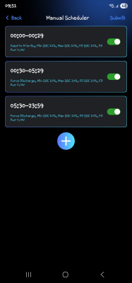

Sunday 26th October update.
I had set the scheduler to Octopus Go tariff yesterday evening, and shortly after midnight I had to set the 00:30 - 05:29 Charge window again, as it had swapped to discharge.
When I woke up and checked scheduler again in the morning, it had set itself Force Discharge in slots 2 & 3 of the scheduler as seen here

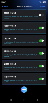

I then decided to try and remove the schedules via the foxesscloud website to see if this could make a difference (as I usually set via phone app.) I am trying this way to see if there is some bug in the phone app (for me) or maybe it "sticks" better if I set via the cloud website.
It kind of worked, as when I first checked on the phone afterwards, it had set the 3x schedule entries, but with some odd settings. At first when I looked on the phone, it had all 3x schedules set with FD SOC as 20%, and FD Pwr as 100.0 W.
I corrected these values, to what I think should be correct, and have this now saved.
EDIT: I left the phone app for about 1hr, and when I checked, it had swapped the 00:30 - 05:29 Charge to Discharge again.
