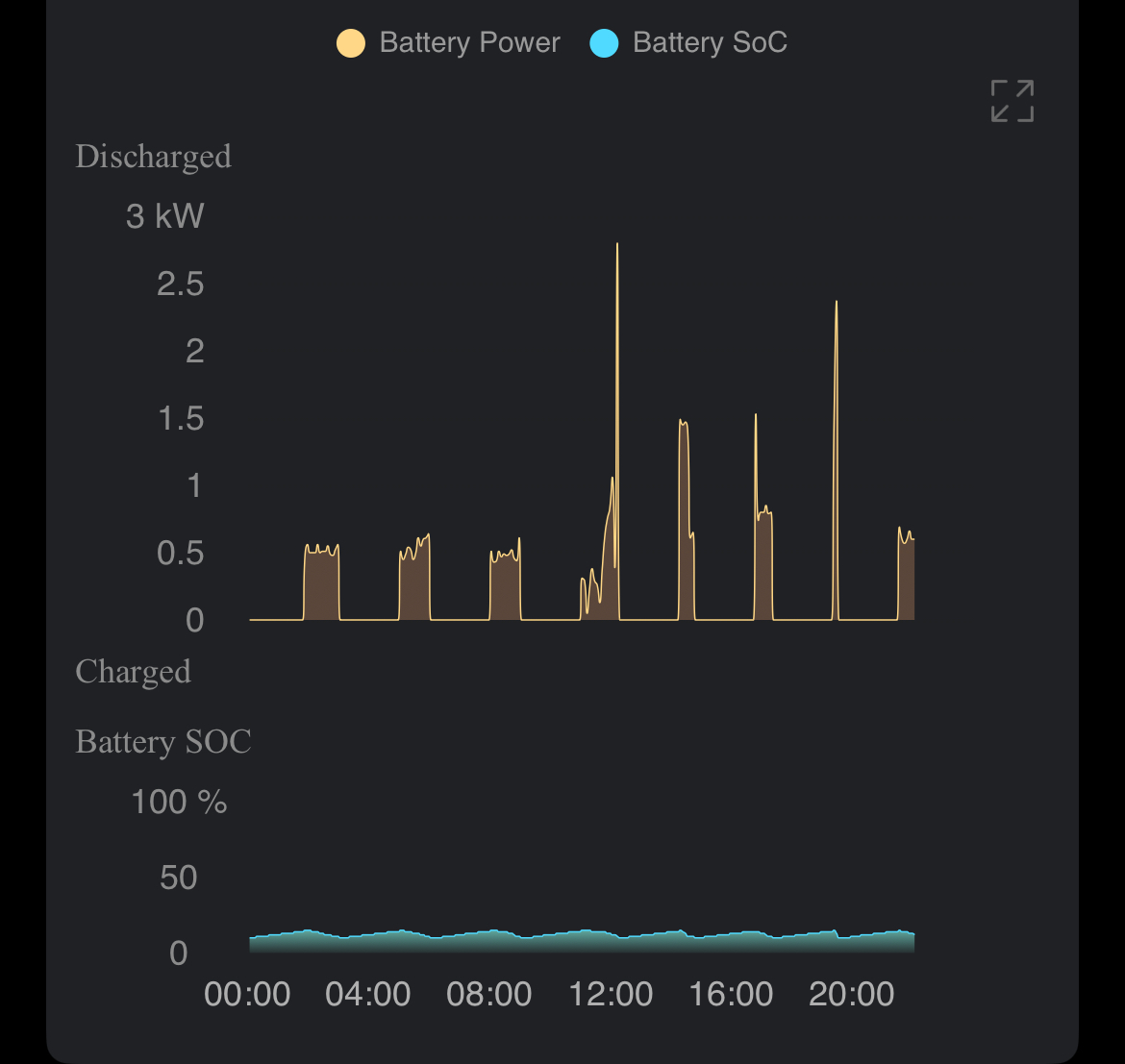

Over the last couple of days, I've been watching the battery behaviour particularly when at minimum SoC (which I've left as 10%).
First observation is that there's a sort of SoC oscillation where (despite zero charging taking place) the SoC recovers from 10% up to 14-15% and then discharges again. Please see my attached screenshot. Is this normal? Is the BMS algorithm just "settling" a little?

Your inverter maintains itself by drawing power from the DC circuits i.e. PV/Battery there is a constant trickle of power to maintain inverter / BMS and batteries, the scale of this usually relates to the number of phases and size of the inverter but a typical inverter will take around 100 watts to maintain itself.
As the battery powers the house it will fall towards minSoC and the battery discharge will include the 'parasitical' loss mentioned above, however when the battery reaches minSoC the inverter will initiate a maintenance charge to stop the drain pushing the battery below minSoC.
The maintenance charge is at 5A DC (so with EP11 that's approx 1.7kW) and you will see the battery charge back above minSoC usually by a few % and then it will cycle like that until you either charge the battery from grid or solar.
The battery performs some balancing at the bottom and so a battery that is new needs a few minSoC -> 100% cycles before the BMS has trained itself on the actual limits of the battery, if you haven't done a 100% charge yet you may see SoC jumps and pauses in the charging / discharging where the BMS is balancing the cells within the battery pack.
On the 100% battery charge, yes this is advised to be done at least once a month for the cell balancing reasons I mentioned, if you don't the battery SoC accuracy will get worse over time and it may not provide the full capacity you expect and you'll see jumps in SoC as it re-assesses the inter cell voltage balance.
If you have a low tariff it is always advisable at this time of year (assuming you are UK?) when solar isn't as strong to make sure that the battery is charged occasionally from the grid using a low tariff, that ensures you don't pay the higher tariff and avoids the battery maintenance charging when it reaches minSoC which may be at the higher tariff.

That's interesting, and makes total sense. I have a clamp meter and will take some current measurements to confirm that here. The observations I made were during a period with no activity in the house (obviously the occasional fridge compressor starting etc). I'm quite certain the 300W was constant, but it does seem to track with the charging/discharging cycle I described.

One further frustration with this "maintenance charge" behaviour is that the accounting in the Cloud doesn't capture the charging energy at all, so data in the cloud and in Home Assistant appears to show the battery generating "free" electricity that skews charts.
As the SoC rises from 10% to ~16%, there's no change in the "Bat Charge" series in HA or any negative values for "Batt Power" in the FoxESS Cloud charts. But on the *discharge* side of the cycle, you see the "Bat Discharge" series increase...

Well I could be wrong, but my initial thought the other day could be cell temperatures.
I charge to 100% each night, after 05:30 the battery will then support house loads, so by around 09:00 it might be sat around 96%. Sometimes, after say an hour, the SoC might have gone up to 97% as the day warms up, before it begins to drop as we use the battery.
Again, it depends on the day, but it could be on 98% and then it will go up to 100%
I don't worry about this, it is either pulling a little power or it's just cell temps increasing a little as the day progresses.
