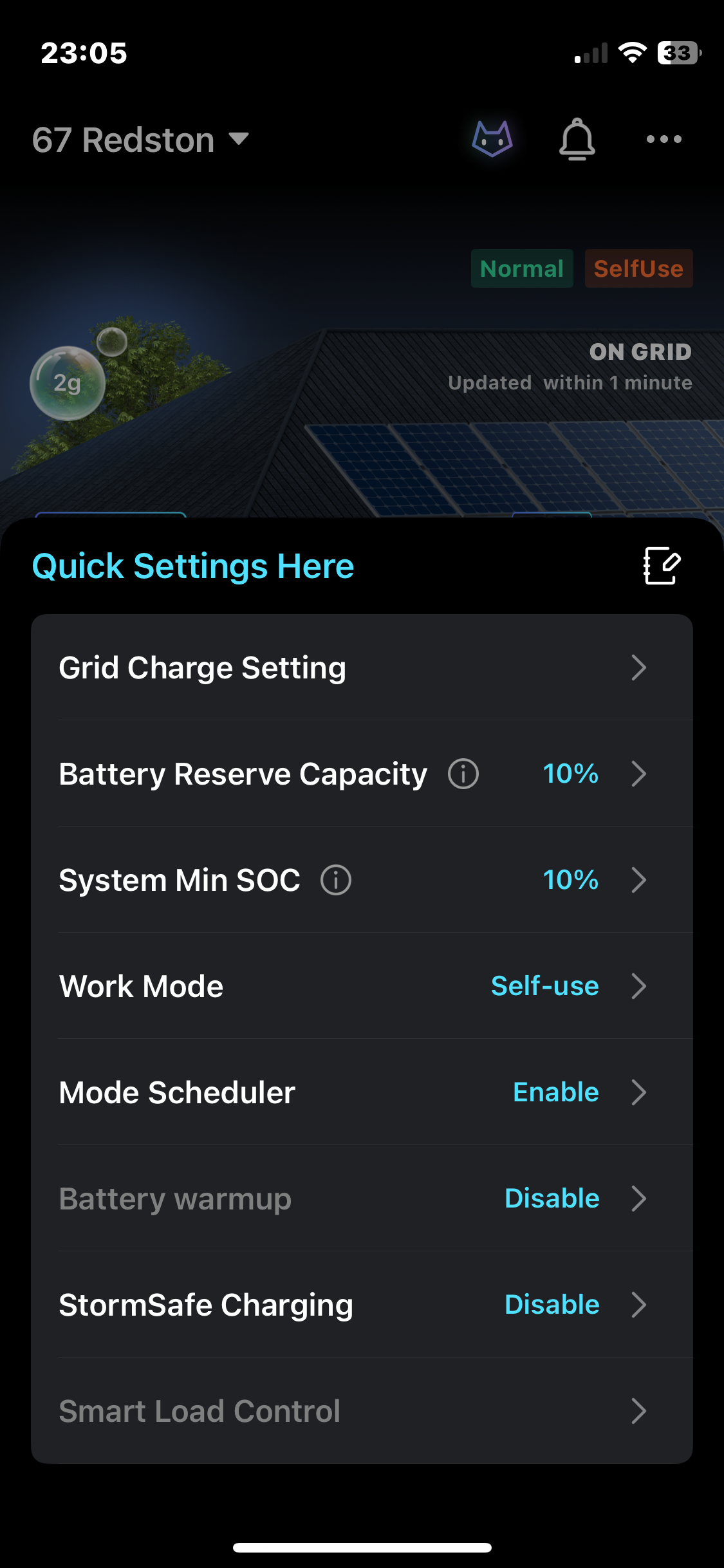

My problem with the App :
Under quick settings “grid charge setting” will not save.
Installer set it up remotely simply under "Mode schedule” to charge battery from grid between 2 am and 5 am to charge to a maximum of 100%.
Early this morning I found my battery to be at 10%, it was not charging, so I start the day on grid.
My installer has remotely set the mode scheduler, to charge the battery 2 to 5 am, and a Second command discharge back to the grid at peak time in the afternoon.
I have yet to see if this sticks today bearing in mind the winter sun may not get my PV to charge the battery up sufficiently, for a 4 pm discharge.
Bearing in mind the ’Note’ warning this setting will override Mode scheduler it seems to me "Grid charge setting” is not a necessary function at all. Instead we just use the mode schedule. What’s your View?

Do you have picture of your quick settings page / grid charge and mode scheduler for us?
Information is key to helping out.
Re: App Grid charge setting - “write fail"

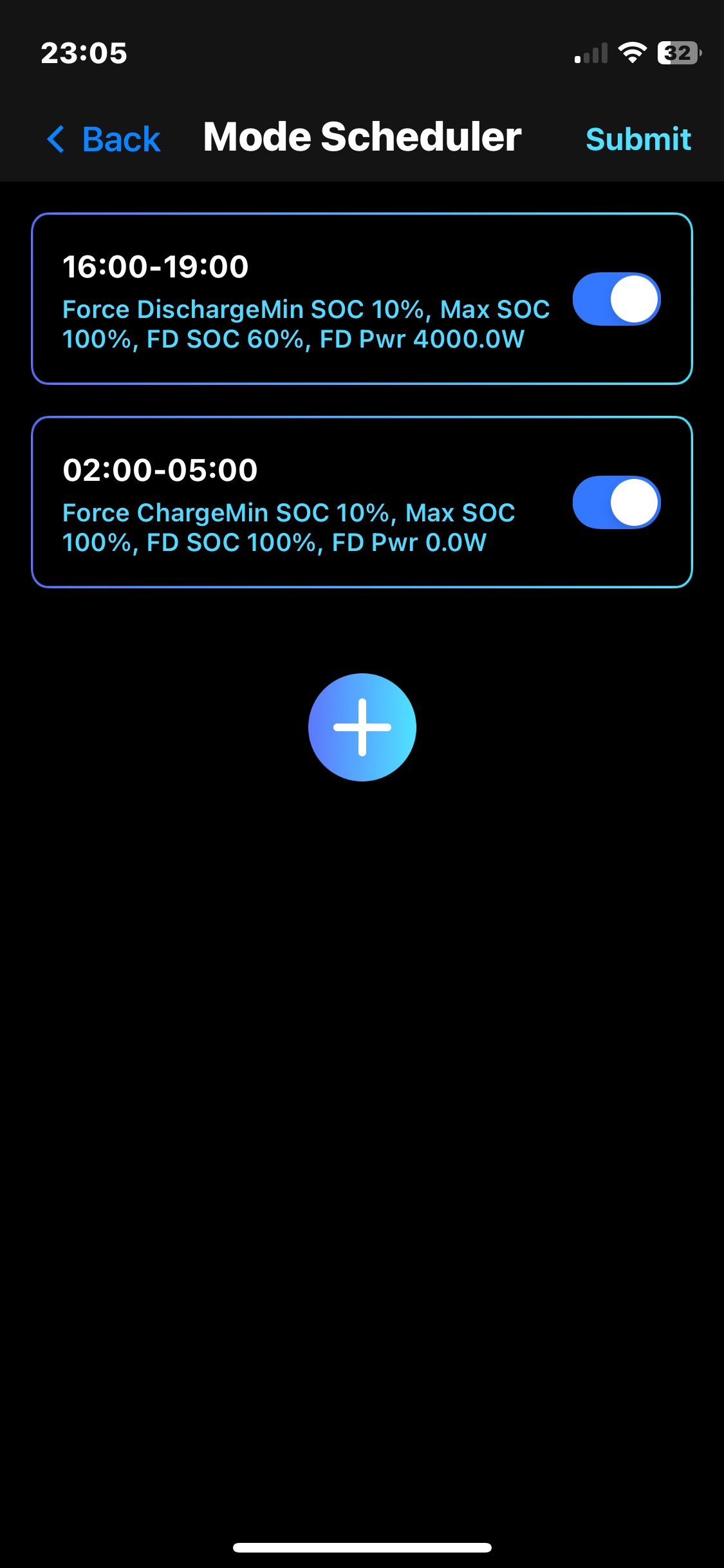

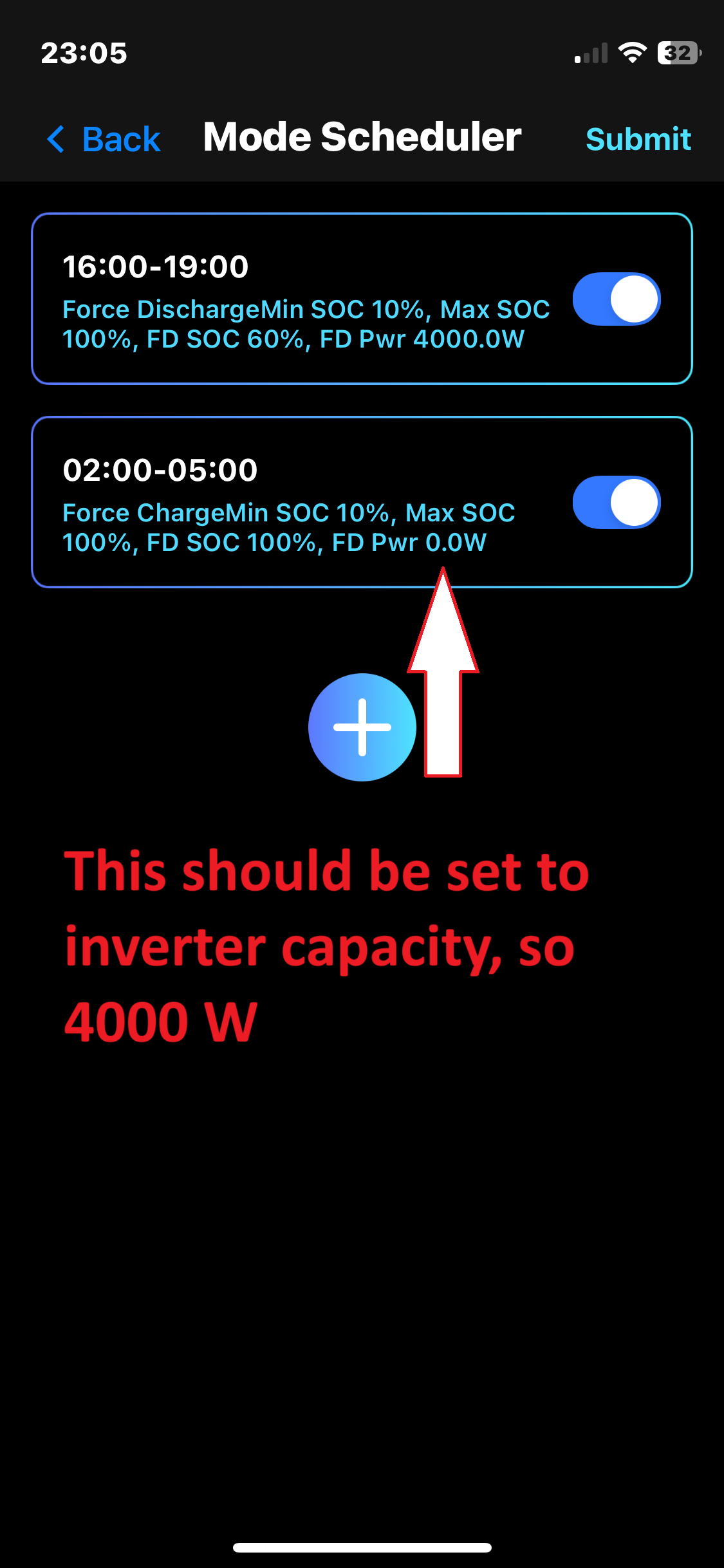

With the help of the installer this afternoon once again we set the mode scheduler to discharge to the grid at peak times 16:00 - 19:00, input was accepted - see picture. Exactly the opposite is what happened, battery was charging from the grid instead. Hence, paying peak rate to charge. In short, so far the app has done nothing right, resulting in me not saving money but quite the opposite.
Here are three screenshots .
Cheers

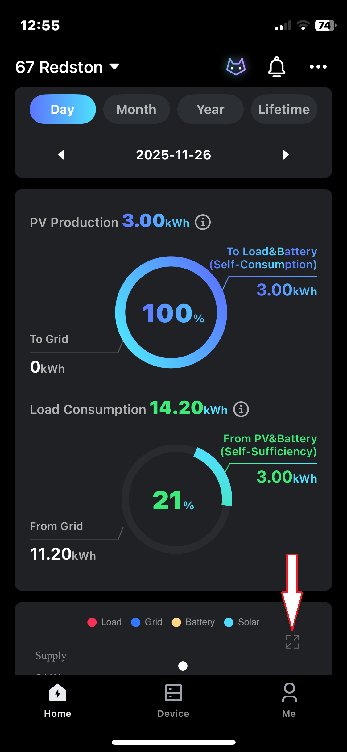

Can you post the graph for that same period so we can see the effect (swipe left on the home page, select the day and the graph is towards the bottom) - also if you could screen shot the home page (with the house on it) that shows the power flows please.

Just some advice for you.
During the discharge period, you have FD SoC at 60%, this will stop the discharge of the battery if you was pulling it down from 100%. So you will only drain 40% out to the grid for export. One other caution would be, if the battery was at 50% at the start of this period it would actually PULL power from the grid to bring it to the FD SoC of 60%.
In your charge period, you should set the power from 0W to 4000W, as it doesn't like the 0W settings.
I could be wrong on above points, but I am sure someone more expert can confirm this is right.
And if you can post up picture that Dave has requested, it can show what the battery is doing.
You could also test yourself if you say put electric oven on full with door open, and capture an image of your graph at this time (10 mins should suffice) This will show if the CT Clamps are running in the correct direction and the inverter can see the flow of power correctly.

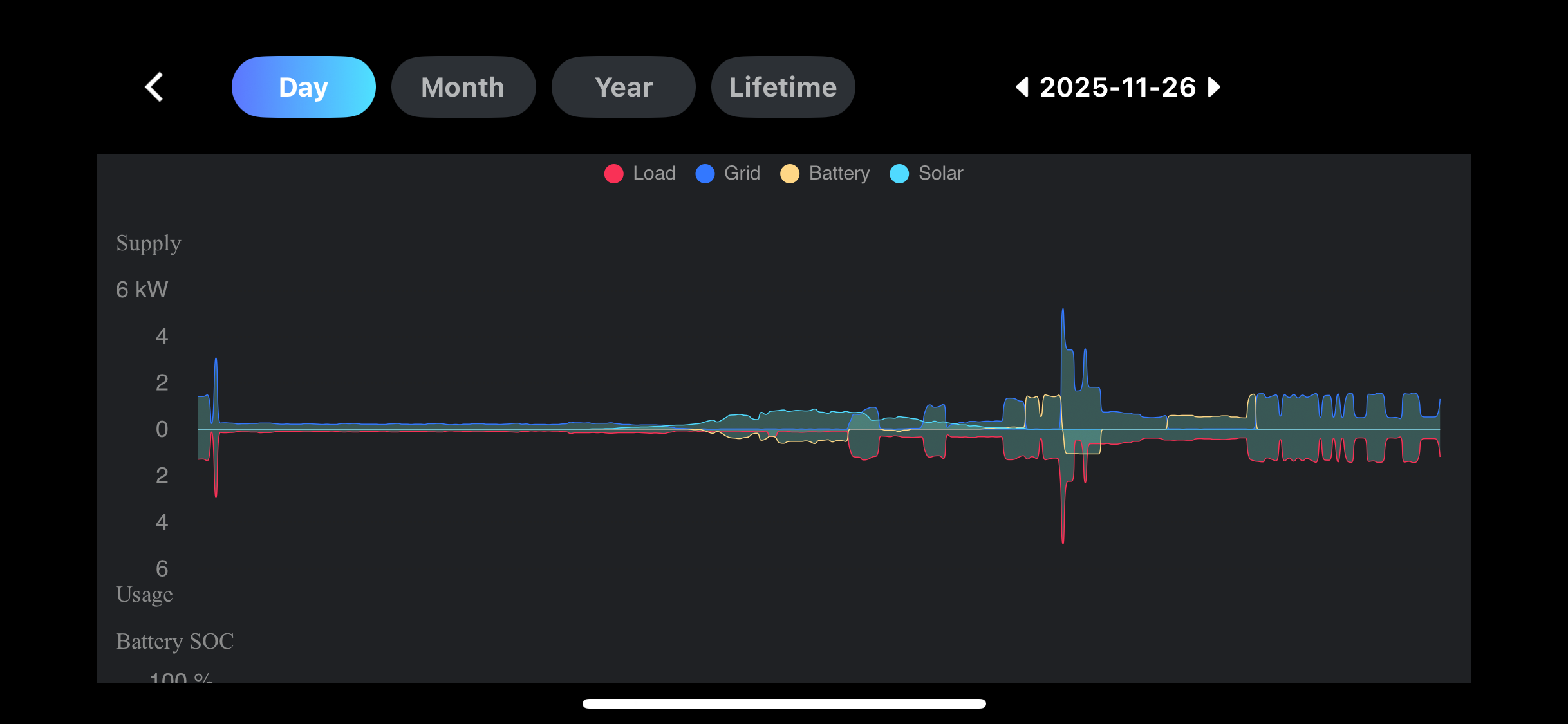

Is this what you mean (graph)?
Since installation the battery has never been charged up, it's never been to 100%, in fact not even 60%!

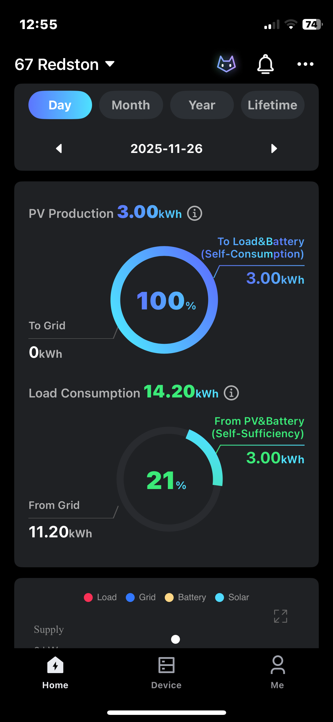

Click please the Square Icon to the right of the 4x coloured dots, Dave is asking for a picture of your power distribution
It will look like a graph when you see it.

Ah yes, I didn't think you to call that a graph.
I think this is what you're looking for

Couple of other thoughts……. Man, I don't understand this!
Referring to your theory regarding minimum SOC and your FD SOC. Surely maximum SOC of 100% would permit it to charge fully?
It seems logical to set :
Minimum SOC 10%
FD SOC. 60% (in order to sell back 40%. Keeping the remaining 60% for self consumption during the evening)
But off peak it didn't pull power from the grid up to 40 or 60%.
During EXPORT period should it draw any more than specified Minimum SOC 10%?
During IMPORT period surely it should charge up to 100%?
With the battery at 10% why is it not importing early morning at all?(surely it should import up to SOC 100%?).

Quick reply,
It looks like from your graph that everying is in order, the solar is producing and was feeding battery (charging)
The system was charging and discharging also, just not quite how you was expecting, this is solved by setting correct scheduler.
You are best to setup a full 24hrs of scheduler leaving no gaps, because what can happen is the last values "stick" so if you set say a 60% FD SoC value, after the time period has finished, the system will hold this value still. So it won't change this until your next timed event.
The 0 - 4000W I mentioned earlier, this is how the system decides on how much energy to import/export. So previously the 0W meant "Max" that the system can produce, now the value is literal, so leaving this at 0W means that it won't produce anything (at least this is how some systems are now behaving)

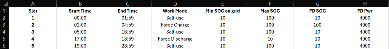

A can of worms has been opened indeed.
Grid Charge is for real basic operation, and limited to charging. We need it more advanced, so we are in full control.
I would go to your manual scheduler, and erase the existing two you have, swipe finger to the left on each and a Delete option appears. Once both are gone, you can start to add in the schedules by hand.
This below is my quick, rough 24hrs scheduler for you... now there are caveats and I could have some input numbers wrong.
I am assuming that outside of the discharge hours that you wish to use battery to cover the house load (save peak purchase) and that you are going to dump all of your battery in the export period... note that if you do try to reservere battery for evening, set G5 FD SOC to what percentage you wish to save for evening house load... also with the caveat that you may import energy in that time slot once the battery hits this reserve.

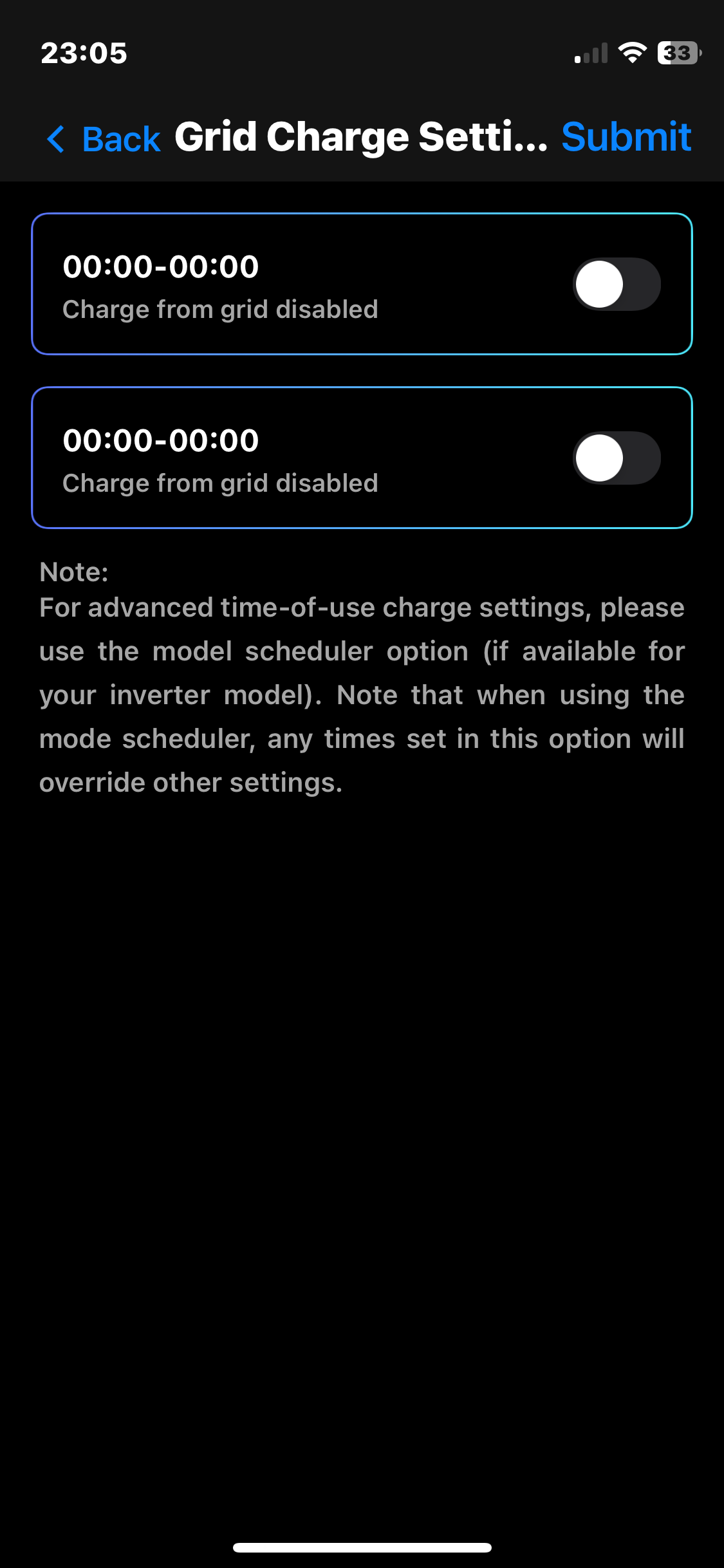

Question still remains, in quick settings, are grid charge settings any use at all?
In the app on this page there is confusing note - it ends saying : “When using the mode scheduler, any time set in “this" option will override other settings.
There are two ways of reading this. I have debated this with the installer.
Is “this option” referring to Grid charge setting (seems more likely)
Or Mode scheduler.
My view is “grid charge setting" appears to be for the user to override the mode scheduler. Installer doesn't agree with me?

You are correct to move away from Grid Charge setting, as this will only ever allow charge and no discharge.
Thanks go to RussJH for sending you are more direct video to watch, I linked you to all the videos to browse through (highly informational) So you hopefully have this bookmarked to look at in future.
My only connection to Fox, is getting my own solar/battery back in tail end of February. It was a bit of a learning curve, along with learning the little interesting bugs along the way. I had a very strange one, where all of the settings in the scheduler were getting scrambled, turns out letting my adult son view the system on his phone would scramble things up.
I learned a lot myself, by making a setting change and making observations, when it did work or didn't work, I would make another change and see what happens.
Best of luck, and hopefully you have or will tame your system soon.
