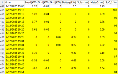

I'm trying to understand is how did my battery, last night at 19:10 02/12/2025, go from 100%SOC to 84% when according to these logs, hardly anything being exported or imported - see top attachement

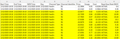

Comparing the log file with what actually got exported to Amber (see bottom image), clearly some data never made it to the log file
has anyone experience log file issues on 02Dec2025 and how can this be explained?

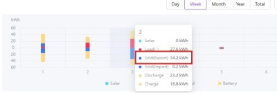

My issue is that the log file that I exported from FOX Cloud V2 for Wed 02Dec2025 (see attached PLANTaee0b39c-db9d-4968-95f8-cab118853f3d_20251202_27.zip) is inaccurate and doesn't even lineup with FOX Cloud V2 satistical graph (see Cloud Usage Graph.jpg)
According to the export log file, I exported 28.32KW to the grid.
Yet the Fox Cloud usage graph and Amber data show that I exported 34.2KW to the grid
I know the graph data is correct because it lines up with what Amber has recorded.
I was hoping that by raising this issue, someone from Fox would review the data and explain/fix the inaccuracy
