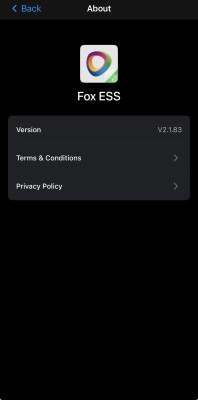

Firmware version of the app included for reference.

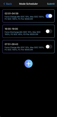

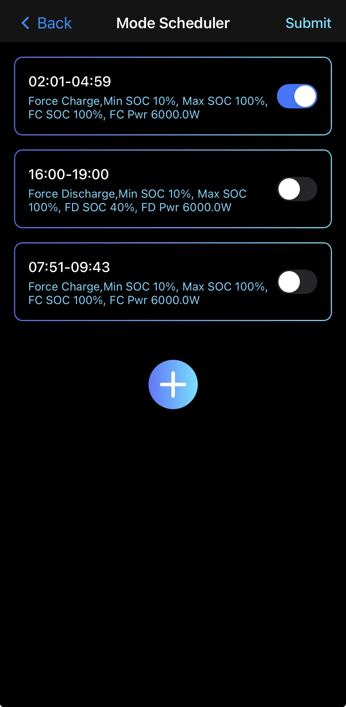

Can you post a photo of your schedule so we can confirm it's set correctly?
Re: Mode scheduler problems
We just have the one charging period in use at the moment for cheap rate charge overnight. It has worked for a week since the firmware update. We haven’t changed any settings since, only viewed the data in the app.
I remember seeing your scheduler from previous thread, it all looked ok then, as it does now.
Hopefully the installer support ticket will show what is happening.
