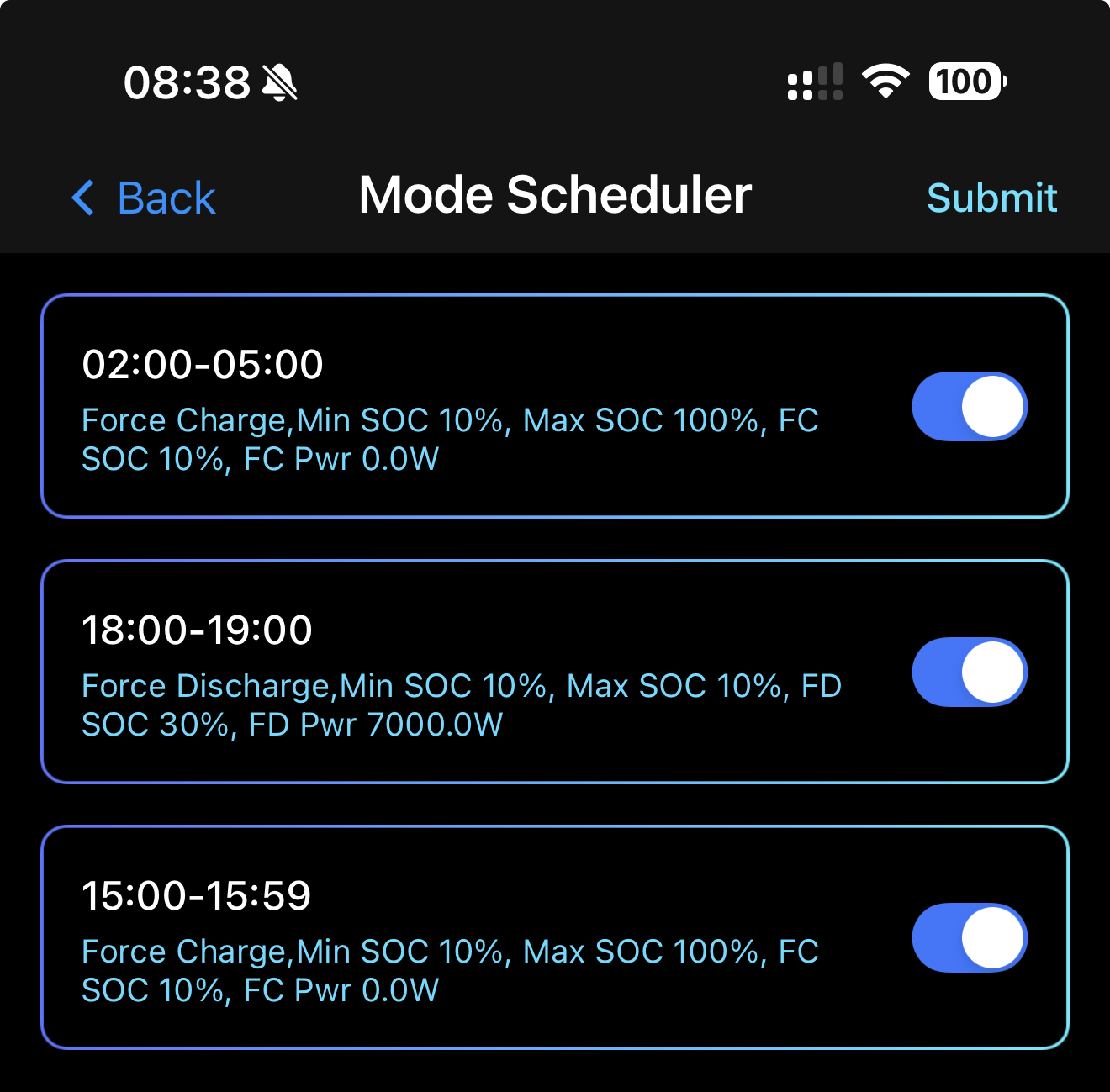

I’m using the octopus import/export plan and looking to time both my car charging and battery charging to occur at the cheapest time (currently 02:00 - 05:00). I’m using the mode schedule for the house battery to charge over night and to discharge if >30% back to the grid during the peak export time - this is working. Unfortunately I cannot get the schedule function in the EV charger to work. I read somewhere that if you use the mode schedule, the schedule function does not work. Is that also true for the EV charger?
Advice very welcome.
Below is my current mode schedule:

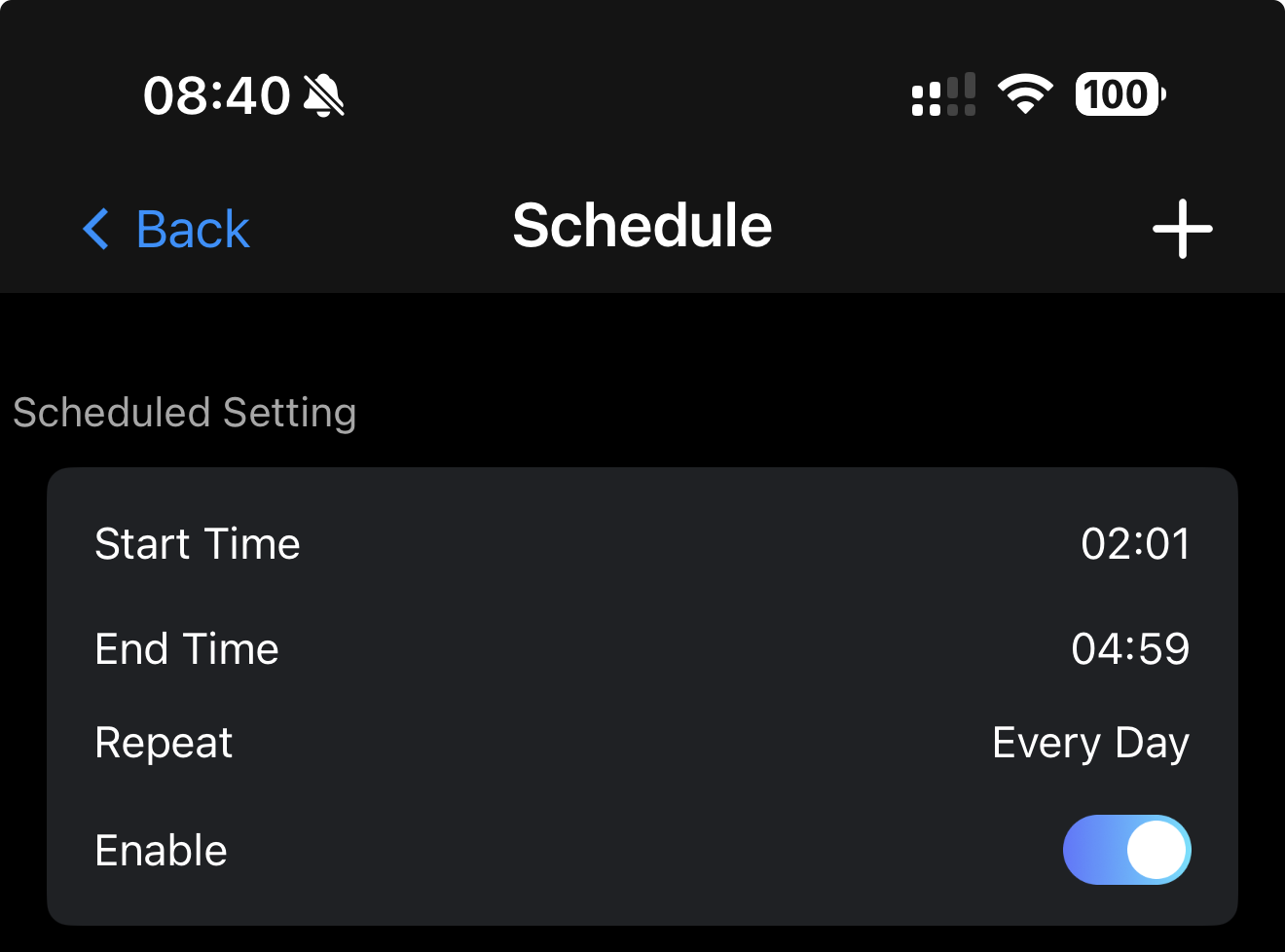

Below is my EV charger schedule:

The charger is a fox charger - I believe the L model. The car is an id.buzz.
I’m going to try to get the car to schedule rather than the fox software to see if I can get the desired effect of both car and home battery charging at the cheap rates.

I’ve still not got the foxess software to control the schedule for the EV charger. However I have managed to achieve what I want by timing the charge from the car software instead..
I’d like to understand what the expected behaviour is of the platform. This is my observation:
1. Set the schedule
2. Plug in the car
3. If I press start charging - the Ev charger immediately starts to charge (is that expected?)
4. If I don’t press start charge, the car does not charge at all.
