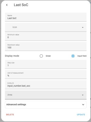

Last SoC - used to record last soc state and only update when state changes, set as follows -

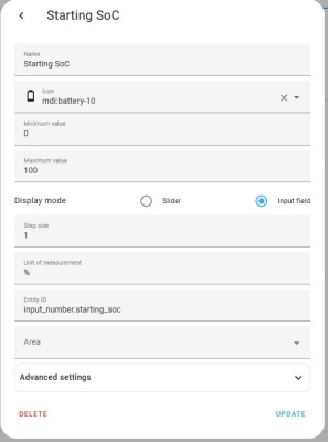

Starting SoC - used to record the starting position of SoC and is used as the divisor by the calculation, set as follows -

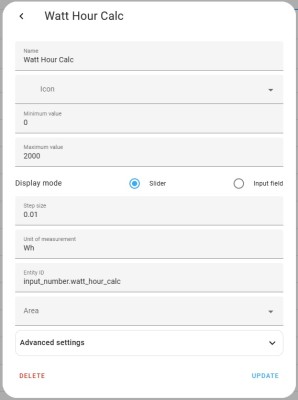

Watt hour calc - the sensor that holds the currently calculated watt hour usage, set as follows -

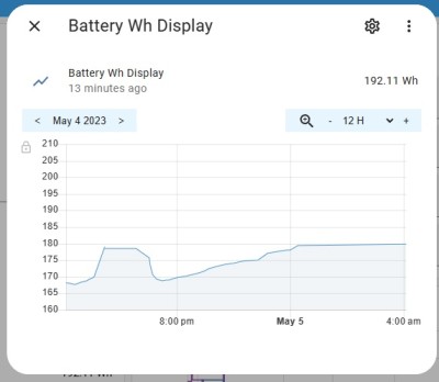

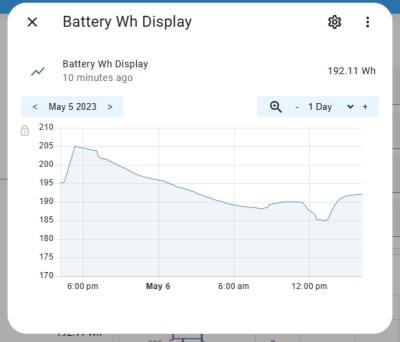

The results look something like this over 24 and 12 hours ( for a 7 pack system ~ 180wh / % expected ) -
