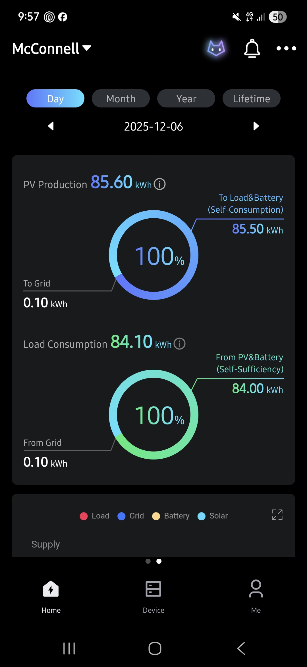

Curious if you can open your Fox Cloud 2.0 App, swipe left to get the circle charts and set your date to 6th Dec, send a picture of that, and the energy graph from below also.

MaterialBarracuda48 wrote: Tue Jan 20, 2026 9:26 am Curious if you can open your Fox Cloud 2.0 App, swipe left to get the circle charts and set your date to 6th Dec, send a picture of that, and the energy graph from below also.
Screenshot attached of 6 Dec 25, the day after battery install.
