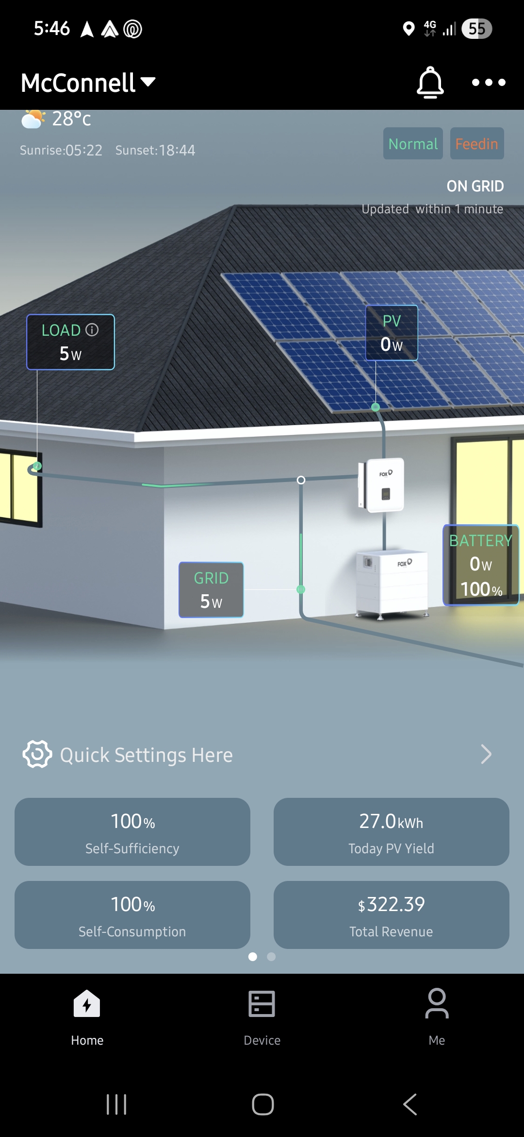

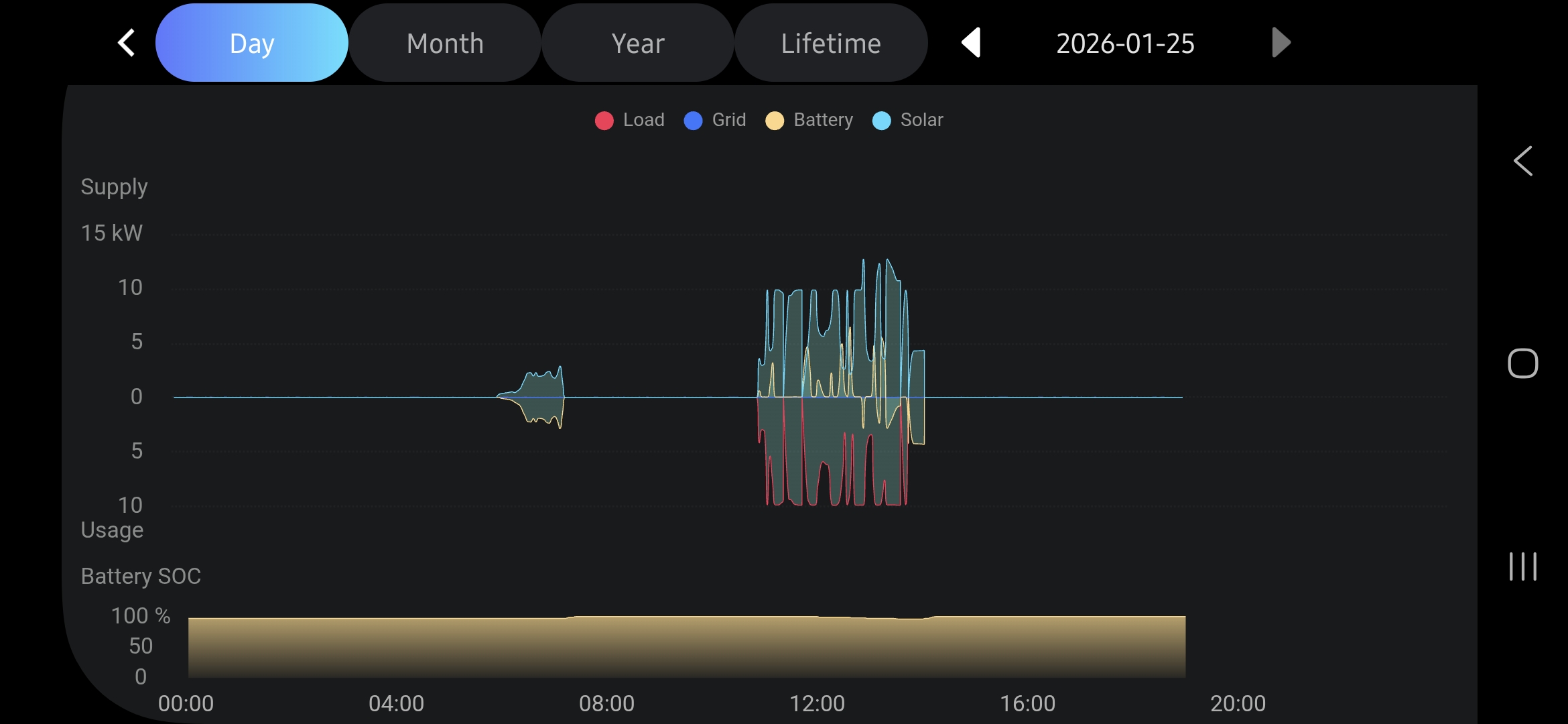

Attached is a screen shot of the schedule to ForceDiacharge, however the entire system seems to show nil.
I have 3 x AC running so load should reflect this, but it isn't.

If you have had a significant load running for longer than 5 minutes (the data sample interval) and it is not showing that load then there is something wrong with your CT (or meter) placement.
Can you swipe left and post the image of the graph at the bottom of the screen that shows load, solar, battery, grid etc.. - need to know if your system is ever showing load - if it isn’t the battery will never be used.

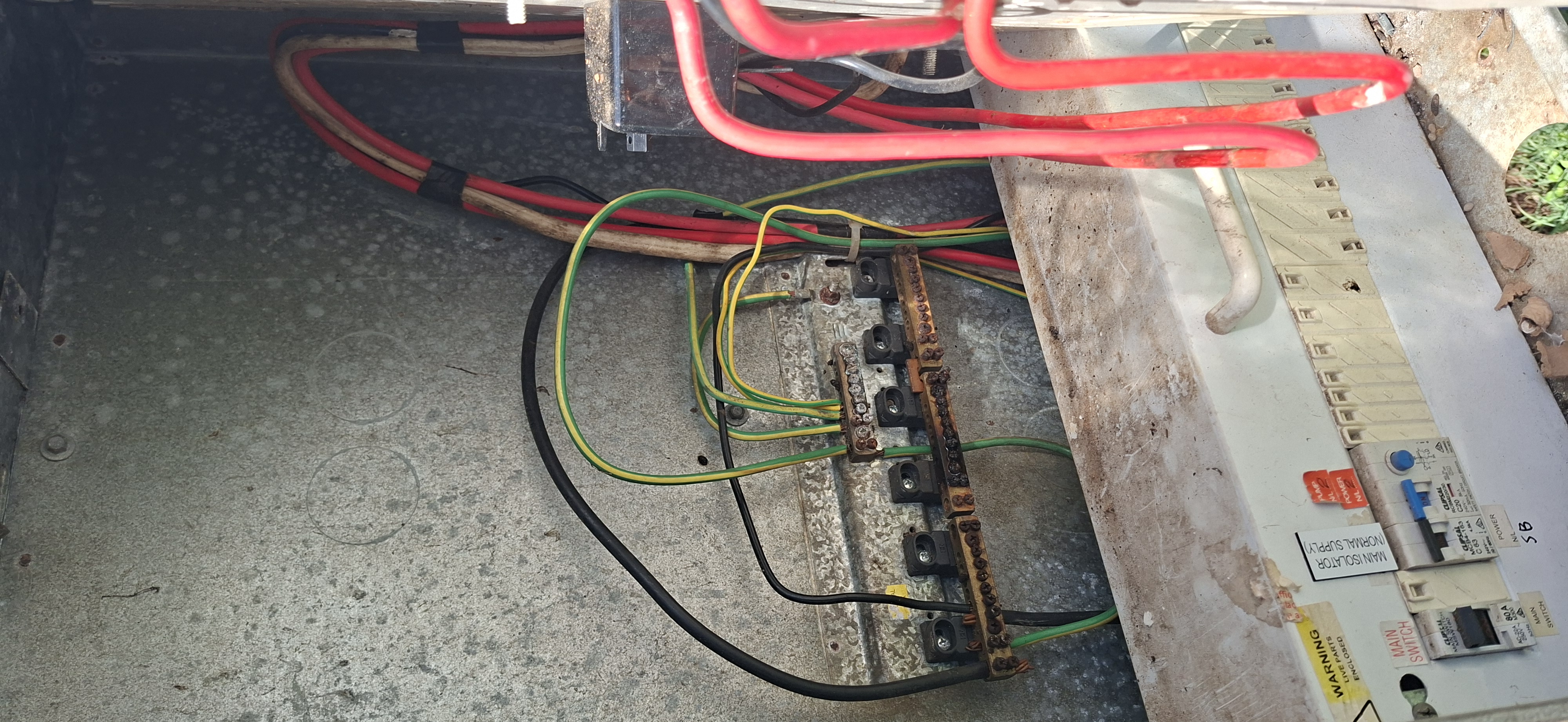

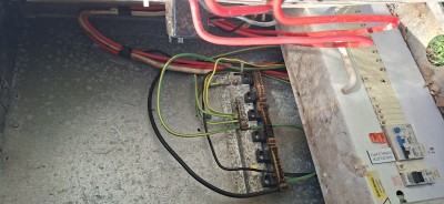

You should open up you incoming supply to your property and look for a CT Clamp there.
If you can find it, please take a picture and supply this.

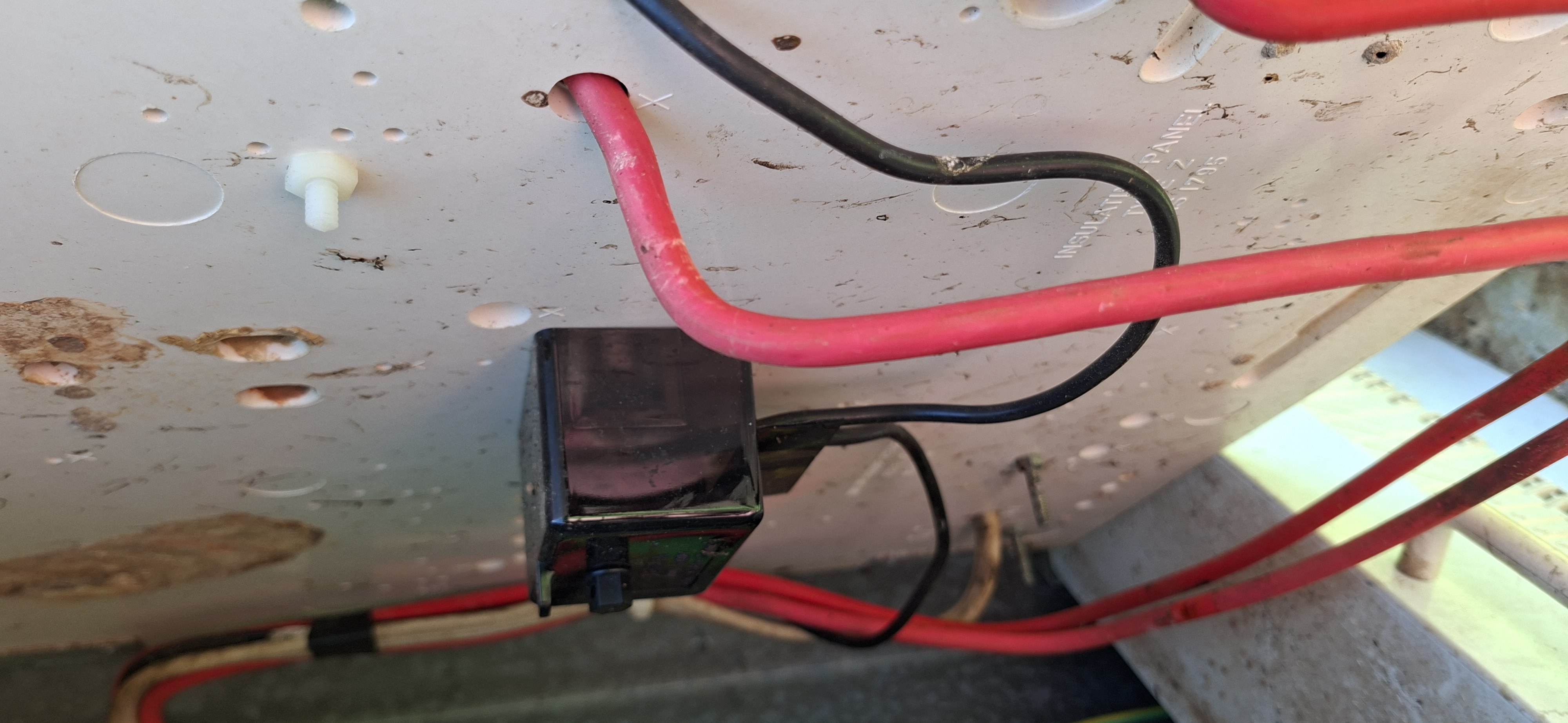

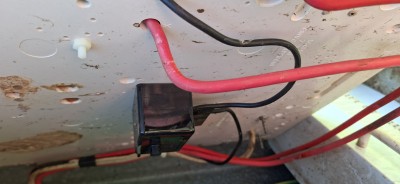

Couldn't see any CT clamp anywhere.
Unless this mounted black thing in the 2nd photo is it?
Re: Battery still not ForceDischarging on Scheduler
I am not sure what that is there either, if you can find your meter, that is where the CT Clamp is often placed here in the UK to measure the total house load.

I assume that black box with Tesla is a CT Clamp.
