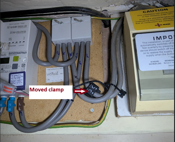

We have 10 PV panels connected to an EP11 battery via an H1-G2 inverter installed in April and have been really happy with the system. We had a Ohme Home Pro EV charging point installed on Monday and ever since the app and inverter from panel have been reporting a CODE-3 Ground Fault that hasn't cleared down by a power off reset of the inverter/battery.
None of the RCD trips appear to be flipped and all the home electrics including the charging point appear to be working as expected, except the PV no longer charges the battery, so I've set a forced time charge to add some overnight energy (we're on Octopus Intelligent Go)
I am hoping the electrician is able to get back to check the connections sometime today, would be useful to know if there are any "gotchas" to look for - added some pictures of what the install looks like if that helps.

Hi Dave , thanks for the reply, no changes other than installing the EV charger on Monday, after which the errors begain to show. Seems more than coincidental as they are both wired to the PV consumer unit :?
Will do as suggested and get the electrician back with a tester to see if can find any loose connections.

Took a couple of days but after conversations between the electrician and the EV company (Fresh Solar) it confirmed no ground fault was present anywhere on the EV charging installation (new breaker and cabling added next to the existing PV feed in the fusebox) or existing wiring. Chris, our very helpful PV installer at Fresh was out on another job but still made time to have a video call to check settings etc then suggested the power on reset procedure.
It seems that having not switched the battery and inverter off prior to the charger installation, the power off at the consumer unit may have tricked the system into seeing the failure as a ground fault, though why this didn't clear itself when power was turned on or why we couldn't reset via the app wasn't obvious.
