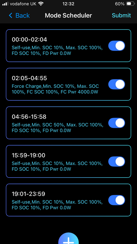

Which scheduler settings do I need to use so that I can get the following:
02:00-05:00 = Charge from grid
05:00-16:00 = Self-use (but batteries only being used up to say 50% - so that we keep enough battery to run through 16:00-19:00 peak period. meaning if we did use a lot before 16:00, we'd go to grid usage)
16:00-19:00 = Self-use battery up to 10%soc
(Rest of the time = self use)
I tried to schedule the following periods but may have overcomplicated matters as I got an error code of '40257 parameters don't meet expectations'
Any help really appreciated
