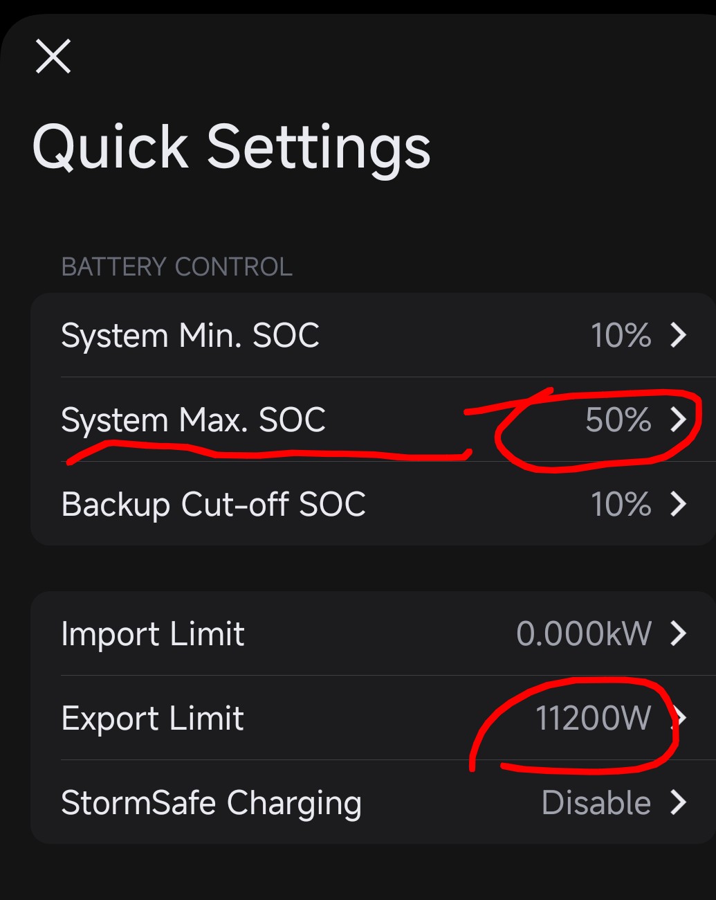

In the new app version 2.2 I noticed that the menu system max. SOC appeared, which was not visible before. How much should it be set to use as much solar energy as possible.
Another thing I noticed is that my Export Limit changed from 12000 to 11200, how is that?

System Max Soc only affects grid charge, and should normally be set to 100%
Your Export Limit being wrong i’m not sure, do you have any VPP controls set up, or possibly a typo ?

Just want to point out that Min System Soc and Reserve cut Off are programming the opposite of each other... Meaning, when we set Min Sys Soc to a specific valeu in reality we are changing Reverse cut off. After we do those changes we can confirm this by going to the Fox ess cloud web page.
This is also why people are getting errors when changing the Reserve value to a higher one than the min system soc.

I set Max Soc to 100%. Thanks and all the best

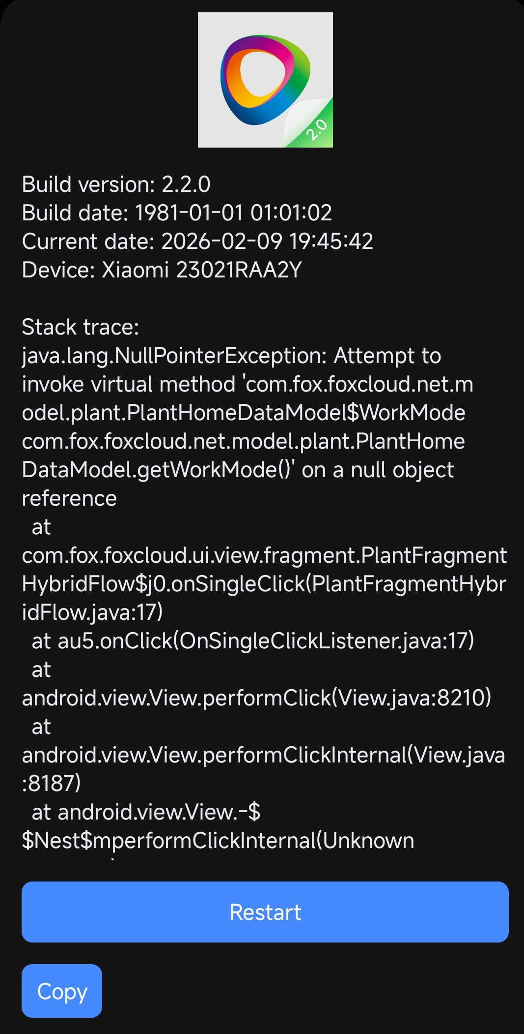

When I went into work mode I got the following error, after the reset it worked normally. :

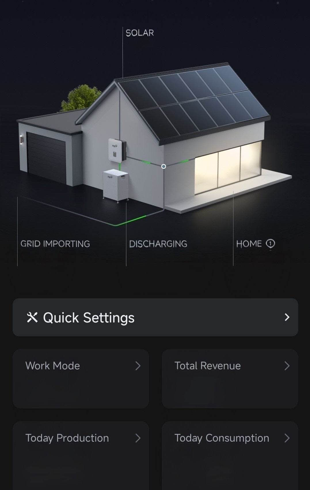

I tried to repeat the errors, and the error occurs if there are no sub-data yet. So the data loading is too slow. By clicking on the Work mode icon, when there was no data yet, the error appeared. I am attaching a simulated image of how it was before the error.
