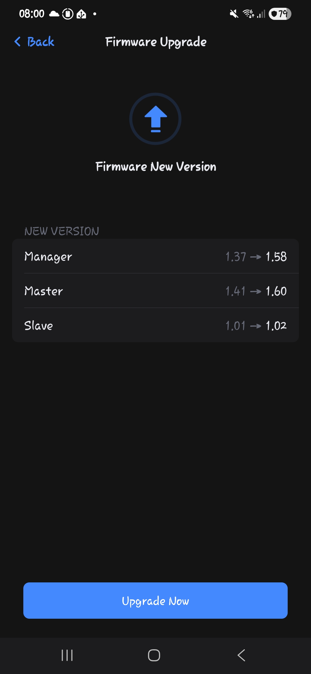

For timings, datalogger updated first at about 8:05, but does not show in the modbus logs. Inverter update process started around 8:10-8:15. So around 35-45 minutes in total.
Interestingly the app shows 1.02 as the new slave version, but modbus shows 1.01
https://fox-ess.tech/firmware-release-notes/
Code: Select all
13 February 2026
Inverter State changed to On Grid 08:46:03 - 32 minutes ago
Inverter State changed to Checking 08:44:38 - 34 minutes ago
Connection Status changed to Connected 08:44:32 - 34 minutes ago
Inverter State changed to Waiting 08:44:32 - 34 minutes ago
Version: Slave changed to 1.01 08:44:32 - 34 minutes ago
Version: Master changed to 1.60 08:44:32 - 34 minutes ago
Version: Manager changed to 1.58 08:44:32 - 34 minutes ago
Inverter State became unavailable 08:41:49 - 36 minutes ago
Version: Slave became unavailable 08:41:49 - 36 minutes ago
Version: Master became unavailable 08:41:49 - 36 minutes ago
Version: Manager became unavailable 08:41:49 - 36 minutes ago
Connection Status changed to Error reading registers. Type: RegisterType.HOLDING; start: 31000; count: 43; slave: 247 from tcp://192.168.68.200:502: Modbus Error: [Input/Output] No Response received from the remote slave/Unable to decode response 08:41:49 - 36 minutes ago
Inverter State changed to On Grid 08:37:03 - 41 minutes ago
Inverter State changed to Checking 08:35:43 - 42 minutes ago
Inverter State changed to Waiting 08:35:28 - 43 minutes ago
Connection Status changed to Connected 08:35:27 - 43 minutes ago
Inverter State changed to On Grid 08:35:27 - 43 minutes ago
Version: Slave changed to 1.01 08:35:27 - 43 minutes ago
Version: Master changed to 1.60 08:35:27 - 43 minutes ago
Version: Manager changed to 1.58 08:35:27 - 43 minutes ago
Inverter State became unavailable 08:34:54 - 43 minutes ago
Version: Slave became unavailable 08:34:54 - 43 minutes ago
Version: Master became unavailable 08:34:54 - 43 minutes ago
Version: Manager became unavailable 08:34:54 - 43 minutes ago
08:34:54 - 43 minutes ago Inverter State changed to On Grid
08:28:13 - 50 minutes ago Inverter State changed to Checking
08:26:48 - 51 minutes ago Inverter State changed to Waiting
08:26:43 - 51 minutes ago Inverter State became unknown
08:26:40 - 51 minutes ago 12 February 2026
Inverter State changed to On Grid 23:05:01 - 10 hours ago
Version: Slave changed to 1.01 23:05:01 - 10 hours ago
Version: Master changed to 1.41 23:05:01 - 10 hours ago
Version: Manager changed to 1.37 23:05:01 - 10 hours ago

Manager updated from 1.58 to 1.60
I checked at time of your post, no App update.
Drank some coffee and checked it 30 mins later and 2.2.1 landed.
