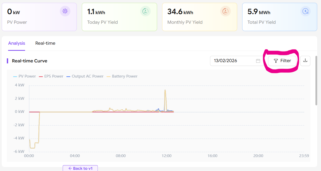

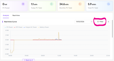

I don't know where I would see historic cell temp data. It was down between 0°C and 1°C last night which is where I have the heater set to turn on. But yeah, makes sense for it to be temp protection. I'll stop panicking every time it does something soon, I'm sure.
Login here with you credentials: https://www.foxesscloud.com/v2/logindatamonkey wrote: ↑Fri Feb 13, 2026 12:14 pm I don't know where I would see historic cell temp data. It was down between 0°C and 1°C last night which is where I have the heater set to turn on. But yeah, makes sense for it to be temp protection. I'll stop panicking every time it does something soon, I'm sure.
Devices
Battery, and open it. Click on the Filter, and scroll to very bottom right and tick "Min. Cell Temp. (°C)" press Confirm

I don't seem to have the Filter buttons on any of the battery graphs. But I found it on the Inverter Graph.
Min Cell Temp was 3C and that's the first time it's got that low. It charged until min Cell temp was 5C. So Temp protection seems likely
It can come and go as Fox decidedatamonkey wrote: ↑Fri Feb 13, 2026 1:10 pm I don't seem to have the Filter buttons on any of the battery graphs. But I found it on the Inverter Graph.
