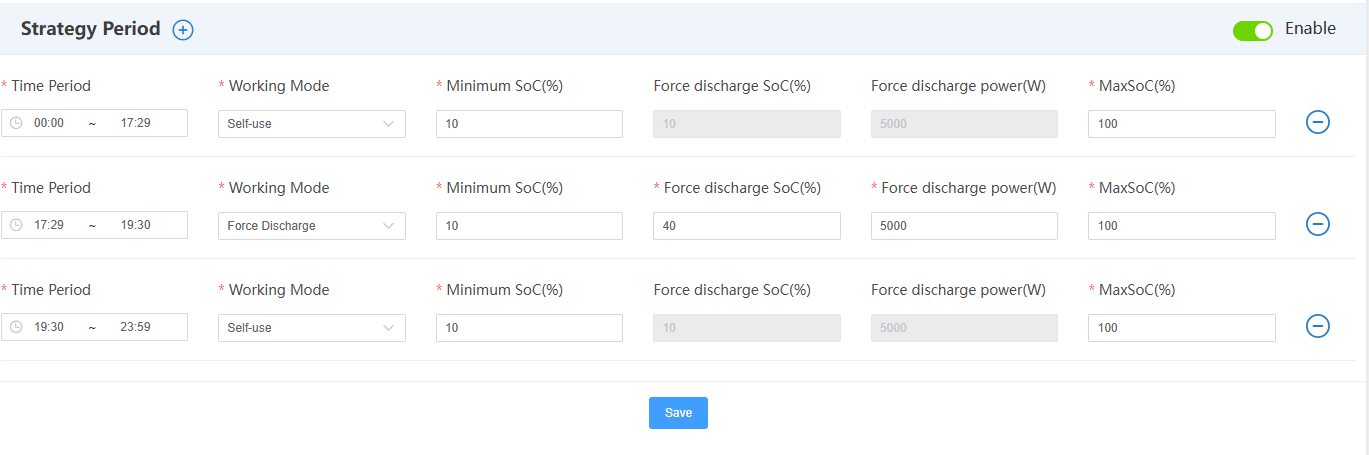

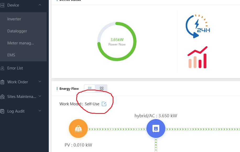

Now log into the V1 web interface, then click on Device>Inverter>Operation. The screen (pic 1) will come up. Then click on the icon circled in red.
The screen shown in pic 2 will appear. You will see a Self Use Mode running from 00:00 to 23:59. It will most likely have the spurious SoC in it, and you can't edit it. Delete it with the - icon.
Then add two new activities. One starting at 00:00 and ending when your first one start, and the second when your activity finishes and running to 23:59
Select Forced Discharge as the mode and change the FD SoC and FD power to your system settings.
The change the work mode to Self Use. These two will now grey out.
Hit Save, and then go back into the app to check that are the same.
This is not possible in the app as the FD values are not accessible with the Self Use mode.

Pic 1 -
Pic 2 -
