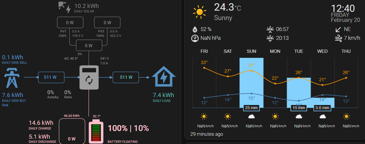

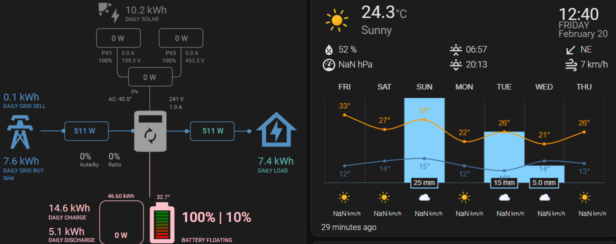

DC coupling:
it seem sin 'force charge' mode, when battery is full, it would still use grid and turn off the solar...
what is the correct approach so that when full we still use solar for home load or export anyway?
