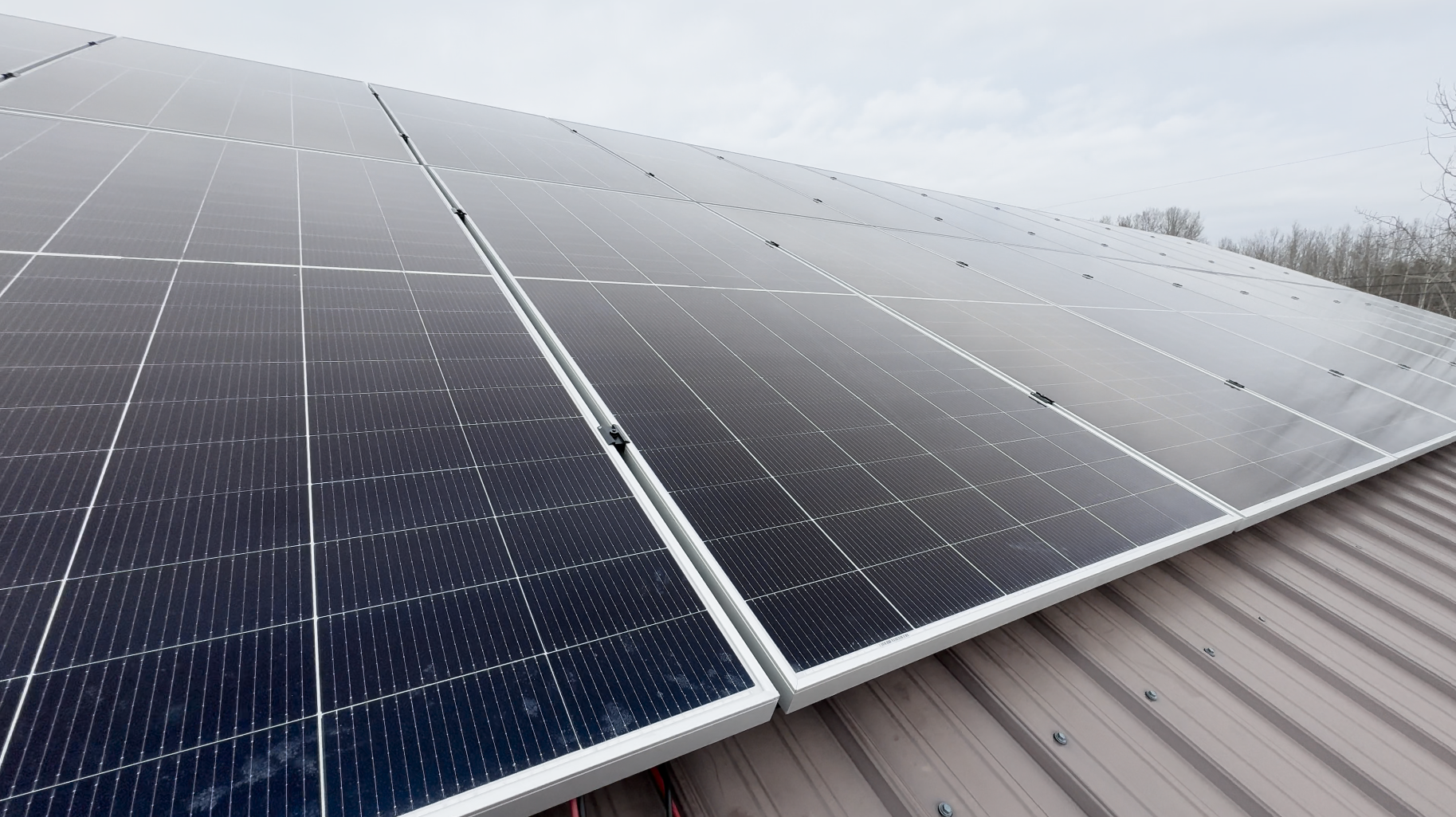

New System 17kW Grid Tied 4strings X 7 panels/string X 620w
Well, its been a long time coming but I finally got this system on the roof, installed, inspected and in the process of commissioning. (Having some problems with that part...)
This was a DIY project and its been rewarding to see it all come together
4 strings of 7 Panels each @ 620W (17kW) Canadian Solar TopBiHiKu6
Voc - 48.4V, Isc - 16.08A Vmp - 41.2V Imp - 15.06A Southish facing on Shop Roof
AP Smart RSD-S-PLC Fox H1-11.4-US Hybrid Inverter, Grid Tied, No batteries
200A Service Rural, DIY
