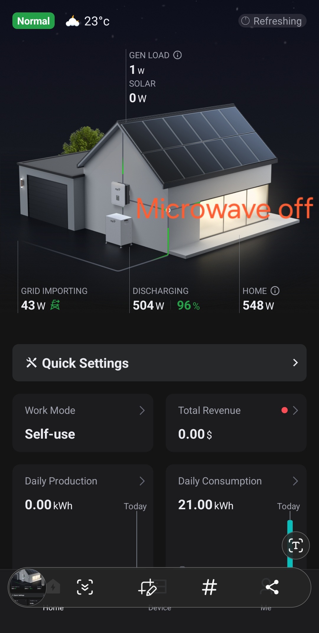

Yes, I suspect something is detecting one of the phases backwards, given these two grabs, first at night with not much running, 548W being used in the whole house:

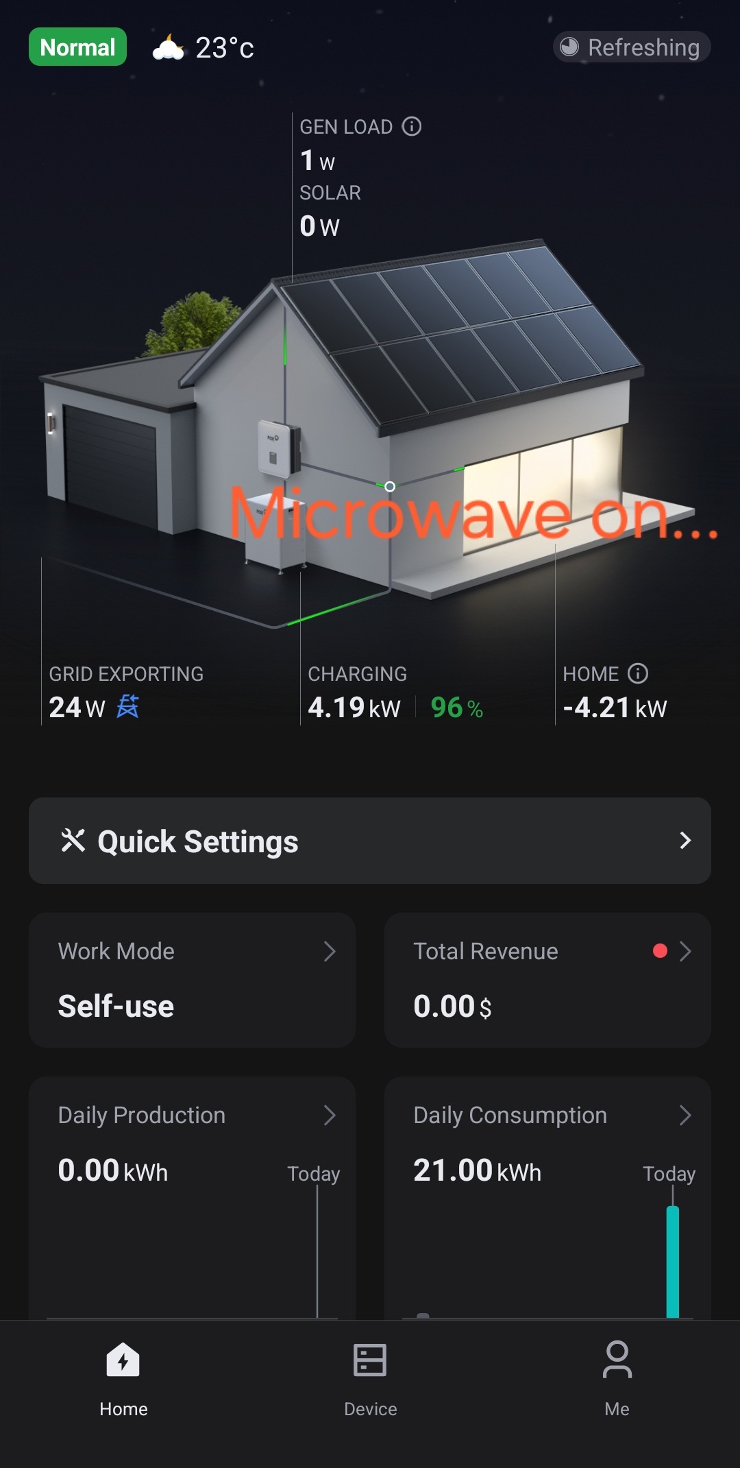

and then if i turn the microwave on:
you can see it looks like the microwave is providing power - i wish it was! But I'm actually pulling power from the grid instead, plus there's no way my microwave is using 3.7+kW, i.e., the off-set of the previous 500W and -4.21kW, I think it's 1.2kW model, if that.
Can Fox look to see what is wrong here remotely, or do I need my installers to physically return to correct this, do you reckon?
