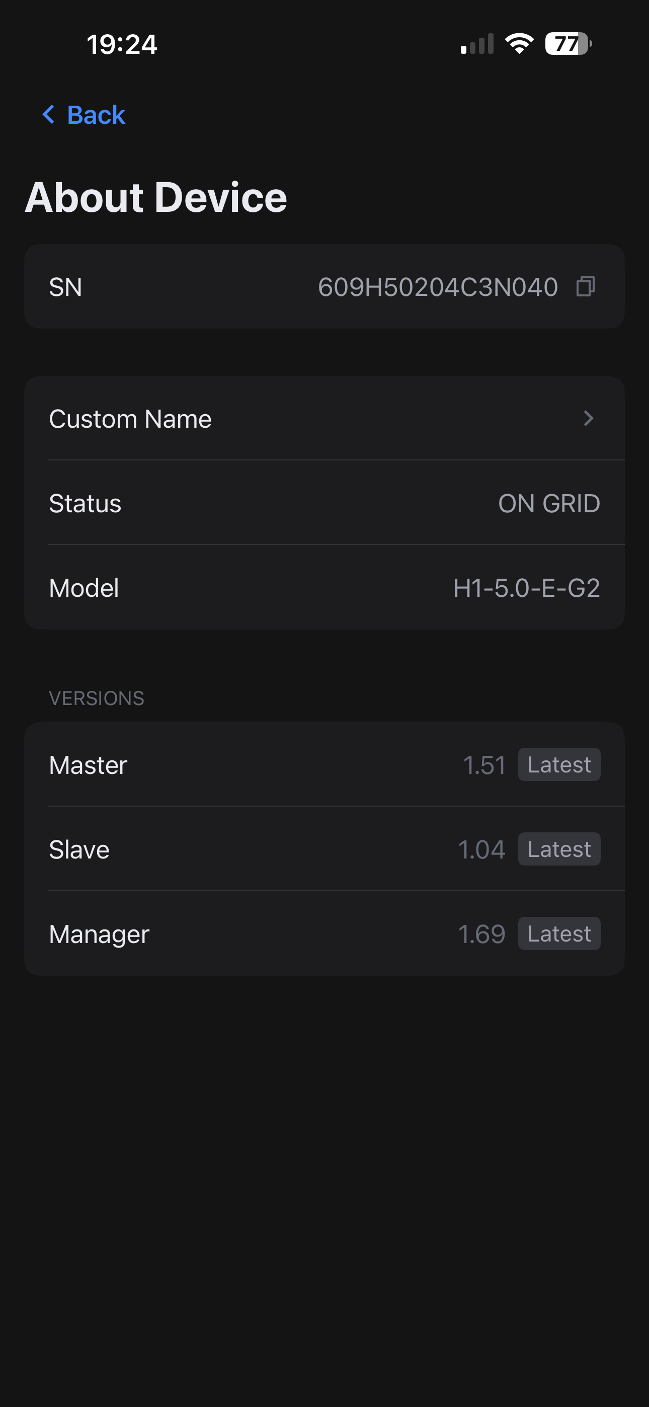

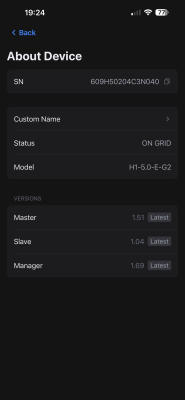

New to the forum but have a query, I have been running my system for over 6 months but just recently updated some firmware settings. Started seeing a problem that the batteries wouldn’t fully charge whilst charging my EV (TESLA) however charged a second EV (Cupra Born) had no issues (I suspect due to smaller EV battery size), I am after some help or advice as to the problem as I also run a heat pump so quite a heavy load but only seems to be an issue on TESLA charge
